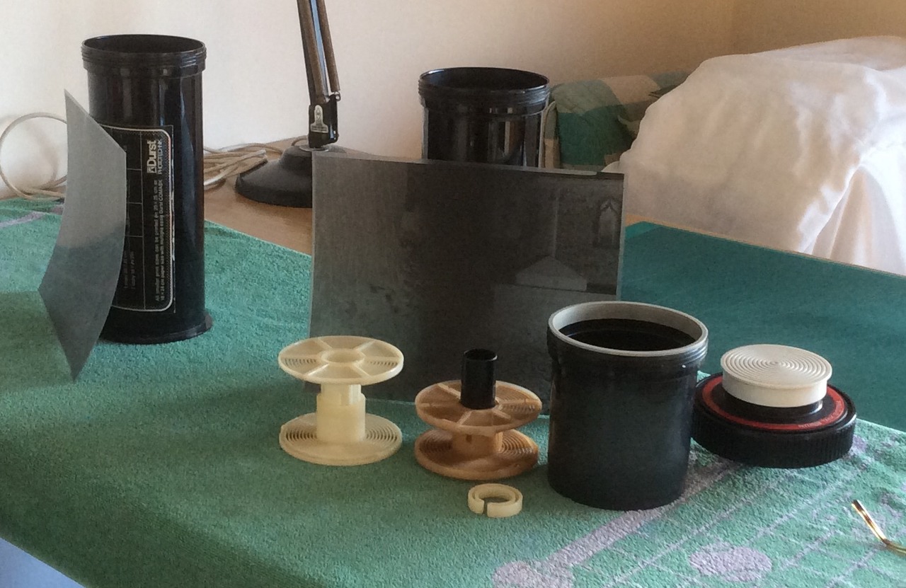

jpattison Posted December 24, 2015 Share #15  Posted December 24, 2015 (edited) Why not try a Jobo 1501 reel, in the small tank 1520 that you can use by inversion, just like the Paterson. There are no ball bearings. You just use small alternate hand twists. You can fit two reels in a 1520.   http://www.firstcall-photographic.co.uk/jobo-developing-tank-1501-reel/p760  The tank is shown on that page also.  This might help... http://www.jobo-usa.com/images/manuals/Loading_roll_film.pdf  and this guys good at it... not recommended to pull the film out of the can like this though! The second version shows the hand twist method.   John Edited December 24, 2015 by jpattison Link to post Share on other sites More sharing options...
