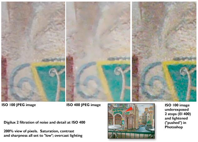

adan Posted September 7, 2015 Share #9 Posted September 7, 2015 An aside on dpitt's technique. This is exactly what the camera is doing anyway, whenever you use an ISO above the base setting. A image sensor is a pretty simple device - it takes in photons of light and spits out electrons in proportion. The electrons are counted to determine how bright the picture should be. That proportion is fixed. When you crank up the ISO, the sensor does not spit out more electrons. It does not change its sensitivity. Shoot at ISO 640, and you feed the sensor 1/4 as many photons as at ISO 160, and the flow of electrons is also 1/4 what it would be at ISO 160. The camera's other electronics simply count the electrons and multiply by 4 to produce an ISO 640 picture (or by 8 to get an ISO 1250 picture). If there are spurious electrons spit out by the sensor due to cosmic rays, heat in the electronics, or random quantum events, that spurious data is the "noise" and gets multiplied along with the real data. 1x, 4x, 8x. But it doesn't matter whether the camera does the multiplying, or you do it on the computer afterwards. I used the same idea with the Digilux 2 - which insisted on "smoothing" the noise at any ISO set above 100 (in jpegs) and smeared a lot of detail. If I needed 400 for given light, I underexposed 2 stops at ISO 100 and brought the picture brightness up in the computer. http://www.xstonepictures.com/images/100_400_wall.jpg Anyway - back to low-light shooting in general, and incandescent light in particular. Under yellow incandescent light, an RGB color sensor is "blind" in the blue pixels - 1/4 of your picture. This picture shows what your camera "sees" under warm light (in this case, candles - M9, 35 f/1.4, ISO 2000) Full-color at top left, with what is recorded by each color channel. Welcome, dear visitor! As registered member you'd see an image here… Simply register for free here – We are always happy to welcome new members! The blue channel is nearly all black (bottom right). With that much data missing, there's not much you can do. If you try to white-balance it (increase the presence of blue) you are essentially pushing the blue pixels 4-5 times as much as the picture overall (so ISO 500 exposure gets you effectively ISO 25,000 noise in the blue channel) to dig anything out of all that blackness. You could use a bluish color-balancing filter, as was used in the film days. But that just blocks red and green light, to give the blue pixels an equal chance - so you have to crank up the overall exposure by 2 stops (ISO 500 goes to ISO 2000). You could just leave the color balance alone and live with the "natural" yellow color of the light. You can get a Monochrom - which eliminates the light loss of the colored sensor filters (but also the color). Or you can use flash, which is daylight/sunlight-balanced, and thus produces blue light in roughly equal proportions to red and green. Not only brighter and faster (electronic flash pulse is 1/1000 - 1/10,000 second) - but all the channels get light. As W. Eugene Smith once said - "Available light means any light that's available - including what's in my camera bag." Link to post Share on other sites Simply register for free here – We are always happy to welcome new members! The blue channel is nearly all black (bottom right). With that much data missing, there's not much you can do. If you try to white-balance it (increase the presence of blue) you are essentially pushing the blue pixels 4-5 times as much as the picture overall (so ISO 500 exposure gets you effectively ISO 25,000 noise in the blue channel) to dig anything out of all that blackness. You could use a bluish color-balancing filter, as was used in the film days. But that just blocks red and green light, to give the blue pixels an equal chance - so you have to crank up the overall exposure by 2 stops (ISO 500 goes to ISO 2000). You could just leave the color balance alone and live with the "natural" yellow color of the light. You can get a Monochrom - which eliminates the light loss of the colored sensor filters (but also the color). Or you can use flash, which is daylight/sunlight-balanced, and thus produces blue light in roughly equal proportions to red and green. Not only brighter and faster (electronic flash pulse is 1/1000 - 1/10,000 second) - but all the channels get light. As W. Eugene Smith once said - "Available light means any light that's available - including what's in my camera bag." ' data-webShareUrl='https://www.l-camera-forum.com/topic/249763-low-light-suggestions/?do=findComment&comment=2883736'>More sharing options...
