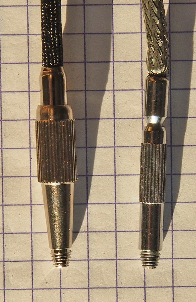

wlaidlaw Posted August 26, 2013 Author Share #70 Posted August 26, 2013 I can confirm that the Nikon AR-3 works well on the M240, screwing in about 2 turns, sitting squarely and fires the shutter off nicely. The taper tip thread is slightly better finished than my Leica one. The only very slight downside is that it is cloth covered rather than metal mesh. It has a bulb lock on it just like the Leica cable but similar to the Leica one, you would have to push the release button on the cable further than the shutter release will permit, in order for the latch to lock. Nikon Cable is on the left and you can see that the small end of the taper appears to be slightly smaller. Whatever the apparent difference, the Nikon cable works, the Leica one doesn't. Wilson Welcome, dear visitor! As registered member you'd see an image here… Simply register for free here – We are always happy to welcome new members! 2 Quote Link to post Share on other sites Simply register for free here – We are always happy to welcome new members! ' data-webShareUrl='https://www.l-camera-forum.com/topic/201607-remote-cable-release-for-m240-has-leica-modified-their-standard-one/?do=findComment&comment=2405959'>More sharing options...

algrove Posted August 26, 2013 Share #72 Posted August 26, 2013 Glad you found an old one that works. Does the Nikon end seem to be of higher quality than the newer Leica one? I found the very end of the Leica and /or Hama newer ones just don't hack it anymore. Quote Link to post Share on other sites More sharing options...
wlaidlaw Posted August 26, 2013 Author Share #73 Posted August 26, 2013 Lou, The thread on the Nikon looks machined rather than pressed like the Hama one. Wilson 1 Quote Link to post Share on other sites More sharing options...
Gibbo Posted August 26, 2013 Share #74 Posted August 26, 2013 The peaks on the threads of the Nikon one appear much sharper than the Leica. Quote Link to post Share on other sites More sharing options...
wlaidlaw Posted August 26, 2013 Author Share #75 Posted August 26, 2013 The peaks on the threads of the Nikon one appear much sharperthan the Leica. That's certainly my impression. Well at least we now have a solution to the cable release issue and at considerably less than the Leica one, which may or may not work. My new Nikon cable cost £14 plus £2 P&P to France from the UK. Wilson Quote Link to post Share on other sites More sharing options...
