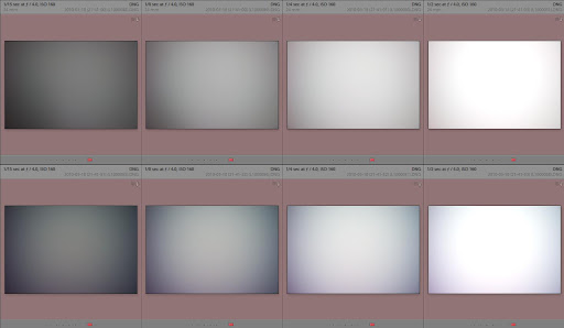

Jerry_R Posted March 18, 2010 Share #285 Posted March 18, 2010 M9 + 24mm f/3.8 @3.8 on firmware 1.116 TOP: coded BOTTOM: uncoded Link to post Share on other sites More sharing options...

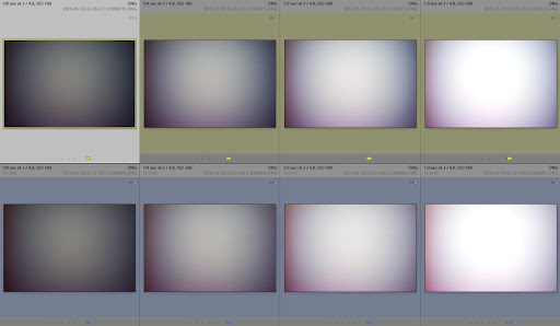

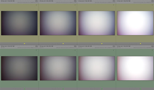

Jerry_R Posted March 18, 2010 Share #286 Posted March 18, 2010 Only FYI, I do not ask Leica to solve Voigtlanders. M9 + CV 15mm @4.5 on firmware 1.116 TOP: uncoded BOTTOM: coded as 28mm f/2 ASPH M9 + CV 15mm @4.5 on firmware 1.116 TOP: uncoded BOTTOM: coded as WATE @16mm Link to post Share on other sites More sharing options...

Alnitak Posted March 18, 2010 Share #288 Posted March 18, 2010 Jerry, Have you tried using the 21/2.8 11134 coding on the M9 for the CV 15? I tried nearly every possible setting and found that one gave by far the best correction. Others have found the same. If you haven't, I'd suggest you try it out. Jeff Link to post Share on other sites More sharing options...
meino Posted March 18, 2010 Share #289 Posted March 18, 2010 Jerry, Have you tried using the 21/2.8 11134 coding on the M9 for the CV 15? I tried nearly every possible setting and found that one gave by far the best correction. Others have found the same. If you haven't, I'd suggest you try it out. Jeff That is also the best setting for the Zeiss 18mm Distagon. Link to post Share on other sites More sharing options...
Alnitak Posted March 18, 2010 Share #290 Posted March 18, 2010 That is also the best setting for the Zeiss 18mm Distagon. And the Voigtlander 12mm, while we are pointing things out. Jeff Link to post Share on other sites More sharing options...

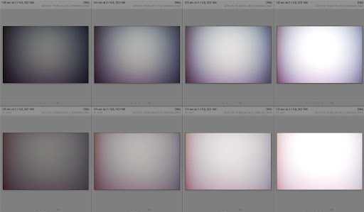

Jerry_R Posted March 18, 2010 Share #293 Posted March 18, 2010 One more try then ;-) M9 + CV 15mm @4.5 on firmware 1.116 TOP: uncoded BOTTOM: coded as 21mm f/2.8 (1134) Link to post Share on other sites More sharing options...
Alnitak Posted March 18, 2010 Share #294 Posted March 18, 2010 One more try then ;-) M9 + CV 15mm @4.5 on firmware 1.116 TOP: uncoded BOTTOM: coded as 21mm f/2.8 (1134) Now we're talking! At least to my eyes, this is the best correction. I used to use this as a starting point for CornerFix. Then I got the WATE, which in my case has no red edge at all, and the CV was sold. Which is a shame, as it was such a compact lens, and so sharp--a tiny bit sharper than the WATE. Jeff Link to post Share on other sites More sharing options...
UliWer Posted March 18, 2010 Share #295 Posted March 18, 2010 Thank you, Jerry, for your instructive examples. Besides the question of best coding they show most clearly that light seems to be the best remedy against the red shift. So one should take as a rule with a "suspicious" lens to avoid underexposure in the critical zones. Link to post Share on other sites More sharing options...
Jerry_R Posted March 19, 2010 Share #296 Posted March 19, 2010 Thank you Jeff & UliWe! Yes, coding as [1134] is indeed best option! Best compromise I think! What is interesting: I have finally learned how to correct red corner issue for 15mm in LR (without coding). There is no one fits all preset, but just few. But coding as [1134] gives more warm results, what is nice in most cases for me. I need to compare no coding vs 21mm coding outside and most probably I will stay with that. Or replace 15mm with new 12mm - one day. After all these tests I understand you Jeff ;-) My patience is almost finished.I have enough of white walls, etc. I want to spend time on photographing, not testing ;-) PS: Exactly UliWer, correct exposure is important. Even more, as underexposing increases noise, and overexposing can quickly burn highlights. Need to be careful. Link to post Share on other sites More sharing options...
