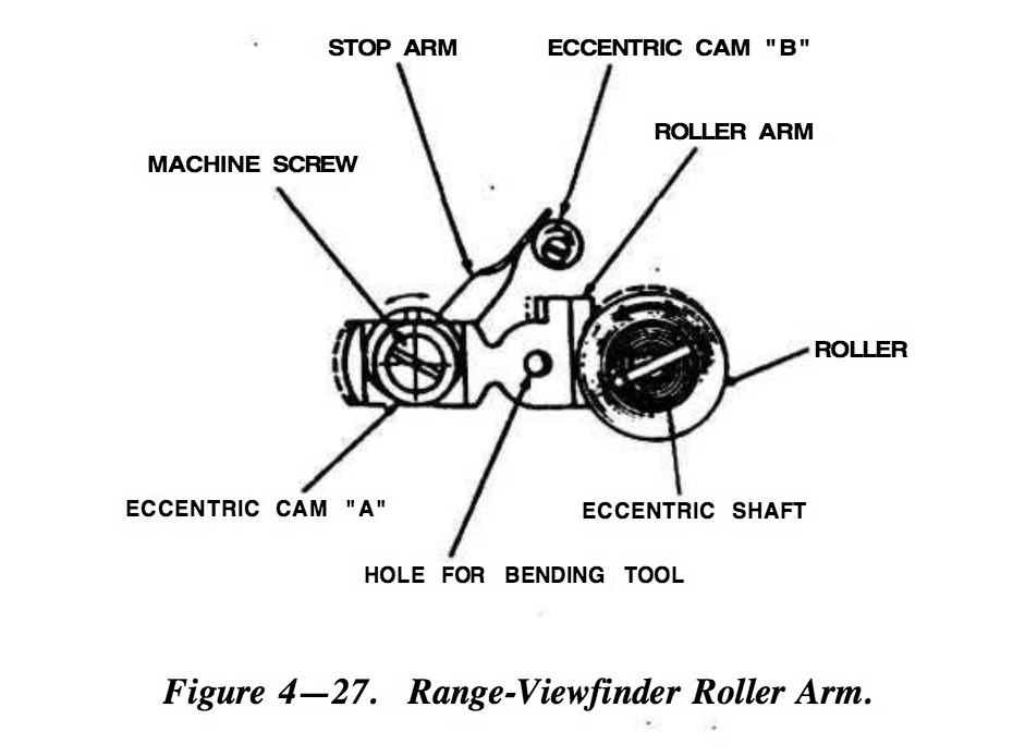

rapids41 Posted November 21, 2015 Share #223 Posted November 21, 2015 (edited) Hi again, my M9-P just came back from Leica with a new sensor after 2 month. Unfortunately the rangefinder is off now. The problem is at close distance the rangfinder window does not start moving directly when focusing. So I think the problem is the stop arm, which stops to early: Someone has ever fixed this issue? Can I not simply rotate the eccentric cam B? Please no advices to sent it back to Leica again, I will fix as much as I can on my own, thanks. Edited November 21, 2015 by rapids41 Link to post Share on other sites More sharing options...
rapids41 Posted November 21, 2015 Share #224 Posted November 21, 2015 Just managed to bent the stop arm. Very easy and now everything is perfect again. Link to post Share on other sites More sharing options...

jaapv Posted June 13, 2016 Share #227 Posted June 13, 2016 Advertisement (gone after registration) Just managed to bent the stop arm. Very easy and now everything is perfect again. Not a good idea. Bending the arm is meant for (very rarely) midrange adjustment. Link to post Share on other sites More sharing options...

M11 for me Posted July 13, 2017 Share #232 Posted July 13, 2017 I just shot quickly a makro and I see now that I was only half right. The wheel is made for an allen wrench after all. I did not see this when I just looked without magnification. On the other hand the left screw's construction has definitely changed and a normal screwdriver does not fit anymore. Further there is that lacquer applied . . . Welcome, dear visitor! As registered member you'd see an image here… Simply register for free here – We are always happy to welcome new members! 1 1 Link to post Share on other sites Simply register for free here – We are always happy to welcome new members! ' data-webShareUrl='https://www.l-camera-forum.com/topic/118043-m9-coincidence-at-infinity/?do=findComment&comment=3315264'>More sharing options...
pico Posted July 13, 2017 Share #233 Posted July 13, 2017 (edited) There is no rationale for that fastener head other than to discourage user maintenance. I would dissolve the adhesive (possibly Loctite's 'post fastening' fluid), and try a good gunsmith's screwdriver on a right-angle ratchet. It has a single rather than flat X type blade, but if you muck up one, there's the other. Gunsmith screwdrivers are special because they have various blade thicknesses, and proper thickness fit is critical in screw fasteners. You want to fill the slot. This the set I use. Google Chapman tools. Edited July 13, 2017 by pico Link to post Share on other sites More sharing options...
Rus Posted July 13, 2017 Share #234 Posted July 13, 2017 Thanks for the photo Alex. Glad to see that the wheel is still controlled by the allen key. With regard to the eccentric screw being "locked" by glue, I actually wonder if this makes the RF mechanism more robust -- provided that it has been properly calibrated to the standard, of course -- since there is now only one moving part that is likely to slightly shift position through long-term use. Link to post Share on other sites More sharing options...
jaapv Posted July 13, 2017 Share #235 Posted July 13, 2017 There is no rationale for that fastener head other than to discourage user maintenance. I would dissolve the adhesive (possibly Loctite's 'post fastening' fluid), and try a good gunsmith's screwdriver on a right-angle ratchet. It has a single rather than flat X type blade, but if you muck up one, there's the other. Gunsmith screwdrivers are special because they have various blade thicknesses, and proper thickness fit is critical in screw fasteners. You want to fill the slot. This the set I use. Google Chapman tools. Acetone in miniscule quantities will do the trick. It will reset after evaporation. Adjusting the screw will mainly affect close focus, as opposed the eccentric in the roller wheel which is meant for infinity adjustment. Usually that is all you need. Link to post Share on other sites More sharing options...
jdlaing Posted July 13, 2017 Share #236 Posted July 13, 2017 Thanks for the photo Alex. Glad to see that the wheel is still controlled by the allen key. With regard to the eccentric screw being "locked" by glue, I actually wonder if this makes the RF mechanism more robust -- provided that it has been properly calibrated to the standard, of course -- since there is now only one moving part that is likely to slightly shift position through long-term use. See that cam lever? It rotates on the axis of that screw. It would loosen over time with constant turning. Loctite is not good on the screw threads as it is meant to be adjusted. The spot of lacquer just locks it in place from loosening while still being able to be set free for adjustments. 1 Link to post Share on other sites More sharing options...
pico Posted July 13, 2017 Share #237 Posted July 13, 2017 Glad to see that the wheel is still controlled by the allen key. Is it? Really? Link to post Share on other sites More sharing options...
jdlaing Posted July 13, 2017 Share #238 Posted July 13, 2017 Is it? Really? Yes. Really. 2 Link to post Share on other sites More sharing options...
chlky0001 Posted August 12, 2017 Share #239 Posted August 12, 2017 I just shot quickly a makro and I see now that I was only half right. The wheel is made for an allen wrench after all. I did not see this when I just looked without magnification. On the other hand the left screw's construction has definitely changed and a normal screwdriver does not fit anymore. Further there is that lacquer applied . . . M262 has the same coupling set up, I adjusted the wheel with allen key while turned the screw and arm (didn't see the glue initially). the focus is spot on now. Link to post Share on other sites More sharing options...
gippo Posted November 7, 2017 Share #240 Posted November 7, 2017 Acetone in miniscule quantities will do the trick. It will reset after evaporation. Adjusting the screw will mainly affect close focus, as opposed the eccentric in the roller wheel which is meant for infinity adjustment. Usually that is all you need. Excuse me a question: acetone for nail polish (woman) okay? thank you Link to post Share on other sites More sharing options...
