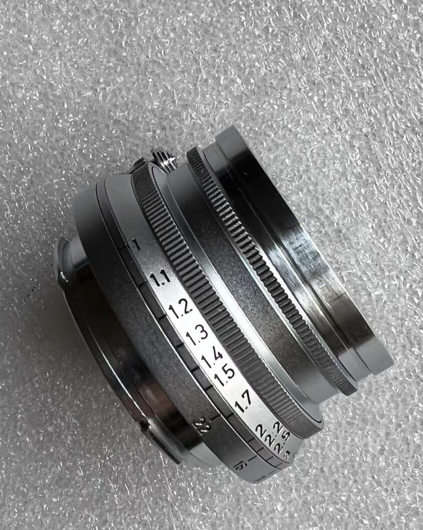

dannh Posted March 8, 2015 Share #69 Â Posted March 8, 2015 Anyone able to confirm which version this is? A neighbor recently passed away who I had no idea was into Leica. Mostly R stuff, but this lens was among his gear. The lens is an F3.5 Summaron, bayonet mount. Serial Number is 1308750 which looks like a 1955 model according to the wiki. Â It doesn't look like any of the others pictured in this thread. Might it ever had been paired with goggles? Â Link to post Share on other sites More sharing options...
gyoung Posted March 8, 2015 Share #70 Â Posted March 8, 2015 Looks like my ltm version, its got a screw to bayonet adapter on the back and what looks like a filter holder with no glass on the front. Â Gerry 1 Link to post Share on other sites More sharing options...
dannh Posted March 8, 2015 Share #71 Â Posted March 8, 2015 Gerry I think you're right. The filter holder threw me off. I think he was using it to "step up" to the more common cap size. I thought it might be the LTM version but without the expertise, didn't want to unscrew anything to find out. I appreciate the help! Link to post Share on other sites More sharing options...
HensleyC Posted July 27, 2023 Share #72  Posted July 27, 2023 (edited) On 2/5/2010 at 4:18 PM, hookonclassic said: Hmm...interesting findings, didn't know variation of 35mm Summaron until coming across this thread.  I think this is the original M2 mount version discussed earlier...the DOF scale is tapered...there is a "2" marking on the M mount recessed catch, no idea on this marking...from the serial no....year 1958...amazing condition for a over 50yrs old lens ...  http://farm3.static.flickr.com/2802/4331939798_72e02cb5f3.jpg  http://farm3.static.flickr.com/2774/4331201417_ee15573a87.jpg  http://farm5.static.flickr.com/4006/4331939322_5c2a5e8ddc.jpg  A beautiful little chrome classic... Hi! I just purchased a Summaron 3.5 that I believe to be the true M2 version. Mine has a protruding red dot though. Is that supposed to be there? The lens in the pictures posted by hookonclassic has a recessed red dot?? Welcome, dear visitor! As registered member you'd see an image here… Simply register for free here – We are always happy to welcome new members! Edited July 27, 2023 by HensleyC Link to post Share on other sites Simply register for free here – We are always happy to welcome new members! ' data-webShareUrl='https://www.l-camera-forum.com/topic/44776-summaron-m-35mm-f35-for-m2/?do=findComment&comment=4822852'>More sharing options...
jaapv Posted July 27, 2023 Share #73  Posted July 27, 2023 Your dot is correct and this is  the goggle-less version for the M2. The OP has an LTM version with the mount adapter attached Those adapters have a recessed red paint dot. 1 Link to post Share on other sites More sharing options...
HensleyC Posted July 27, 2023 Share #74  Posted July 27, 2023 1 hour ago, jaapv said: Your dot is correct and this is  the goggle-less version for the M2. The OP has an LTM version with the mount adapter attached Those adapters have a recessed red paint dot. Thank you! Happy to know that I found a nice copy of the M2. 😊 Link to post Share on other sites More sharing options...
