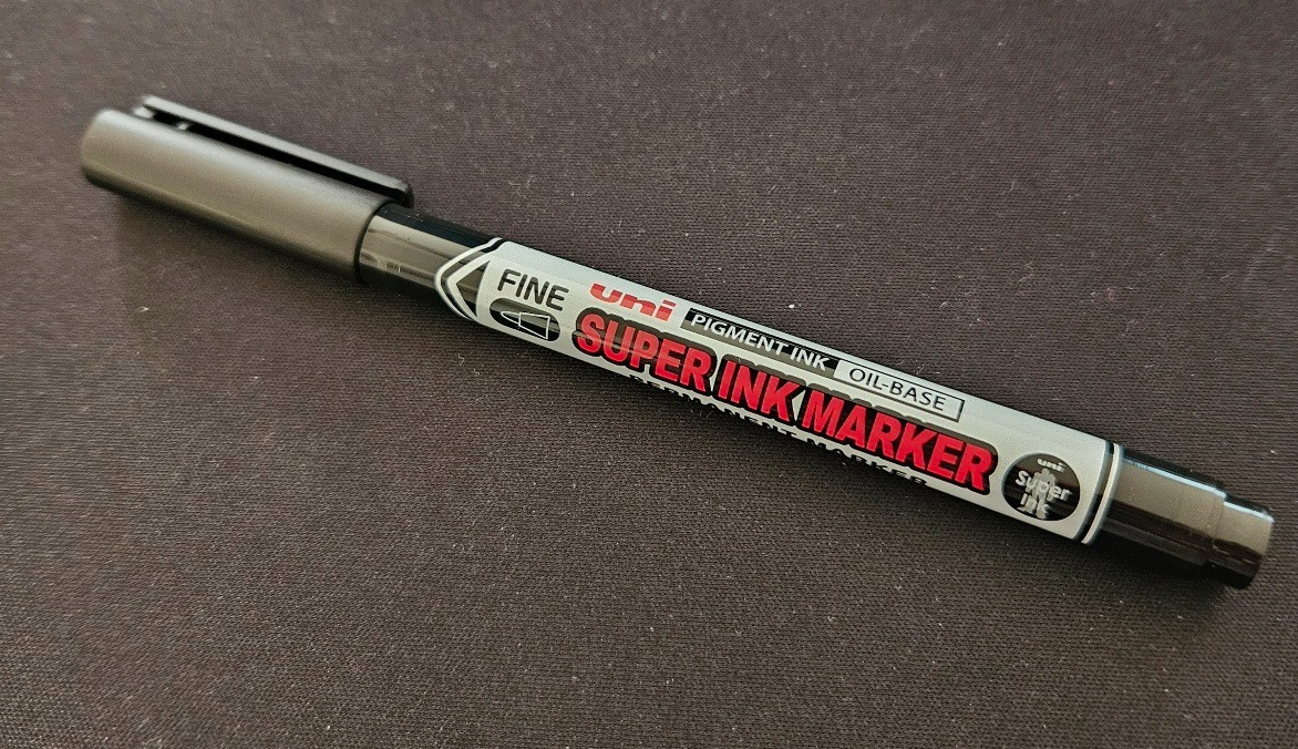

eaharman Posted 14 hours ago Share #1 Posted 14 hours ago (edited) Advertisement (gone after registration) I have numerous non-Leica lens that I regularly use on my M11P and have hand-coded successfully all but my most recent - a Voigtlander Heliar 15mm f4.5 behaves rather strangely - I have coded with a black indelible marker that lens as the nearest matching Leica equivalent - Tri-Elmar M 16-18-21mm f/4 however unlike my other non-Leica lens that I have similarly hand encoded - Voigtlander 50mm f2, 90mm f2 Zeiss Biogon T* 2.8/21 ZM From power on and pressing the menu it detects the lens as 4/16 however if I press the lens value on the touchscreen it shows the lens as Auto greyed out and it displays the lens as a manually added M lens type even though I have not enabled any manually coded lens in the camera and the following lens profiles show as enabled - 16-18-21/f4.0 ASPH @16mm 11626 and again @18mm variant & 21mm - all type 11626. If I change profile to the built-in default S then the lens is detected as a 21/2.8 & no manual lens profiles enabled, and changing back to my user profile re-enables the phantom manually added ones as above and the camera displays the lens correctly as 4/16. The above behaviour is repeatable by alternating between my user defined profiles and the default 'S' profile I have tried performing a factory reset choosing not to save any profile info, Fotos settings etc and the above bug/feature is reproduced upon power up... Further if I select either of my 2 user profiles with the lens showing as 4/16 but manually added if I then edit the list of enabled M lenses I find the Tri-Elmar is enabled, and if I disable that - i.e. no lenses are manually enabled, then the camera reports the lens as 4/16 manually added but none are manually enabled. If I then switch profiles to the default 'S' the lens is detected as 2.8/21 and again no manual lenses enabled, however if I then switch back to one of my two user profiles then the lens is detected as 4/16 and now the Tri-Elmar once again is enabled. Switching back to the default profile shows the lens as 2.8/21 and no manual lens enabled, and switching back to one of my user profiles once again shows the Tri-Elmar as being enabled....... TBH this is of little concern in my actual use-case in that aside from Fotos pairing etc I define and use only two profiles with custom settings - Profile 1 focus aid set to white, shutter type electronic, preview turned off Profile 2 as above but shutter type mechanical I use profile 1 day-to-day and Profile 2 is used sometimes when shooting under artificial LED lights some of which 'strobe' and can cause banding or when shooting fast moving action, or when using a flash TBH this looks to me like some sort of bug specific to profile management as opposed to actual camera functionality and for my purposes as long as the correct lens profile is stored in the EXIF data then I'm happy to live with it... If it's simpler I can post some annotated photos of the camera display which perhaps may better illustrate this bug. Has anyone else seen this bizarre behaviour? Edited 14 hours ago by eaharman Link to post Share on other sites More sharing options...

Thorfinn Posted 13 hours ago Share #4 Posted 13 hours ago The M-mount is 1950s design. The focal lengh group is transmittet mechanically to help the camera to show the correct frames. 70 years later it ist still done that way. That´s it. There are no electronic contacts, no communication, nothing. The Pro: There is no figurative trademark on the M-mount any more. It is a "open source" mount like m4/3. The 6bit code was introduced in 2006 as an add-on allowing 64 different codes: 6 photodiode read the 6 spots it they are black or white. It is electronics as we made it in the 70s. Of the 64 possible codes 53 are taken. When you change the lense or change the profile the reading is done This way you can e.g. have a set of manualle announced lenses for every profile (like "makro", "portraits", ...) Your "marker made" dots are ether not bright enough white og dark enough black to be read in high enough consitent of quality. Recessed milled dots filled with acrylic paint can help. But again: it is a feature not officially supported. Link to post Share on other sites More sharing options...

lct Posted 6 hours ago Share #9 Posted 6 hours ago There is no screw on the coding area of my Heliar 15/4.5 v2. It is pen coded as WATE (010000) and recorded in EXiF as "Tri-Elmar-M 1:4/16-18-21 ASPH" as expected. I suspect the black paint is not black enough or the location of the coding pit is not perfect. I would erase it and paint it again. Link to post Share on other sites More sharing options...
