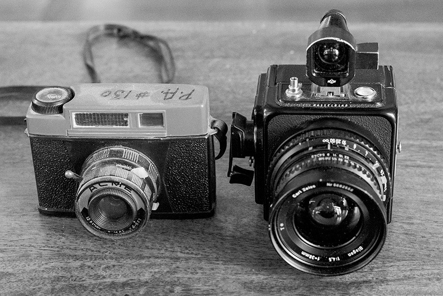

Olaf_ZG Posted yesterday at 01:16 PM Share #92 Posted yesterday at 01:16 PM On 9/26/2025 at 5:15 PM, adan said: Common newbie mistake - the Fuji X-Pro is NOT a rangefinder camera. Having a viewing window does not make a camera a rangefinder camera, any more than having windows in one's house turns it into a "rangefinder house." 🤪 Here are two more cameras with window viewing (but no rangefinders), just like the Fuji. From the opposite ends of the price spectrum. But they are not "rangefinder" cameras either. Welcome, dear visitor! As registered member you'd see an image here… Simply register for free here – We are always happy to welcome new members! Love that right one… Link to post Share on other sites More sharing options...
