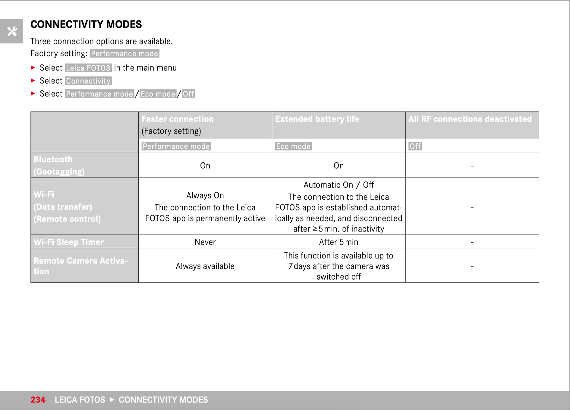

T25UFO Posted September 7 Share #7 Posted September 7 Advertisement (gone after registration) Set Leica Fotos to OFF. The default setting is Performance Mode and that drains the battery. 2 Link to post Share on other sites More sharing options...

Stephen_C Posted September 14 Share #11 Posted September 14 4 hours ago, Aram Langhans said: And if you leave it on overnight in a case when you pull it out it will be quite warm and have a dead battery. In my personal experience, the one absolutely key thing to stop that—and, generally, to extend battery life—is to ensure that Leica FOTOS connectivity is set to "Off”. Welcome, dear visitor! As registered member you'd see an image here… Simply register for free here – We are always happy to welcome new members! Stephen Link to post Share on other sites Simply register for free here – We are always happy to welcome new members! Stephen ' data-webShareUrl='https://www.l-camera-forum.com/topic/424124-leica-q3-battery/?do=findComment&comment=5863211'>More sharing options...
