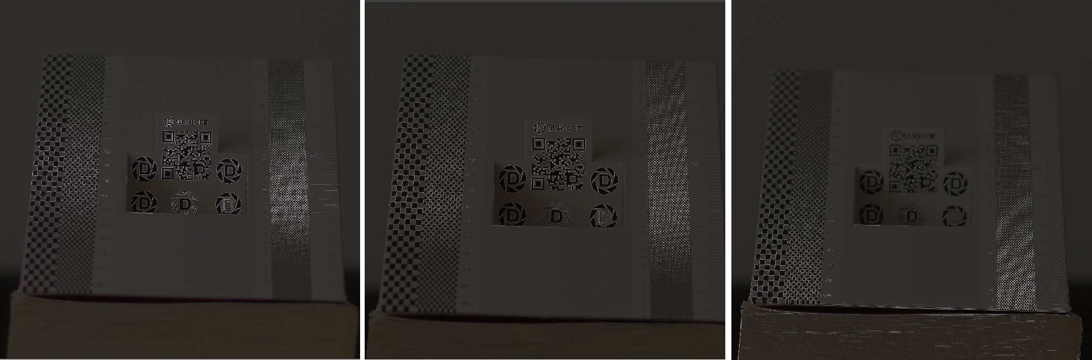

LeicaGuyUK Posted August 4 Share #1  Posted August 4 (edited) Advertisement (gone after registration) Hi, I have been struggling with a summarit 50 lately in regards to focussing. I`ve finally got around to testing it with a testing chart and I think it confirms it... First test was with a distagon 35mm 1.4 that i know is spot on, using the rangefinder or EVF on my M11 results in a good sharp shot. The Summarit looks to be ok via the EFV but when looking through the viewfinder its quite a bit off. Image 1 is the 35 distagon, image 2 is the summarit 50 via the EVF and image 3 is the summarit 50 via the rangefinder... Any thoughts? Its a quick and dirty test but i think it may conclude it? The lens was serviced via camserve here in the UK recently so it`s a shame if it is still out... Welcome, dear visitor! As registered member you'd see an image here… Simply register for free here – We are always happy to welcome new members! Edited August 4 by LeicaGuyUK Link to post Share on other sites Simply register for free here – We are always happy to welcome new members! ' data-webShareUrl='https://www.l-camera-forum.com/topic/423491-summarit-50mm-24-possible-front-focssing-issue/?do=findComment&comment=5843461'>More sharing options...

Carlos cruz Posted August 4 Share #4  Posted August 4 Looks like 10cm off to me.  If it still fits under ‘recently serviced’ category I would suggest they give it a second look Link to post Share on other sites More sharing options...
LeicaGuyUK Posted August 4 Author Share #5  Posted August 4 15 minutes ago, Carlos cruz said: Looks like 10cm off to me.  If it still fits under ‘recently serviced’ category I would suggest they give it a second look Yep that`s my thoughts also. I know it`s fairly obvious but wanted to rule my M11 out first so presume if EVF is good on this lens and EVF/RF is good on other lenses with the body I can rule the RF on the M11 out of the equazion Link to post Share on other sites More sharing options...
jgeenen Posted August 4 Share #6  Posted August 4 (edited) Looks off, but your setup seems not be perfectly leveled (the "D" below the QR code seems to be sharper in all images). Secondly, the 35mm reference image seems to be sightly front as well (could be caused by the leveling). Once your setup is perfectly leveled, do a series (never rely on a single photo): Take 10 photos with rangefinder wide open, all of them focusing individually coming from infinity. If all ten are equally off and in the same direction, a focussing misalignment is probable. Try to repeat the same series in portrait mode. Under normal circumstances with a test pattern you used there should be (a) a hit rate of at least 8 out of 10, and (b) the vertical test series should look similar.   Edited August 4 by jgeenen 1 Link to post Share on other sites More sharing options...
jankap Posted August 4 Share #7  Posted August 4 Advertisement (gone after registration) Welcome, dear visitor! As registered member you'd see an image here… Simply register for free here – We are always happy to welcome new members! Pictures 1, 2, and 3 from left to right. Link to post Share on other sites Simply register for free here – We are always happy to welcome new members! Pictures 1, 2, and 3 from left to right. ' data-webShareUrl='https://www.l-camera-forum.com/topic/423491-summarit-50mm-24-possible-front-focssing-issue/?do=findComment&comment=5843492'>More sharing options...
LeicaGuyUK Posted August 4 Author Share #8  Posted August 4 15 minutes ago, jankap said: Welcome, dear visitor! As registered member you'd see an image here… Simply register for free here – We are always happy to welcome new members! Pictures 1, 2, and 3 from left to right. I presume i can denote from that the Summarit 50 is way off and this is not an issue with the rangefinder itself? Link to post Share on other sites More sharing options...
LeicaGuyUK Posted August 4 Author Share #9  Posted August 4 38 minutes ago, jgeenen said: Looks off, but your setup seems not be perfectly leveled (the "D" below the QR code seems to be sharper in all images). Secondly, the 35mm reference image seems to be sightly front as well (could be caused by the leveling). Once your setup is perfectly leveled, do a series (never rely on a single photo): Take 10 photos with rangefinder wide open, all of them focusing individually coming from infinity. If all ten are equally off and in the same direction, a focussing misalignment is probable. Try to repeat the same series in portrait mode. Under normal circumstances with a test pattern you used there should be (a) a hit rate of at least 8 out of 10, and (b) the vertical test series should look similar.   Ah maybe!  I used the level on the body until all was green and assumed as the patch was hitting the middle of the barcode it would have been level. I think on this instance it`s not that i`m looking for perfection but to confirm if this lens is way off and at the moment un-usable with the RF.   Link to post Share on other sites More sharing options...
LeicaGuyUK Posted August 4 Author Share #10  Posted August 4 18 minutes ago, jankap said: Welcome, dear visitor! As registered member you'd see an image here… Simply register for free here – We are always happy to welcome new members! Pictures 1, 2, and 3 from left to right. Forgot to ask What did you do processing wise to display that? Link to post Share on other sites More sharing options...
jankap Posted August 4 Share #11  Posted August 4 1 hour ago, LeicaGuyUK said: Forgot to ask What did you do processing wise to display that? I use "FastRawViewer" on my Mac. You have to adjust somewhat. Then with the key "p" of the keyboard there are 3 views. I have made screen photos of your results. For the Distagon picture you write Rangefinder or LCD. The LCD always gives a sharp picture. The problem is the rangefinder, the parallel optical path. Leica has adjusted the Summarit for the rangefinder as it was new, but the technicians, who perform a CLA or make repairs, seldom have to do with rangefinders. New, with every Leica camera every Leica lens can be used via rangefinder coupling. Also the LTM lenses are very good with the adapter. The difference between M and LTM is 1.00 mm in flange distance. How many zeros I don´t know, tolerances.😀 1 Link to post Share on other sites More sharing options...

jankap Posted August 5 Share #13  Posted August 5 Do you remember, at what distance the Summarit was set at the second picture? If the M11 would be the issue, then the Distagon too!😉 Link to post Share on other sites More sharing options...
LeicaGuyUK Posted August 5 Author Share #14  Posted August 5 56 minutes ago, jankap said: Do you remember, at what distance the Summarit was set at the second picture? If the M11 would be the issue, then the Distagon too!😉 It was 2m away from the target. Sure, the distagon to me looks fine and also my ultron 28 II also seems to look ok via the RF so i think i can rule the RF itself out  1 Link to post Share on other sites More sharing options...
