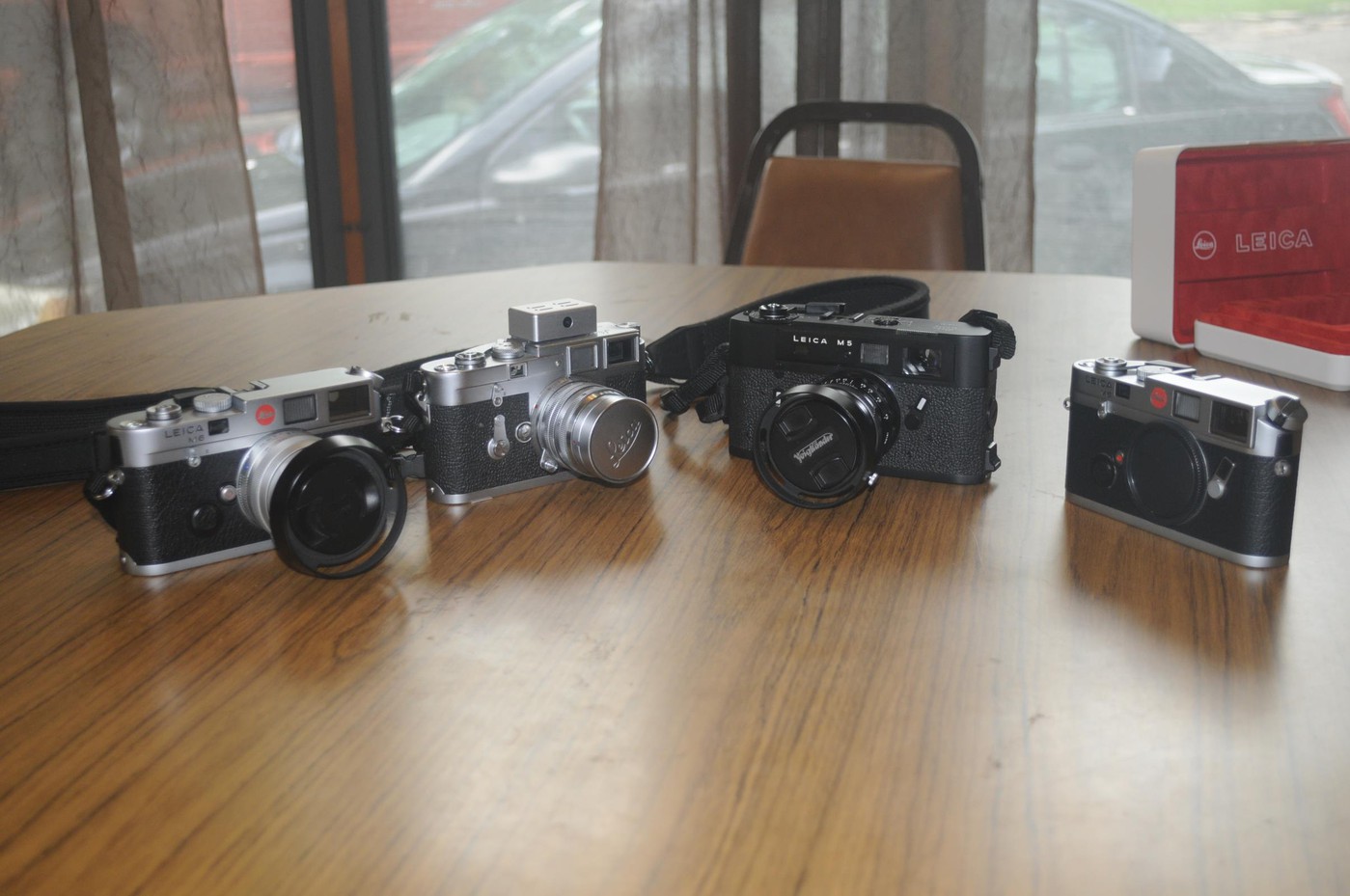

I bought first a used M3 in 1981, changed it quickly for a M2 (both 25-30 years old), which I sold to buy a new M9, replaced that with a M240, which was sold a few years ago with a digital M replacement. Since then I have acquired a nice used M4 (56 years old) from a forum member, and a new black paint MP (all the others, except the M9, were silver chrome).
I have not noticed any significant difference in apparent build quality in the hand, nor in use, after allowing for age. The MP does not scratch negatives.
Those are my facts. The rest of the decision making process is up to you🙂.
