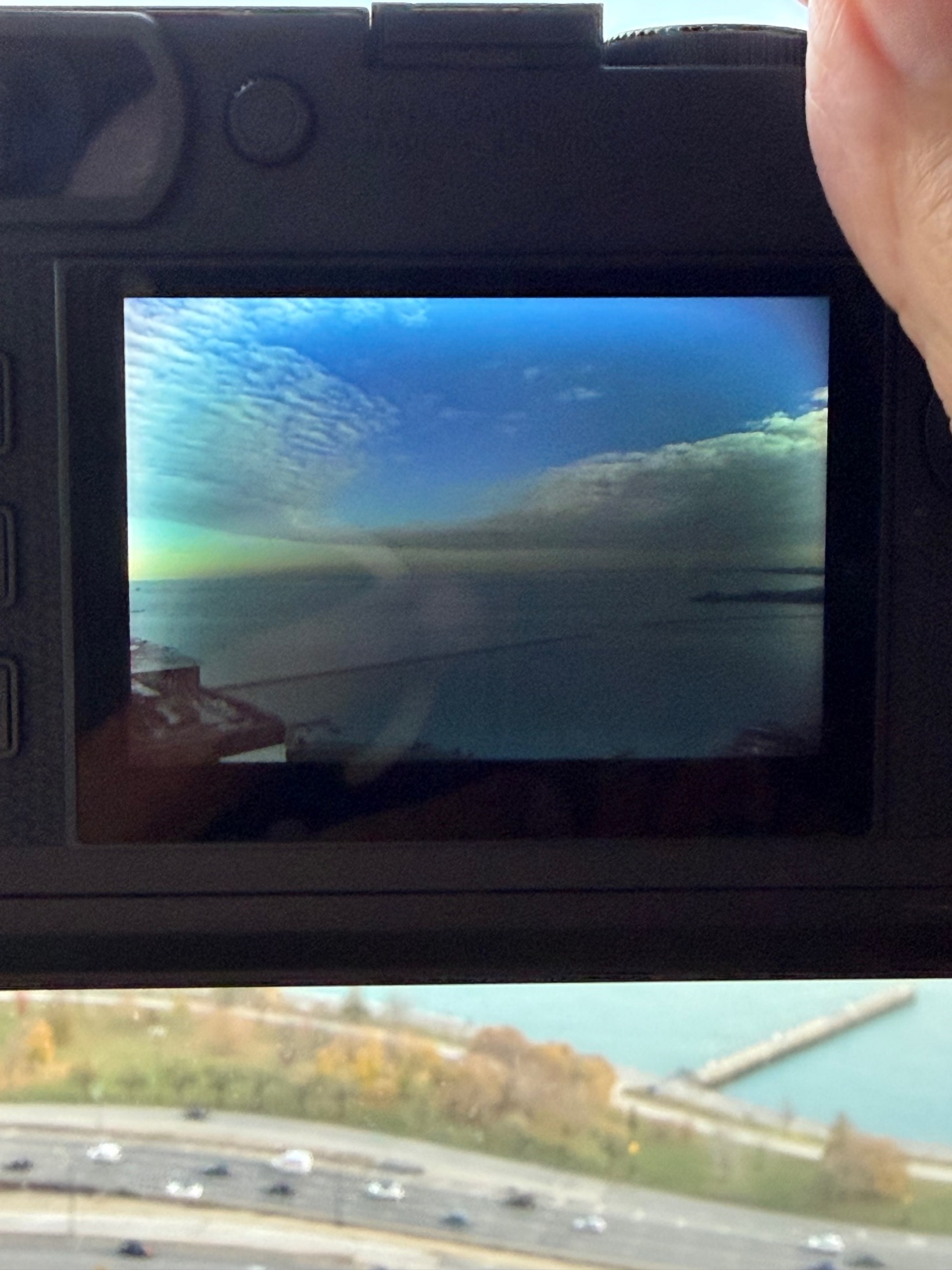

KenTanaka Posted December 19, 2023 Share #1 Posted December 19, 2023 Advertisement (gone after registration) My M11-P's rear screen seems to significantly darken from the center outwards after the camera's been on for 30+ minutes. By this I mean that the edges of the screen remain relatively bright while the inner 75+% darken to the point of being very unreliable. I've tried adjusting the screen brightness but to not avail. This -seems- to be most pronounced in colder weather. The battery is always at 80-85% when this phenomenon appears. Is anyone else having such trouble? 1 Link to post Share on other sites More sharing options...

Warton Posted December 19, 2023 Share #2 Posted December 19, 2023 I saw the similar phenomenon on my m11 in extremely cold weather last year about -20 C. But not as profound as you described, and it's just the edge getting darkened. I think it's normal in cold weather. But 75% darkened in the centre seems too much. How cold is it where you are? Link to post Share on other sites More sharing options...
KenTanaka Posted December 19, 2023 Author Share #3 Posted December 19, 2023 Chicago. So the weather was not very severe when this was at its worst. Perhaps 40-45F (4-7C). It gets worse the longer the camera is on. I -think- completely powering-off for a while helped but I was in the heat of shooting on this most recent incident and just turned the screen off completely as it was no longer usable. 1 Link to post Share on other sites More sharing options...
jakontil Posted December 20, 2023 Share #4 Posted December 20, 2023 15 hours ago, KenTanaka said: Chicago. So the weather was not very severe when this was at its worst. Perhaps 40-45F (4-7C). It gets worse the longer the camera is on. I -think- completely powering-off for a while helped but I was in the heat of shooting on this most recent incident and just turned the screen off completely as it was no longer usable. Is the camera body warm while its happening? Could it be due to the heat generated while shooting extensively ? Link to post Share on other sites More sharing options...
RobW0 Posted December 20, 2023 Share #5 Posted December 20, 2023 15 hours ago, KenTanaka said: Chicago. So the weather was not very severe when this was at its worst. Perhaps 40-45F (4-7C). It gets worse the longer the camera is on. I -think- completely powering-off for a while helped but I was in the heat of shooting on this most recent incident and just turned the screen off completely as it was no longer usable. Are you saying that you are shooting in liveview for very long periods of time? Link to post Share on other sites More sharing options...
KenTanaka Posted December 20, 2023 Author Share #6 Posted December 20, 2023 The camera is not warm when this happens. Yes I see it in live view. After shooting in MUCH colder weather yesterday I don’t think this is related to outdoor temp. I think it may be related to screen brightness setting. Auto setting is barely visible and medium+ manual settings produce banding across the screen in darker scenes. Link to post Share on other sites More sharing options...

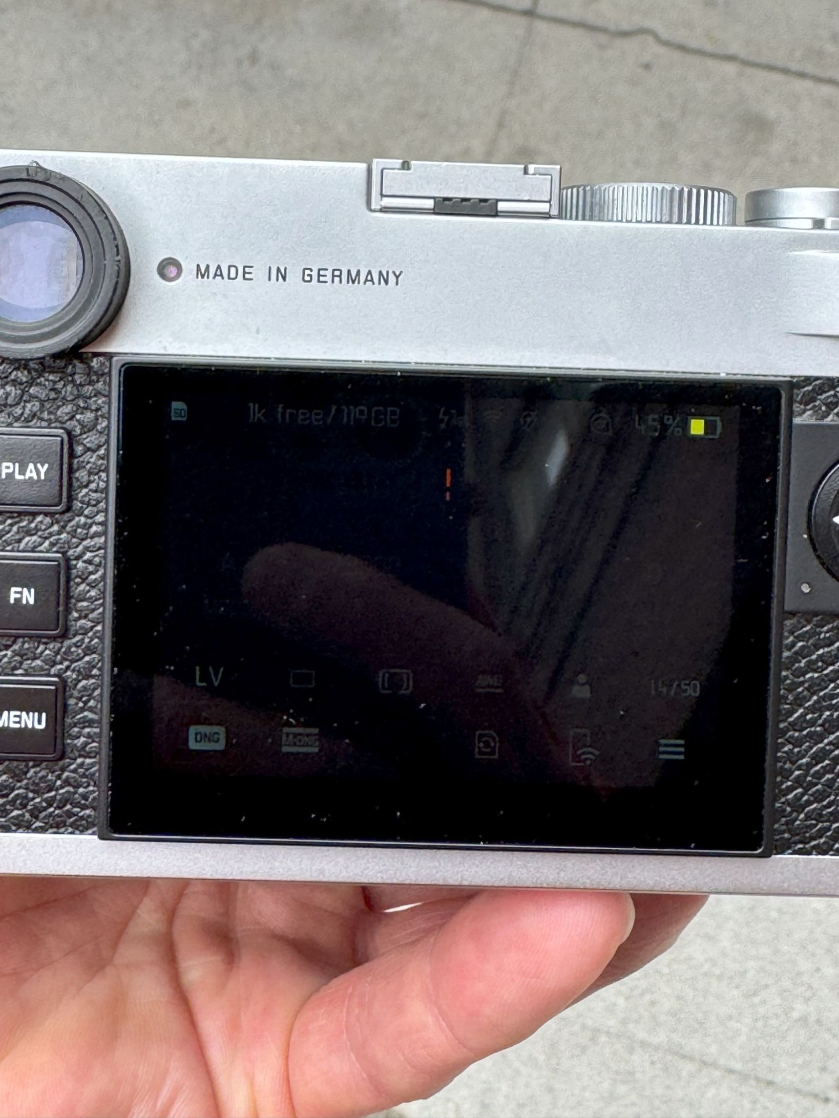

racairns Posted April 17, 2024 Share #8 Posted April 17, 2024 I had the same thing happen with my M11P. I have had the camera for about 2 months. Shooting in Hood River, Oregon with an ambient temp of about 7 degrees Celsius - not very cold! Battery level approximately 80%. As with KenTanaka the centre of the screen was very dark (barely visible) and the borders were normal brightness. This affected approximately 90% if the LCD pixels. This phenomena persisted even when trying to view Menus. Once the camera was off for a while (~1/2 hour) and I was back inside there was less central darkness but a vague residual brownish dimming in the central 1/3 of the LCD. The next morning the LCD is back to normal. The creen brightness setting was not on auto. Is this a defective screen that should be fixed under warranty? Thanks. Link to post Share on other sites More sharing options...

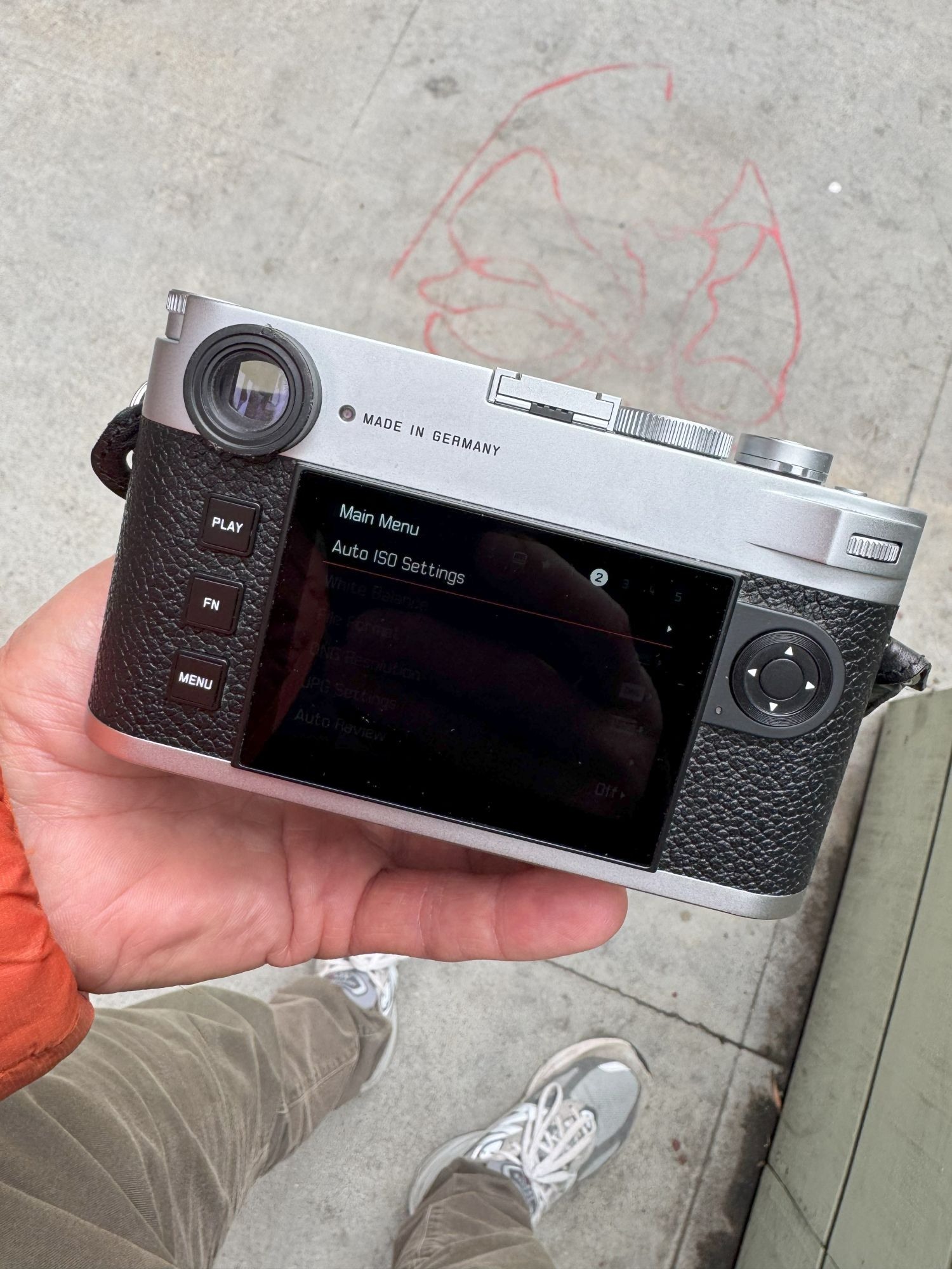

opticagent Posted March 21 Share #9 Posted March 21 @racairns Did you have Leica fix your screen issue? I’m noticing a similar behavior on my m11-p too when I’m in chilly temps. Also not sure how to demonstrate the issue to my local Leica store when it’s not cold and showing that behavior. Welcome, dear visitor! As registered member you'd see an image here… Simply register for free here – We are always happy to welcome new members! Link to post Share on other sites Simply register for free here – We are always happy to welcome new members! ' data-webShareUrl='https://www.l-camera-forum.com/topic/420072-m11-p-rear-lcd-darkens-when-in-colder-climate/?do=findComment&comment=5774876'>More sharing options...
jaapv Posted March 22 Share #10 Posted March 22 Any LCD will get dimmer in the cold. Link to post Share on other sites More sharing options...
racairns Posted March 22 Share #11 Posted March 22 1 hour ago, jaapv said: Any LCD will get dimmer in the cold. @jaapvThanks for your input. What temperature would you expect this to occur? Link to post Share on other sites More sharing options...
jaapv Posted March 22 Share #12 Posted March 22 It is gradual - I would guess mildly annoying below zero Celcius and unusable at zero Fahrenheit. But it depends on the technology used, cooling down of the camera, moisture/wind chill etc. . Link to post Share on other sites More sharing options...
