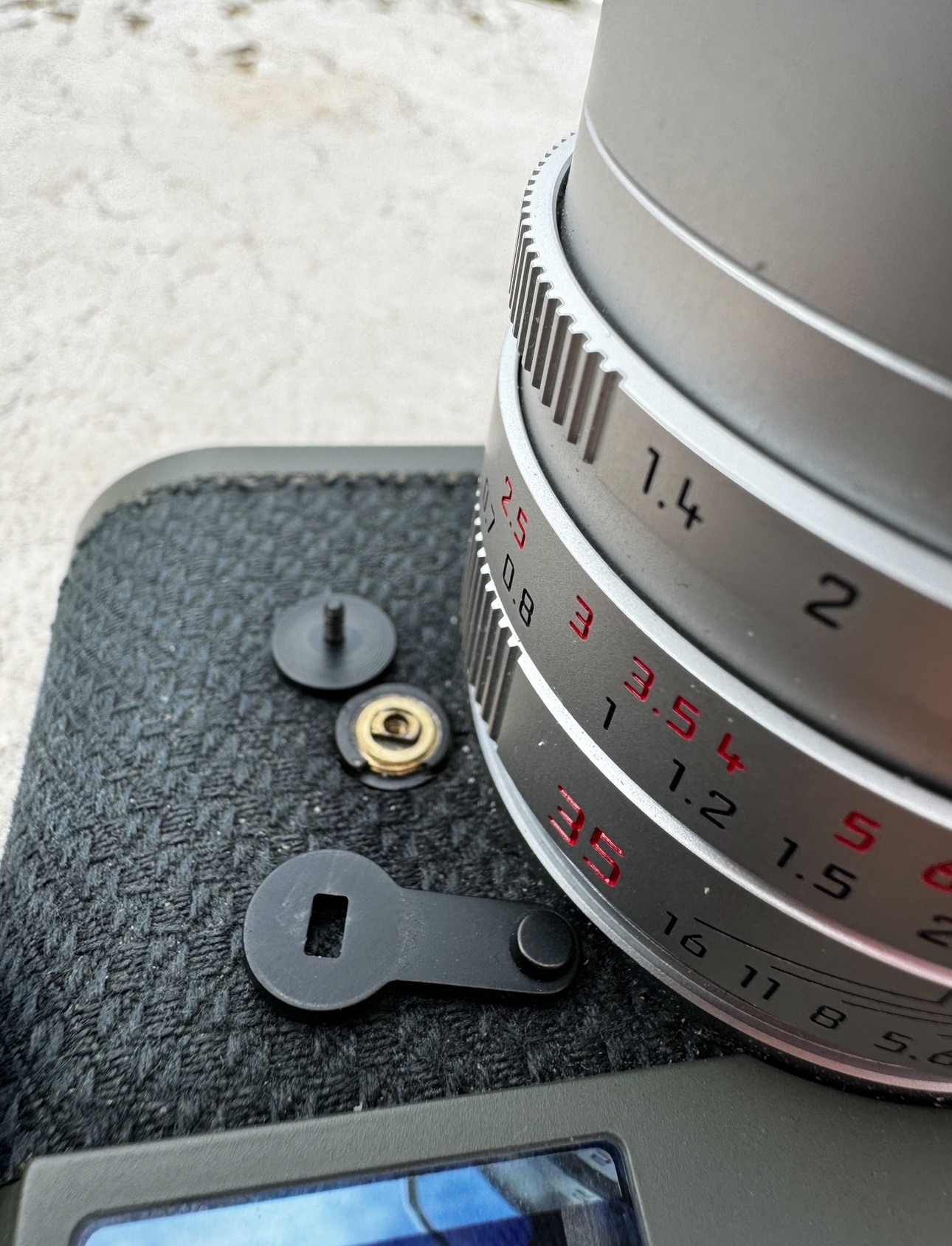

Telemetric Posted February 9 Share #1 Posted February 9 (edited) Advertisement (gone after registration) Welcome, dear visitor! As registered member you'd see an image here… Simply register for free here – We are always happy to welcome new members! As it could not be otherwise (I’ve had issues with all my Leicas, unfortunately), after just two weeks of use, the frame selector lever has fallen off. Luckily, I noticed it, and it fell onto a soft surface. I reinstalled it and tightened the screw by hand, but of course, I am not feeling entirely confident about it. I’m reluctant to send it to Leica for this because I’ll end up waiting six months just for them to apply a bit of thread locker. The question is: do you know if thread locker is used here, and if so, what brand and type does Leica use? I found in internet this but I don’t know if is correct: If the frame selector lever on your Leica M11-P has come loose, you can secure it yourself using a suitable thread locker to prevent it from loosening again. Leica likely uses a mild or medium-strength thread locker, as stronger variants could make future disassembly difficult. Steps to Fix It Properly: 1. Remove the Screw - Carefully unscrew the lever completely. 2. Clean the Threads - Use isopropyl alcohol or a degreaser to clean both the screw and the hole to ensure proper adhesion. 3. Apply Thread Locker - Use a medium-strength (blue) thread locker, such as Loctite 243 or Loctite 222 (low strength, safer if you want to remove it later). Avoid high-strength (red) versions, as they may make future disassembly difficult. 4. Reinstall and Tighten - Screw the lever back in and tighten it firmly but without overtightening. 5. Let It Cure - Allow the thread locker to set for at least 24 hours before using the camera extensively. Since Leica service times can be long, this should be a quick and effective fix to avoid sending it in. So, if is correct, medium or mild? Thanks in advance. Edited February 9 by Telemetric Added pic Link to post Share on other sites Simply register for free here – We are always happy to welcome new members! As it could not be otherwise (I’ve had issues with all my Leicas, unfortunately), after just two weeks of use, the frame selector lever has fallen off. Luckily, I noticed it, and it fell onto a soft surface. I reinstalled it and tightened the screw by hand, but of course, I am not feeling entirely confident about it. I’m reluctant to send it to Leica for this because I’ll end up waiting six months just for them to apply a bit of thread locker. The question is: do you know if thread locker is used here, and if so, what brand and type does Leica use? I found in internet this but I don’t know if is correct: If the frame selector lever on your Leica M11-P has come loose, you can secure it yourself using a suitable thread locker to prevent it from loosening again. Leica likely uses a mild or medium-strength thread locker, as stronger variants could make future disassembly difficult. Steps to Fix It Properly: 1. Remove the Screw - Carefully unscrew the lever completely. 2. Clean the Threads - Use isopropyl alcohol or a degreaser to clean both the screw and the hole to ensure proper adhesion. 3. Apply Thread Locker - Use a medium-strength (blue) thread locker, such as Loctite 243 or Loctite 222 (low strength, safer if you want to remove it later). Avoid high-strength (red) versions, as they may make future disassembly difficult. 4. Reinstall and Tighten - Screw the lever back in and tighten it firmly but without overtightening. 5. Let It Cure - Allow the thread locker to set for at least 24 hours before using the camera extensively. Since Leica service times can be long, this should be a quick and effective fix to avoid sending it in. So, if is correct, medium or mild? Thanks in advance. ' data-webShareUrl='https://www.l-camera-forum.com/topic/419160-fixing-the-frame-selector-lever-m11-p/?do=findComment&comment=5754590'>More sharing options...

jaapv Posted February 9 Share #2 Posted February 9 Loctite Blue 1 Link to post Share on other sites More sharing options...
Knorp Posted February 9 Share #3 Posted February 9 Happened to me as well: also within first two weeks. Fixed it with a tiny bit of Loctite 222, so far so good. 1 Link to post Share on other sites More sharing options...
