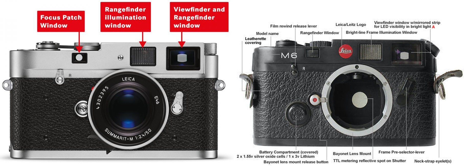

evikne Posted August 27 Share #2063 Posted August 27 And what exactly is a rangefinder window? Here are at least two different explanations from the web. We cannot be entirely sure which window the author of the rumor meant. Welcome, dear visitor! As registered member you'd see an image here… Simply register for free here – We are always happy to welcome new members! 3 Link to post Share on other sites Simply register for free here – We are always happy to welcome new members! ' data-webShareUrl='https://www.l-camera-forum.com/topic/419143-evf-m-rumoured/?do=findComment&comment=5854299'>More sharing options...

adan Posted August 27 Share #2065 Posted August 27 (edited) Well, the Illumination window is already a thing of the past in the M-digitals - eliminated after the M9, and replaced with an internal LED light source. In a full-hybrid RF/VF, both of the other windows would still be needed, for the TWO images the rangefinder aligns when focusing. One without the other would be pointless, like "the sound of one hand clapping." However the RF/"focus patch" window might be slightly more expendable, if all one wants is a pseudo-hybrid with "window-viewing-but-no-manual-focusing," overlaid with a transparent screen that displays LED framelines and a focus-confirmation light of some kind from a phase-detect sensor. Sorta-kinda how Fuji does it in the X-Pros - no actual RF focusing (because the X-Pro has no RF!) but you do get to view through the window. But I'd suggest that would be very "Heath-Robinson🇬🇧 /Rube-Goldberg🇺🇸 Comic-Strip-engineering" for Leica. Not the simple essentials. https://commons.wikimedia.org/wiki/File:William_Heath_Robinson_Inventions_-_Page_034.png https://en.wikipedia.org/wiki/Rube_Goldberg_machine#/media/File:Rube_Goldberg's_"Self-Operating_Napkin"_(cropped).gif For a pure EVF camera, neither of those windows would be required - but as lct has occasionally mentioned, the RF roller cam in the top of the lens mount (right-hand picture above) would still be needed, possibly in very simplified form, to detect the motion of the lens cam ("ahh, the photographer is turning the focus ring!"), and activate/trigger "auto-magnification" when focusing via the EVF (same as it does now for the Viso add-on EVFs). Edited August 27 by adan 1 Link to post Share on other sites More sharing options...
lct Posted August 27 Share #2066 Posted August 27 1 hour ago, evikne said: And what exactly is a rangefinder window? [...] What it has always been if memory serves: Quote A rangefinder camera has a viewfinder window built into its front and a second rangefinder window off to its side (link) 1 Link to post Share on other sites More sharing options...
jaapv Posted August 27 Share #2067 Posted August 27 Advertisement (gone after registration) 1 hour ago, evikne said: And what exactly is a rangefinder window? Here are at least two different explanations from the web. We cannot be entirely sure which window the author of the rumor meant. Welcome, dear visitor! As registered member you'd see an image here… Simply register for free here – We are always happy to welcome new members! The focus patch IS the rangefinder. The rest is the optical viewfinder. When we talk about a rangefinder camera it is shorthand for an optical viewfinder / rangefinder camera. See the diagram in Adan’s post. It is impossible to have a coincidence rangefinder with one window. Otherwise it is a telescope. Having an optical viewfinder with some digital information projected in is far less effective than a good EVF or real optical rangefinder/viewfinder. If Leica finds a better the existing less than optimal pseudo-RF system by Fuji I raise my hat to them. 1 Link to post Share on other sites More sharing options...
