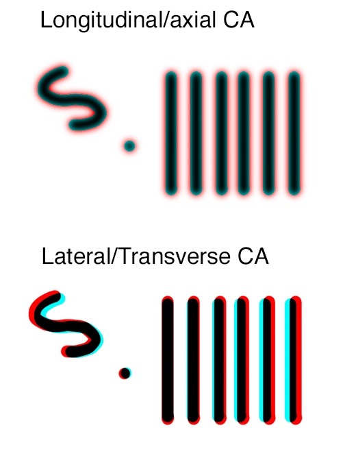

Alberti Posted February 2 Share #89 Posted February 2 On 12/14/2024 at 8:50 PM, adan said: Whether a lens is apochromatic or not has nothing to do with lateral chromatic aberration - and never has. And, of course, an "APO" marketing designation these days doesn't even have that much to do with the correction of longitudinal chromatic aberration - even for Leica. [--] Cosina is just clarifying that their APO designation is the science-based one. APO relates to axial CA only. Welcome, dear visitor! As registered member you'd see an image here… Simply register for free here – We are always happy to welcome new members! I noted this lateral/transverse CA in my Elmarit 21mm /E60. And also in my new LLL 28mm/9E, but about the half of the Elmarit. I saw picture @pegelli made with a 75mm Lux and that also showed this effect on the edge of the frame (camera straps doubled). Small things like branches get a life of their own. As such annoying. But I once had the SA 21 and gave that back because of the corners - like this. Too bad. However I like the rendering of the old Elmarit (Mandler..) so no complaints. Quote Link to post Share on other sites More sharing options...
