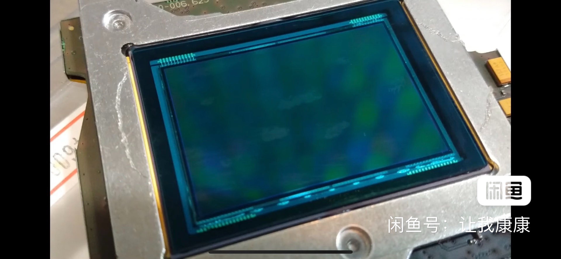

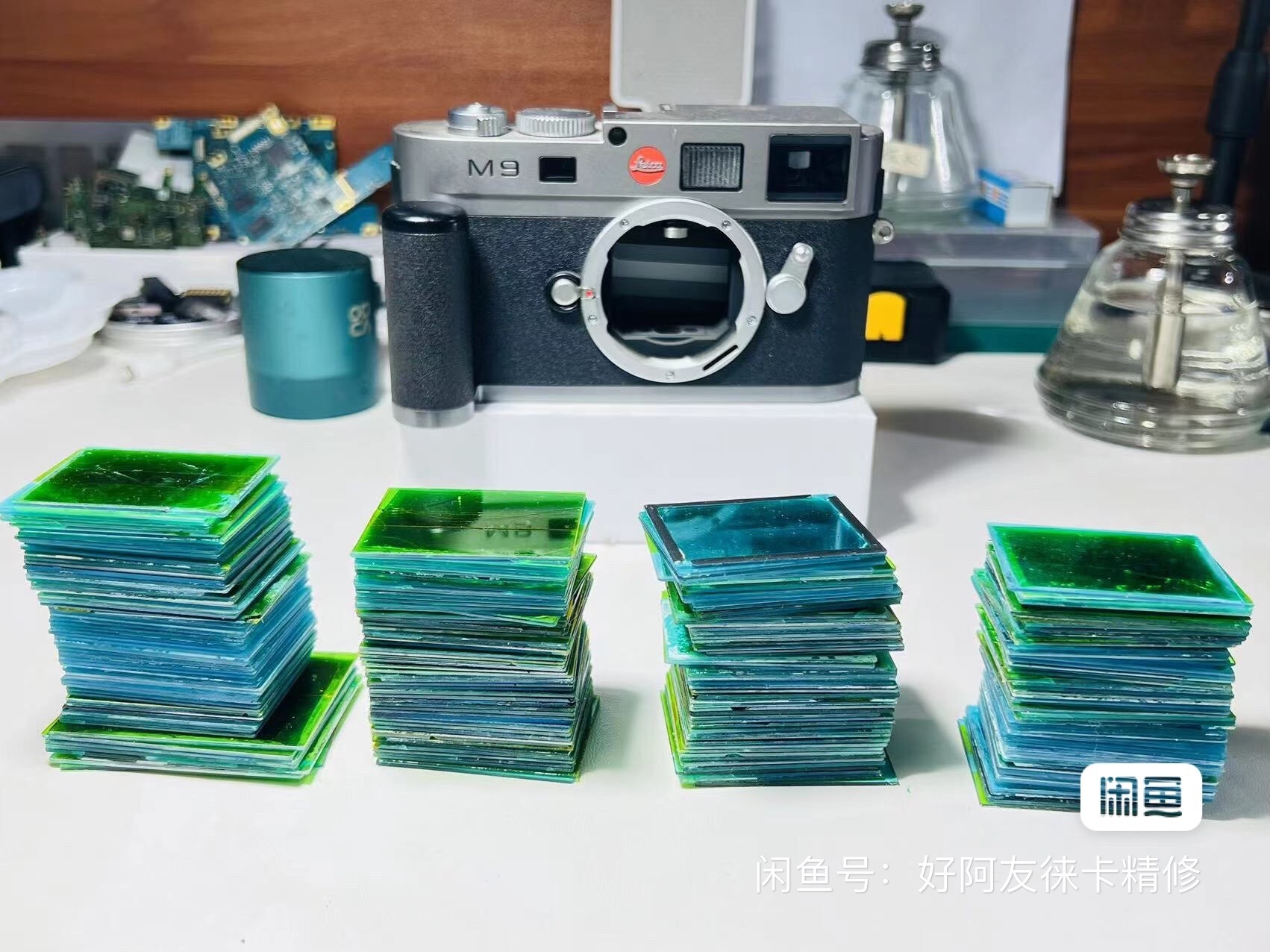

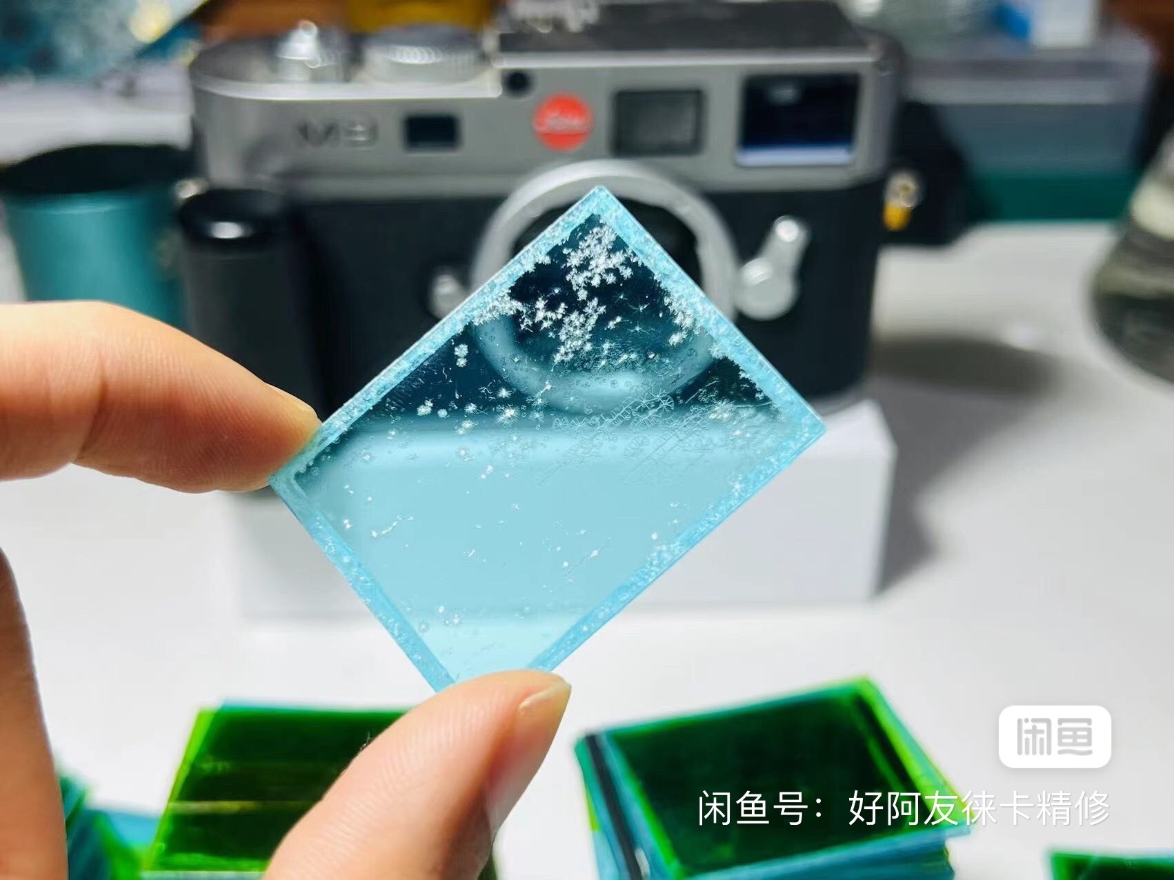

chrismuc Posted November 14, 2024 Author Share #15 Posted November 14, 2024 some considerations / questions regarding the sensor glass 1 I saw that the sensor glasses for M9 and S have a quite strong (cyan-) bluish color tint. Does anyone know why? UV- or IR-protection for the sensor? If the glass is bluish it would mean that the transmitted light has slightly bluish tint. But if the bluish color of the glass is coming from a bluish looking vacuum coating, that color is reflected and the transmitted light has slightly yellowish tint. 2 Was the original sensor glass (AR?) coated? If so, was the corrosion a corroded coating or is it corrosion of the glass below the coating? One workshop here also offered to polish the original glass to remove the corrosion. According to the guy, that could help to keep the sensor well for a few years, depending on the environmental conditions. But that only might make sense, if the sensor glass was not coated. If the polishing removes the coating, I have doubts that that would be helpful (also the color transmission might be effected). 3 They offer here up to three sensor glass options: German Schott glass, Japanese optical glass and Chinese optical glass. But hardly any workshop can provide a data sheet of the glass they use, so it's really hard to decide, which workshop to trust to do a repair. (some mention that they also replace the low pass (AA) filter ... which is bs because the sensors in S cameras don't have low pass filters) the last image shows a badly corroded (M9) sensor non of the sensors I saw in the S cameras looked so bad, ... luckily (I took the risk and bought a S006 from Beijing Leica boutique store. I hope a reliable source. I shall receive it this weekend, will test it and will share the experience.) Welcome, dear visitor! As registered member you'd see an image here… Simply register for free here – We are always happy to welcome new members! 2 Link to post Share on other sites Simply register for free here – We are always happy to welcome new members! ' data-webShareUrl='https://www.l-camera-forum.com/topic/416230-leica-s006-sensor-corrosion-question/?do=findComment&comment=5697320'>More sharing options...
