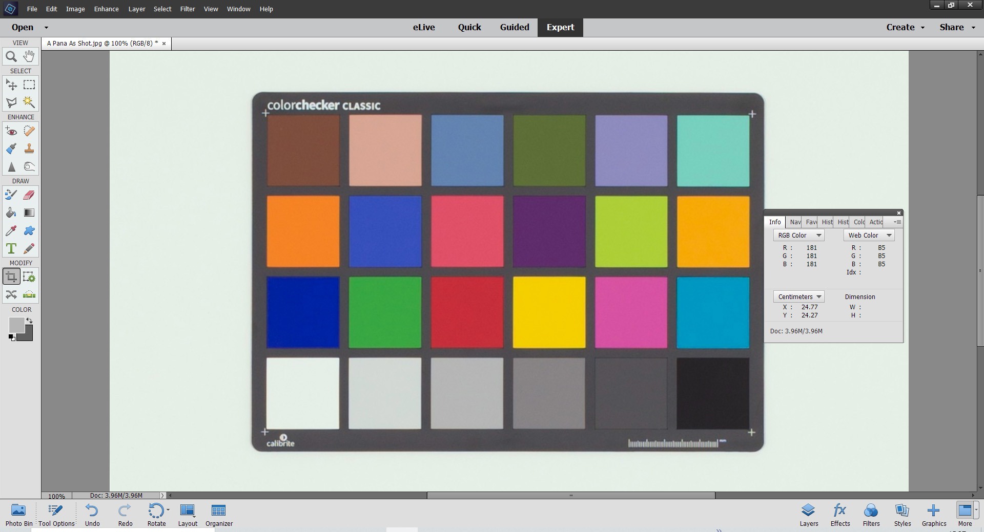

On 10/19/2024 at 4:15 PM, pippy said:
Thanks for the colour-checker shot. Your colour-balance is miles out and because the RGB all have different values we are in that 'Tertiary' area which is why there is a brownish tinge.
I took the liberty of downloading your Colour-checker picture. Here are the results when it was opened / adjusted in Ps.
As shot. Note RGB readings (from grey box third from left) are 190 / 179 / 185;
In the version of Ps which I normally use there is a simple 'Remove Colour Cast' tool (NCT is the 'key' short-cut) which involves using the Dropper Tool. Here is the above pic after dropper was used on same grey box. Readings are now 181 / 181 / 181;

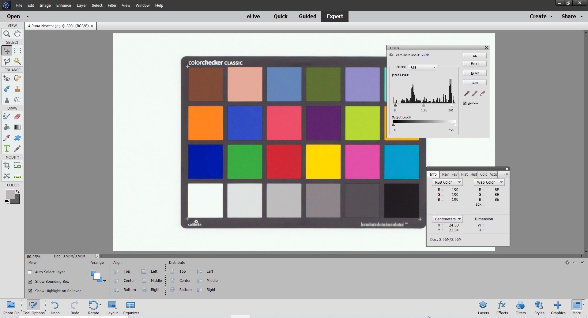

The image, as can be seen, is very flat (hence the 'muddy-looking' white behind the checker) so the next stage is to adjust contrast-levels.We are looking for a neutral near-white somewhere (RGB in the 240's) and a neutral mid-tone (blacks should be well down too).
In the 'Levels' dialogue box the brighter end of the scale (to the right) has been taken to 241; mid-point left as-is and dark end raised to 9. Here are two grabshots of the reworked image. Top shows readings from the white square and second from the 3rd from left as usual.
The white readings - 245 / 251 / 249 - are a bit off but it's quite usual for the whiter squares to discolour either through age or else just getting slightly dirty. Grey levels are neutral at 190 / 190 / 190;
