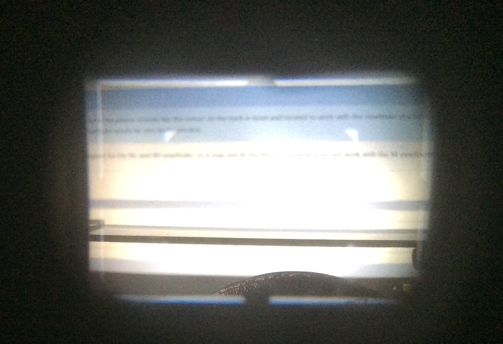

Pyrogallol Posted July 10, 2024 Share #11  Posted July 10, 2024 111g, 50mm Summitar and Barn Door hood works OK. Black line across frame and top edge of lens is all you see through the viewfinder, best picture I could get trying to line up an I Pad camera. Welcome, dear visitor! As registered member you'd see an image here… Simply register for free here – We are always happy to welcome new members! 1 Link to post Share on other sites Simply register for free here – We are always happy to welcome new members! ' data-webShareUrl='https://www.l-camera-forum.com/topic/398169-choosing-lens-for-leica-iiig-on-4-alternatives-lenses/?do=findComment&comment=5416106'>More sharing options...

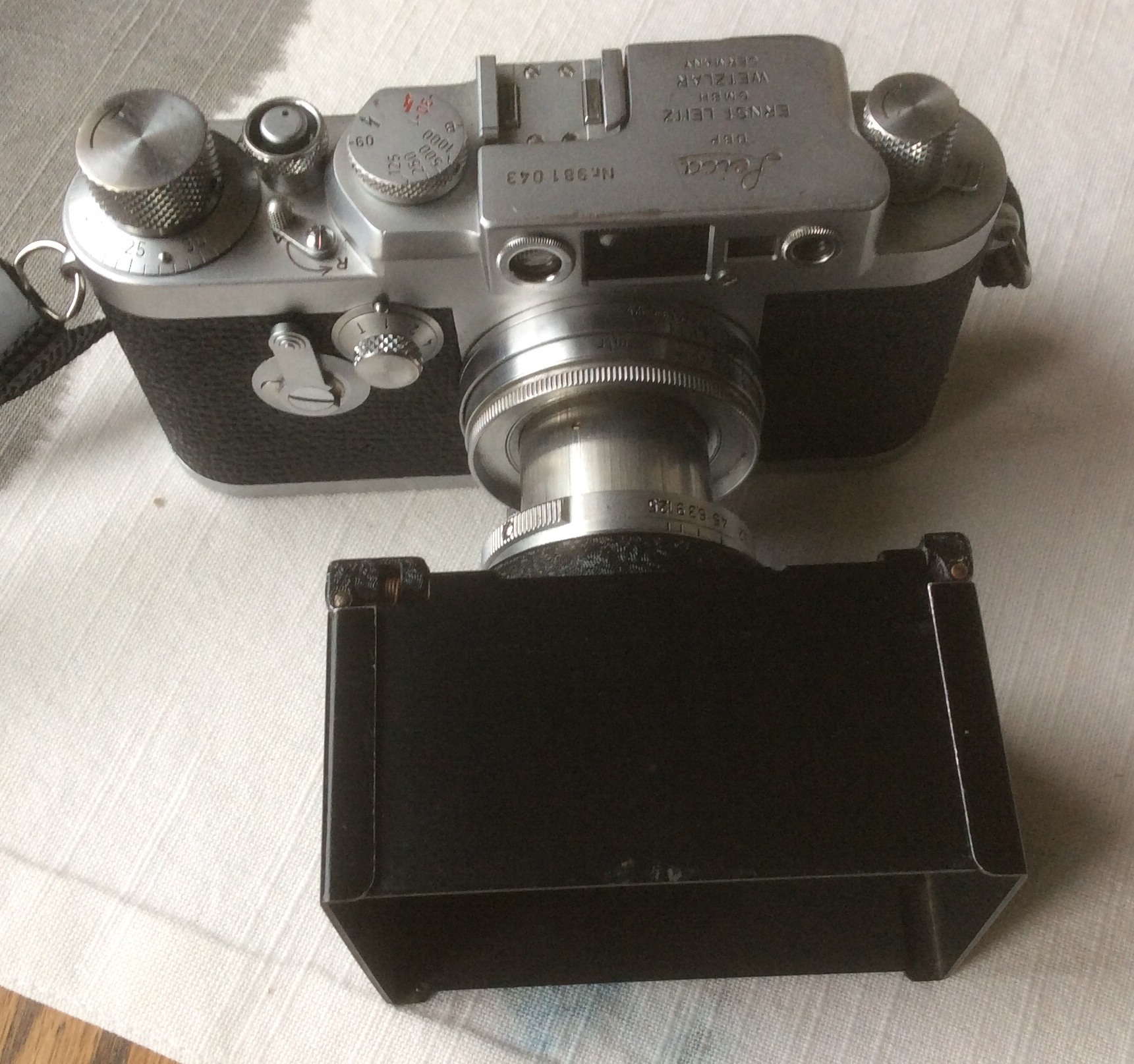

Anbaric Posted July 11, 2024 Share #12  Posted July 11, 2024 On 7/9/2024 at 4:51 PM, liemjerry said: Hello, I have 4 alternative lenses to choose from to use on the Leica IIIg. The options include: 1. Ernst Leitz Wetzlar Elmar f=9cm 1:4 2. Ernst Leitz Wetzlar Elmar f=5cm 1:3.5 3. Ernst Leitz Wetzlar Summaron f=3.5cm 1:3.5 4. Ernst Leitz Wetzlar Summitar f=5cm 1:2 Of the 4 lenses, I want to choose 2 first, roughly, which one is the most worthy of choice in terms of quality of sharpness, bokeh, and more flexible use? Thank You  I like the Summitar and use it as the standard lens on my IIIg. The rendering can look surprisingly modern, especially when stopped down a bit, though you can get interesting swirly bokeh in some situations, especially at larger apertures with foliage in the background. Erwin Puts rated it a little sharper than the first Summicron in the centre when shot wide open, though the Summitar benefits less from stopping down and is softer in the corners. The Summitar seems easier to find in clean condition than the collapsible Summicron, too. Get a coated one if you can. I have one of the barn door hoods more as a curiosity than something I would use regularly. The Summitar has a unique conical filter thread, but the SNHOO adapter (or a modern copy) converts it to E39, which opens up the choice of both filters and hoods. The 5cm Elmar f/3.5 is of course a classic and you can't really go wrong with one if you don't mind a slower lens and the slightly fiddly aperture lever. Either way, a 50 of some description is a natural fit for the IIIg's main framelines. A 90 like that 9cm Elmar will of course pair well with the inner framelines, though you may get more use out of the Summaron, which is more of a general purpose lens. But the latter will need an accessory finder for accurate framing, making the built-in finder redundant, so it's arguably a better fit for one of the earlier LTM bodies if you happen to have one. Link to post Share on other sites More sharing options...
Doug A Posted July 11, 2024 Share #13  Posted July 11, 2024 7 hours ago, Pyrogallol said: 111g, 50mm Summitar and Barn Door hood works OK. Black line across frame and top edge of lens is all you see through the viewfinder, best picture I could get trying to line up an I Pad camera. Welcome, dear visitor! As registered member you'd see an image here… Simply register for free here – We are always happy to welcome new members! That's good to know. Thank you! Link to post Share on other sites More sharing options...
