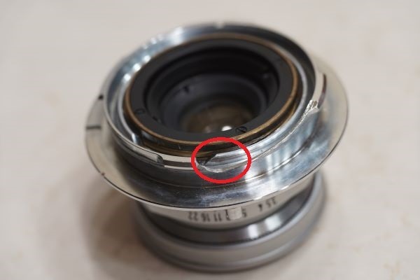

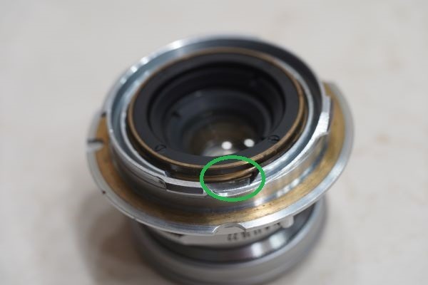

TomB_tx Posted June 14, 2024 Share #6 Posted June 14, 2024 The alignment problem is the adapter: threads are cut at wrong orientation for the cutout on the back . Get a better adaptor - Leitz or Rayqual. Here's my copy of that lens mounted on a Leitz adapter. Notice how the cutout area of the lens mount aligns with the cutout on the adapter where the camera roller moves when focusing: Now here's a cheap copy adapter, where the lens is not aligned so the cam can enter the cutout on the lens: 1 1 Link to post Share on other sites More sharing options...

TomB_tx Posted June 14, 2024 Share #8 Posted June 14, 2024 The Summaron is likely the only model where this alignment is so critical - the adapter would likely work fine with other lenses, 2 Link to post Share on other sites More sharing options...
