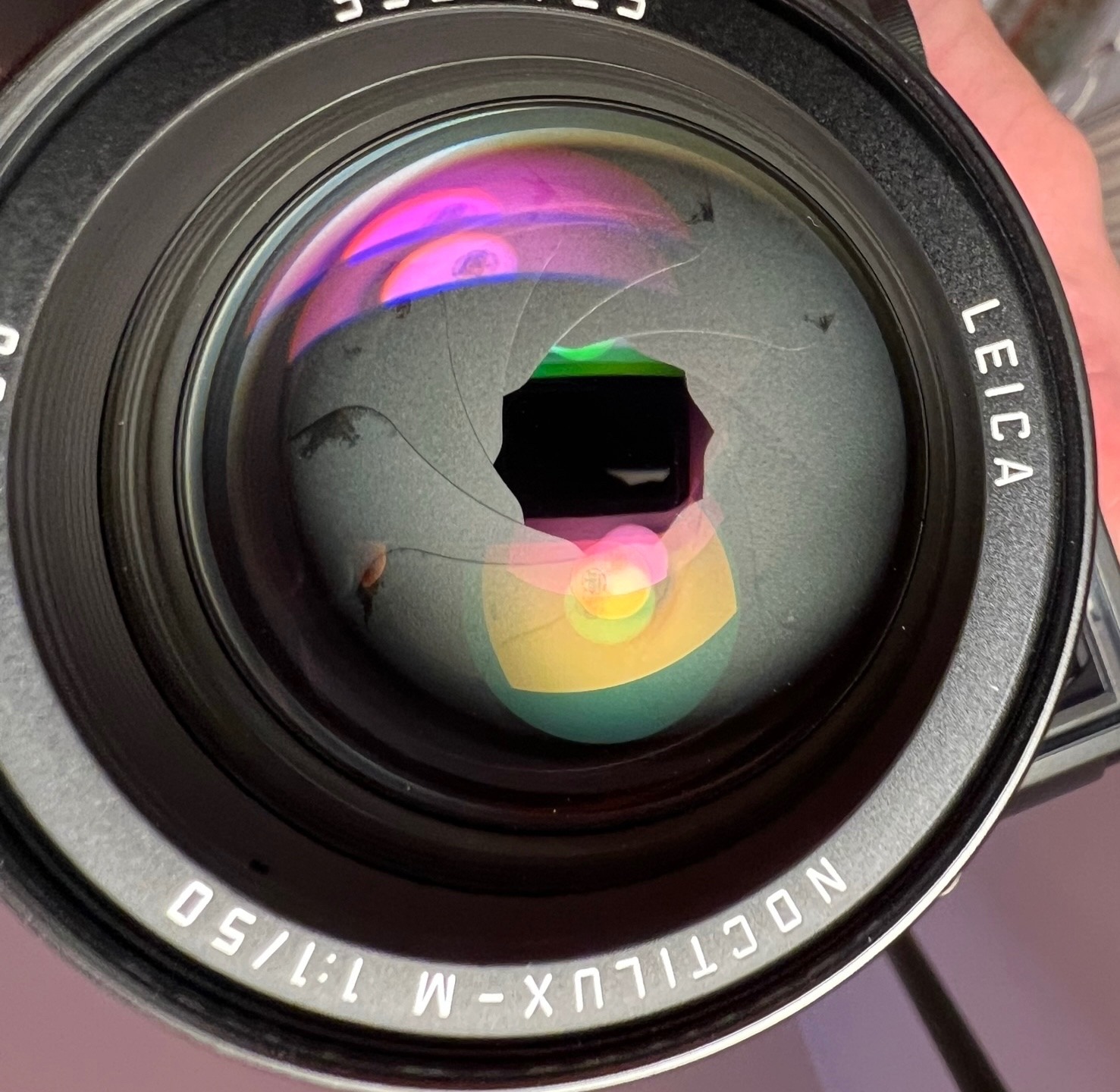

fil-m Posted March 30, 2024 Share #10 Posted March 30, 2024 I can't really tell but sometimes if there is a darker patch of black, it could be excess oil. I had my Noctilux 50/1 once serviced by Leica Wetzlar and those black marks appeared a few months later. It was indeed excess oil and I figured it out because the patch was "moving" kind of expanding depending on how I stored the lens and played with the aperture ring (swiping marks). Afterwards I could also see some excess oil bleeding out from the little screws on the barrel. I had it serviced again and the problem was fixed. If the marks are static and don't change with time, the aperture blades are most probably scratched. If they change with time as you store the lens and play with the aperture ring, it is most probably excess oil. 2 Link to post Share on other sites More sharing options...

69xchange Posted March 30, 2024 Author Share #15 Posted March 30, 2024 3 hours ago, fil-m said: Honestly it is difficult to say but I believe the odds of extra oil are higher if the blades are darker and/or shiny. This was the picture of my noctilux prior to a second CLA from Leica to remove the excess oil (resulting from the first CLA 😆). NB: they did the second CLA for free because works are under a 2 years warranty. I can understand how this situation could annoy you but in your case and even if we assume it is oil (and not scratches), it looks to be a very faint/minimal with no impact or forward risk. In my case oil was "migrating" and I did not want it to reach the glass that's why I've asked them to correct their mistake. Welcome, dear visitor! As registered member you'd see an image here… Simply register for free here – We are always happy to welcome new members! Wow that is embarrassing for Leica to screw it up in the first place. Glad you got yours fixed afterwards! 1 Link to post Share on other sites More sharing options...
