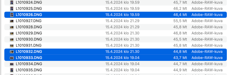

Mikko Kankainen Posted April 19, 2024 Share #82 Posted April 19, 2024 (edited) I can reproduce it. Just tried. WELL almost. I took about 20 shots. Pressed camera shutdown ONCE. Waited until it was closing, no red light blinking. ALL IMAGES ARE GONE. edit. Then tried it again. Shot a burst and shutdown camera. Now the images were there. So I quess that the problem was that after suspend they were not writter because of battery was taken out. Then we continue to shoot and they got overwritten. Could the situation be something like that? EDIT2. Now when I try it does not happen. All images are there. But first time those 20 images were not showing up when pressing play. Last image was from yesterday. Now I can see them. I will continue to try if I can make the same thing happen. Edited April 19, 2024 by Mikko Kankainen Link to post Share on other sites More sharing options...

Mikko Kankainen Posted April 19, 2024 Share #84 Posted April 19, 2024 (edited) And now I could do it a second time. I took three bursts. After first and second suspend and battery out, nothing happened. Then when I took third burst and put camera to suspend burst number 1 and 2 were missing. They were there earlier. Then I scrolled camera and burst number 2 reappeared but burst number 1 was missing. It looks like here is a smoking gun. Just hope that Leica gets this. EDIT And when I open SD card only burst number 3 is in card. Burst number 1 and 2 are gone. I took about 30 images, 7 are in card. And I saw those images in playback so they were there! After 2 battery put when going to sleep and they were gone. This does it. This camera goes to bag and I will not use it in any critical work. Edited April 19, 2024 by Mikko Kankainen 1 Link to post Share on other sites More sharing options...

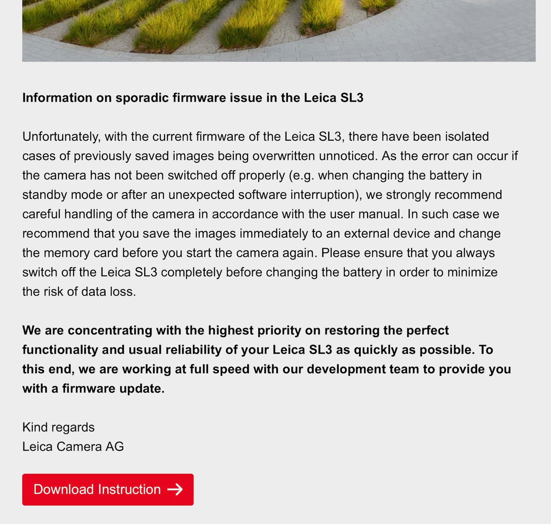

MG Photo Posted April 19, 2024 Share #89 Posted April 19, 2024 Mikko I just received my replacement SL3 yesterday after experiencing similar issues and I photograph weddings professionally (about 35-40 a year) Are you saying the files are being corrupted or overwritten when pulling the battery WHEN THE CAMERA ISNT POWERED OFF COMPLETELY. This is critical. i notice my issue only happened when i popped the battery WITHOUT first turning off the camera completely. Not putting it to sleep, im talking about a full power down. if its on or asleep i noticed the issue but NOT when it was first powered down. Link to post Share on other sites More sharing options...

Mikko Kankainen Posted April 19, 2024 Share #93 Posted April 19, 2024 (edited) Leica replyed, there is a ticket now. Lets hope things go on. It is just difficult to explain in english and writing. But hope they get what I try to say. And to be clear, I understand that bugs and errors can occur and I know this will be fixed. I just want to warn all that they dont get into a same situation. Edited April 19, 2024 by Mikko Kankainen Link to post Share on other sites More sharing options...

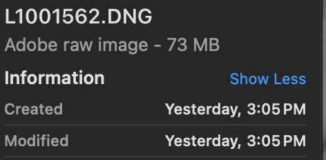

LocalHero1953 Posted April 19, 2024 Share #95 Posted April 19, 2024 1 hour ago, frame-it said: what does video TC have to do with the timestamp of a file? this sounds more like a serious buffer/volatile memory problem IDK - just the question of how date and time are managed in f/w. The introduction of a timecode function must have some interface with the internal clock. It may be a red herring. Link to post Share on other sites More sharing options...

PeterBoyadjian Posted April 19, 2024 Author Share #98 Posted April 19, 2024 So when I lost my files, my SL3 did shut off when I was checking the percentage on my power brick in my back pocket. I was shooting using the DC-Coupler, and did not know that my power brick shuts down when you check the percentage left. Maybe now that this is happening to more photographers Leica will look into the issue more. My local rep and NJ basically said just to let them know if it happens again. 1 Link to post Share on other sites More sharing options...
