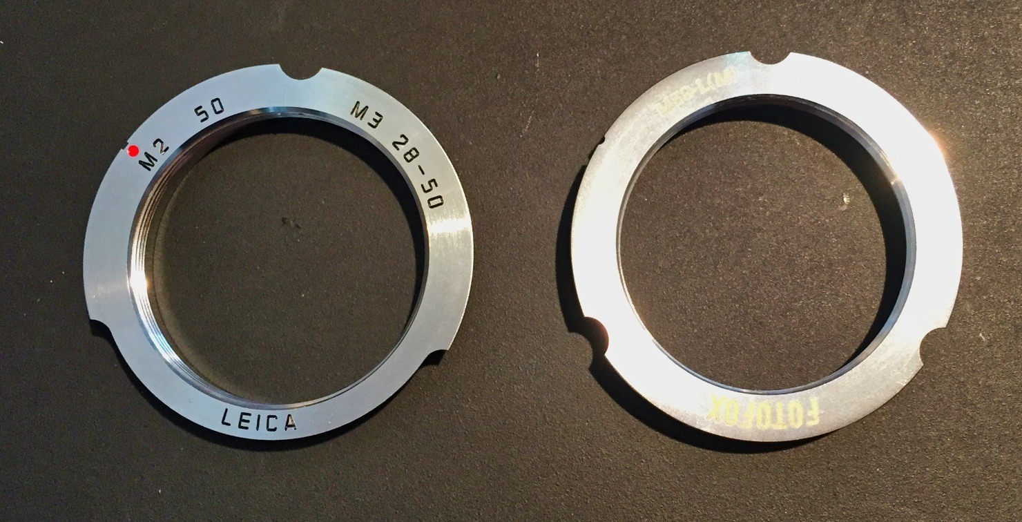

AndreasG Posted February 14, 2024 Share #12 Posted February 14, 2024 You need an adapter as shown right in the image below Welcome, dear visitor! As registered member you'd see an image here… Simply register for free here – We are always happy to welcome new members! Link to post Share on other sites Simply register for free here – We are always happy to welcome new members! ' data-webShareUrl='https://www.l-camera-forum.com/topic/389162-what-adapter-to-use-screw-in-lens/?do=findComment&comment=5039804'>More sharing options...
brickftl Posted February 14, 2024 Author Share #13 Posted February 14, 2024 31 minutes ago, AndreasG said: You need an adapter as shown right in the image below Welcome, dear visitor! As registered member you'd see an image here… Simply register for free here – We are always happy to welcome new members! I'd be grateful if you could tell me where to get the one on the right, thanks! Link to post Share on other sites More sharing options...

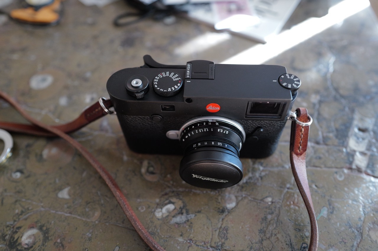

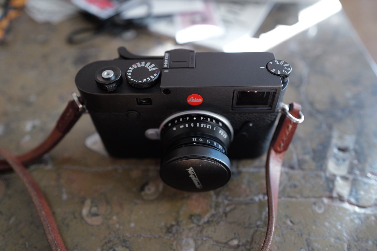

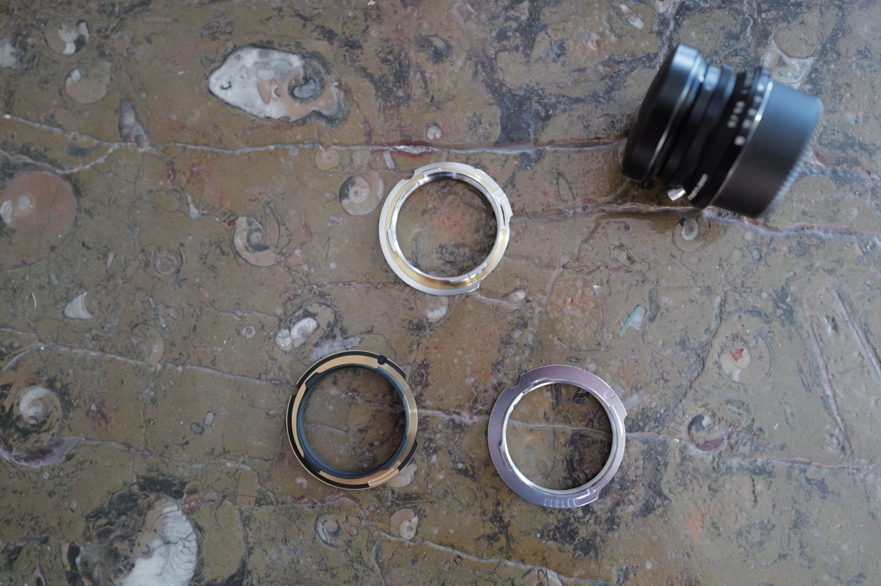

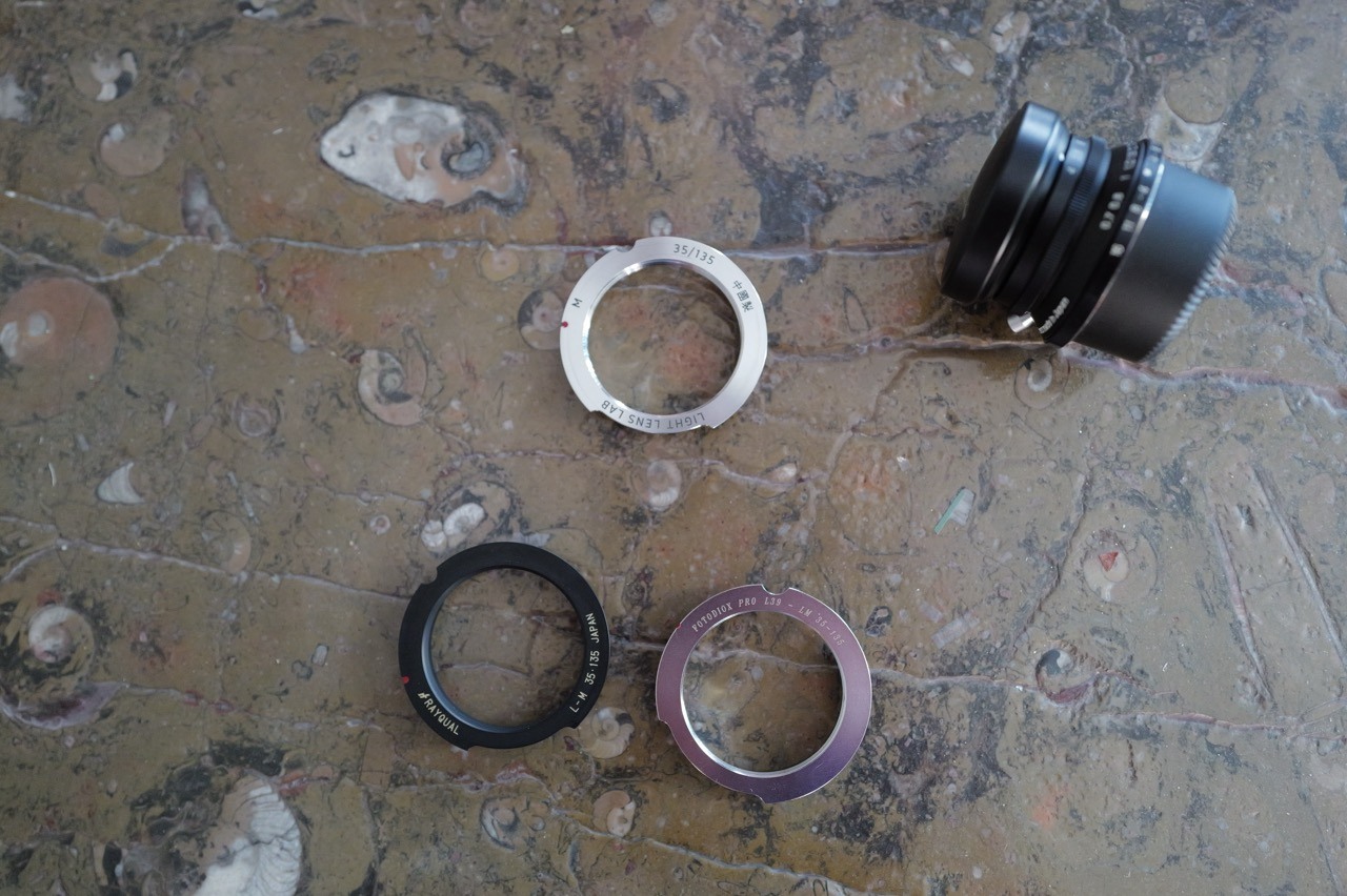

RobW0 Posted February 14, 2024 Share #16 Posted February 14, 2024 22 hours ago, brickftl said: Hi, I'm getting a Voigt 25/4 snapshot skopar, and I understand because it's a screw-in lens, I need to get an adapter. Does anyone know what adapter I need? Thanks. I have this lens and here are the adapters I have tried. I have the Light Lens, Rayqual and Fotodiox Pro. I found the first two gave me the best results. If you want to code it the Rayqual is best. You can see the three adapters in the photos attached. Welcome, dear visitor! As registered member you'd see an image here… Simply register for free here – We are always happy to welcome new members! This picture shows the lens with the Rayqual. This is the lens with the Fotodiox Pro adapter. The thing I did not like about this one is that the lens doesn't thead on so the index is at the top. It is offset a bit. Link to post Share on other sites Simply register for free here – We are always happy to welcome new members! This picture shows the lens with the Rayqual. This is the lens with the Fotodiox Pro adapter. The thing I did not like about this one is that the lens doesn't thead on so the index is at the top. It is offset a bit. ' data-webShareUrl='https://www.l-camera-forum.com/topic/389162-what-adapter-to-use-screw-in-lens/?do=findComment&comment=5039944'>More sharing options...
brickftl Posted February 14, 2024 Author Share #17 Posted February 14, 2024 Just now, RobW0 said: I have this lens and here are the adapters I have tried. I have the Light Lens, Rayqual and Fotodiox Pro. I found the first two gave me the best results. If you want to code it the Rayqual is best. You can see the three adapters in the photos attached. Welcome, dear visitor! As registered member you'd see an image here… Simply register for free here – We are always happy to welcome new members! This picture shows the lens with the Rayqual. This is the lens with the Fotodiox Pro adapter. The thing I did not like about this one is that the lens doesn't thead on so the index is at the top. It is offset a bit. oh thanks for that very much! I'll look for the first 2. And just wondering, how do you like the skopar? I want to get it because I saw a video that if there's enough light to set it at f8 or higher, and with a shutter say not slower than say 1/250, it basically turns into a point and shoot, not having to think about settings. Is that your experience? Are you happy with images it produces? Link to post Share on other sites More sharing options...
AndreasG Posted February 14, 2024 Share #18 Posted February 14, 2024 (edited) vor 2 Stunden schrieb brickftl: I'd be grateful if you could tell me where to get the one on the right, thanks! The brand is FOTOFOX I got it from ebay seller freemax188. Edited February 14, 2024 by AndreasG Link to post Share on other sites More sharing options...
