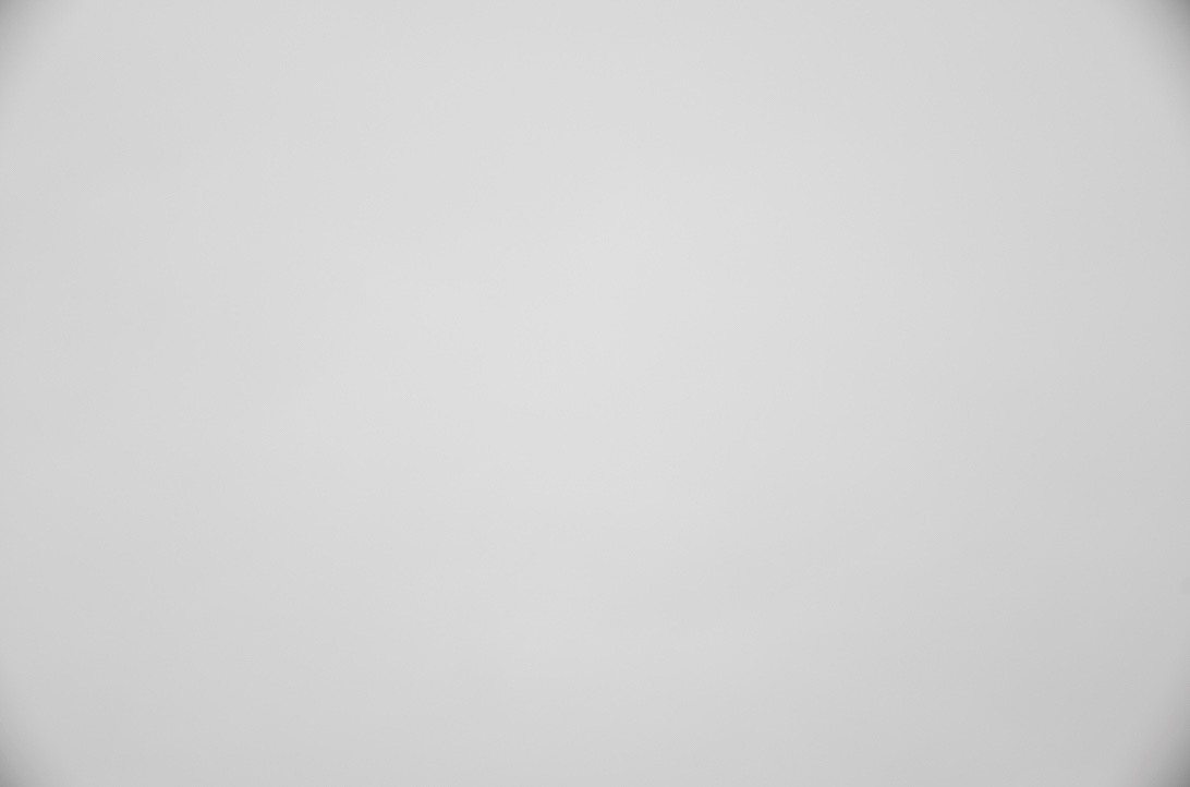

Yes, though unfortunately the LEM/VIS-adapter causes vignetting with some long lenses:
Telyt 4/200 with LEM/VIS:

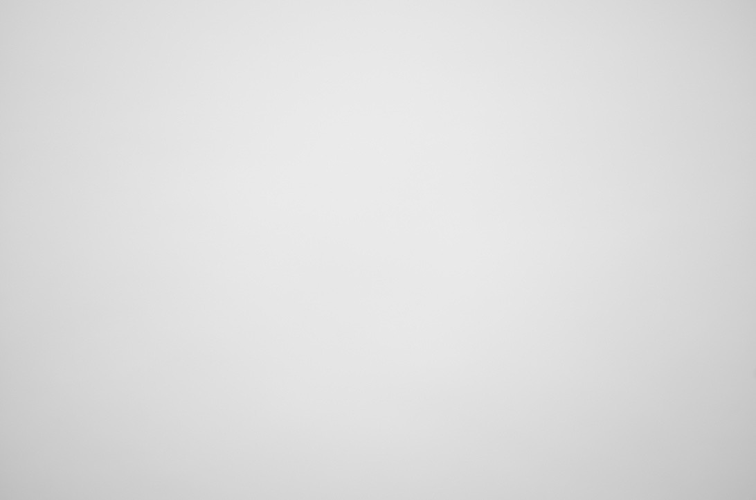

There is no vignetting with the original Visoflex housing:
Therefore I still prefer the Visoflex housing as a simple adapter: you fix the mirror in upward position and remove the release lever (which can be restored If you like). It's perhaps not very elegant but not heavier or bulkier than the LEM/VIS-adapter.

Yes this combination - which is rather heavy btw. - works aswell, but will also cause vignetting.
It is the M-R adapter that causes vignetting.
For those working on the L mount, the R-L adapter does not give vignetting, so I suppose the R-L with R-M on top for Visoflex will not give vignetting also. It is definitely a better solution for R lenses longer than 100mm compared to using a stack of L-M and M-R.
vor 25 Minuten schrieb dpitt:
I don't think so:
1:3.4/180mm Apo-Telyt-R with R-M-adapter on M10 Monochrom:
1:4/200mm Telyt with R-toM + Visolex lens to R-adapter (14127):
There is less vignetting than with the Lem/VIs but more than with the Visoflex housing (see the second example in #6).

You want some more examples for the LEM/VIS vignetting:
Lens head of 1:4/135mm Elmar with 16471+16472+14674 and LEM/VIS:
Same combination with Visoflex housing:
Edited by UliWer
