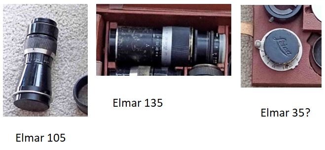

alan mcfall Posted November 10, 2023 Share #8 Posted November 10, 2023 (edited) Can you show a photo of the outside top of the leather combination case? If it is a Leitz case, it's one I have not seen before. Perhaps custom made. The serial numbers for the 105 Elmar and 73 Hektor would be interesting. The VEHIG is typically mounted on a larger stand, which is not shown here. A panarama bracket is shown, is the rotating head in one of the boxes? The "torpedo" finder with parallax correction is not common. The small chrome rings mounted on the rear windows for the viewfinder and rangefinder may be diopter correction lenses. A wonderful "kit". Edited November 10, 2023 by alan mcfall more text Link to post Share on other sites More sharing options...

ssmith Posted November 11, 2023 Author Share #10 Posted November 11, 2023 Hi Alan - Looking closely at the case I can find no identifying markings or trademarks on either the case or the locking hardware. See attached Photos. The serial No. for the 73mm Hektor lens is 129130. What you call the 105mm Elmar is actually a 135mm Elmar and interestingly enough its serial number matches that of the camera - 22238. I am assuming that this may be somewhat unusual? I do not have any additional hardware for the VEHIG. What you are calling a panorama head I had assumed was some sort of stereo adapter (as it appears to flop the camera from one side of a tripod mount to the other) but I cannot seem to find it shown in the accessory catalogs that I have looked through. Steve Welcome, dear visitor! As registered member you'd see an image here… Simply register for free here – We are always happy to welcome new members! 2 Link to post Share on other sites Simply register for free here – We are always happy to welcome new members! ' data-webShareUrl='https://www.l-camera-forum.com/topic/384372-barnack-identification/?do=findComment&comment=4902113'>More sharing options...
jerzy Posted November 11, 2023 Share #11 Posted November 11, 2023 (edited) vor 4 Stunden schrieb ssmith: What you call the 105mm Elmar is actually a 135mm Elmar and interestingly enough its serial number matches that of the camera - 22238. I am assuming that this may be somewhat unusual? it is indeed, it indicates that the camera which was born as IA (fix mounted Elmar ) as converted to interchangeable mount possibly in the second half of 1930, lenses accompanying the camera are carrying camera serial number engraved. Do other lenses cary camera number engraved on the Depth of Field scale? could be 5 digit (22238) but could be as well 3 digit (238) - se example below Welcome, dear visitor! As registered member you'd see an image here… Simply register for free here – We are always happy to welcome new members! Is there as well Elmar 35mm in the set? Edited November 11, 2023 by jerzy wrong comment 1 Link to post Share on other sites Simply register for free here – We are always happy to welcome new members! Is there as well Elmar 35mm in the set? ' data-webShareUrl='https://www.l-camera-forum.com/topic/384372-barnack-identification/?do=findComment&comment=4902472'>More sharing options...

ssmith Posted November 11, 2023 Author Share #14 Posted November 11, 2023 (edited) I did a nearly complete inventory of the camera and accessories - here are the results: Leica IIIa Sync 35mm Film Vintage Range Finder Camera - Started out as a Fixed Lens Model Ia in 1930 - Modded one or more times Serial No. 22238 Leitz Elmar 35mm f3.5 L39 Mount No Ser # Good Slight Haze Leitz Elmar 50mm f3.5 L39 Mount No Ser # Very Good Leitz Hektor 73mm f1.9 L39 Mount Ser # 129130 Very Good w/ Metal Caps & Hood Leitz Elmar 105mm f6.3 L39 Mount Ser # 136173 Excellent w/ caps Hood & Case "Mountain Elmar" Leitz Elmar 135mm f4.5 L39 Mount Ser # 22238 Good w/ clear plastic front cap & Black Metal End Cap ORTVO Leitz Aluminum Screw-in Body Cap ELPRO Leitz 1* Screw-in Supplementary Front Lens - Missing ELPIK Leitz 2* Screw-in Supplementary Front Lens ELPET Leitz 3* Screw-in Supplementary Front Lens VIDOM Leitz Black Torpedo Viewfinder w/ Parallax Correction FOV: 5, 7.3, 13.5 WINKO Leitz Early Black Rt Angle Viewfinder - Large Eyecup BEHOO Leitz Universal Clamping Ring & 4 Extensible Legs for Close-ups BEKUR Leitz 3 Extension Rings for 50mm Summar-Elmar BETAB Leitz 4 Intermediate rods BEOOY Leitz 4 Extensible Legs for Summar, Elmar and Hektor lenses Leitz Leather Case for Legs VEHIG Leitz 5x Ground Glass Focusing Stage FIBLA Leitz Right-Angle Camera Bracket DRXOO Leitz Reloadable Cassette with Leica Bright Aluminum Outer Case DRXOO Leitz Reloadable Cassette TYPE 6737 AGFAFIX Mechanical Timer - Shutter Release ABCOO Leitz Blade for Cutting Film - with leather sheath FISON Leitz Push-On Lens Hood with Rectangular Opening for 50mm 35mm FISON Leitz Late Model Lens Hood - Round Opening with clamping Ring for 50mm 35mm VALOO Leitz Combination Lens Hood & Aperture Adjusting Ring for 50mm &35mm POOEL Leitz Slip-On Polarizing Filter for 50mm & 35mm w/ Box #2 Leitz Slip-on Yellow-Green Filter Filter No Brand Slip-on Yellow-Green Filter - Color Similar to Leitz Filter LIFA "Welchzeichner 2" 35mm dia - in round clear plastic case Filter Toth Duto "0" 36mm dia Push-On Clear Filter Filter No Brand UV 36mm dia Push-On No Brand 1" Extension Ring Labeled "Repro" No Brand Step-Down Ring - Slip-On Filter Adapter ?? SIXTUS Gossen Light Meter No Brand 10" Cable Shutter Release No Brand ~20 ft Cable Shutter Release Duotar Contessa-Nettel Tripod and Screw Adjustable Tripod Head Bilora Ball Mount Tripod Head Attached is a photo of all five lenses with their caps and hoods. The second photo shows the two accessories which I have not been able to identify. I should say more about the focusing stage on the right. On its backside it has the standard M39 screw threads but on the front side there are no female threads of any kind so I’m at a loss to figure out how something would attach to the front unless it was a “press-fit” of some kind although on a second look there appears to be a bayonet flange deep inside which can be discerned in the photo. Thanks, Steve Welcome, dear visitor! As registered member you'd see an image here… Simply register for free here – We are always happy to welcome new members! Edited November 11, 2023 by ssmith 3 1 Link to post Share on other sites Simply register for free here – We are always happy to welcome new members! ' data-webShareUrl='https://www.l-camera-forum.com/topic/384372-barnack-identification/?do=findComment&comment=4903026'>More sharing options...
Guest Posted November 11, 2023 Share #15 Posted November 11, 2023 (edited) 55 minutes ago, ssmith said: The second photo shows the two access9ries which I have not been able to identify. The item on the right in this photo is described by Lager (vol III, p. 147) as "ZWTEL (?) focus mount for 5cm 1:3.5 Elmar." Laney (2nd ed, p. 419) lists the ZWTEL as an accessory to the sliding stage FULDY: "ZWTEL (1948) - Intermediate focusing mount for 50mm Elmar, improved type, focuses to infinity." Edited November 11, 2023 by Studienkamera added page number Link to post Share on other sites More sharing options...
alan mcfall Posted November 12, 2023 Share #16 Posted November 12, 2023 Great listing. The "torpedo" finder is probably not VIDOM. Perhaps VIFUR or another. Can you check the field of view frames again. All known torpedo's have a 35mm field. The factory repair book may show the updates with dates and codes: first to interchangeable non-standard lenses, then later to IIIa sync features. Updating to non standard lenses that then required a 3 or 5 digit matching number was only available for a very short time. The "odd" non-Leitz accessory on the left in the lower photo, may be an aftermarket device to take stereo photos ( an alternative to the FIATE), where the mounted camera is exposed at one position and then again when rotated up and over and down to another position, giving separation. I assume there are no makers marks on it? Link to post Share on other sites More sharing options...
