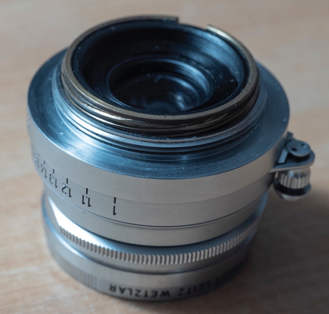

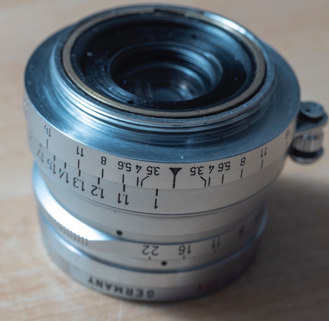

Due to lack of a 35mm LTM adapter, I have been using an adapter for my 'new' Summaron 35mm 3.5 that shows a 50mm frame in the OVF. Now I have ordered the same adapter with 35mm frame and find that the rangefinder coupling does not work properly at close range. For about the entire first third of the close-up range, nothing happens at all in the OVF. Another adapter from a different manufacturer behaves exactly the same. What could be the cause?
A problem I have seen is that the cut-out, the recess in its ‘swoosh’ form, could appear in a slight wrong place. Example. When my Nikkor-HC was adapted to be coupled below 1 meter this recess had to be slightly enlarged. At just below 1m the focus wheel will hitt the edge. Might this be a peoblem?
