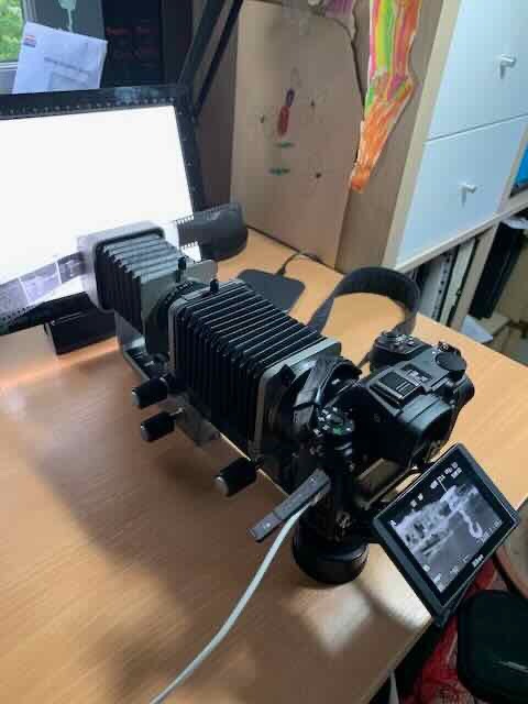

jgeenen Posted September 15, 2023 Share #9  Posted September 15, 2023 I started with a Minolta 5400 scanner for 35mm film and slides. Terribly slow and lots of issues with dust. Then I used an Epson P600 with negativ masks. Not much better. A macro lens attached to the camera was the best option so far. I started with a Novoflex bellows set with film duplicator. Very compact package but difficult to get all necessary parts on the used market (you need the bellows, a film holder, a bellows shade, a bellows macro lens 60mm (or 105? - I forgot), and some extension adaptor. Fiddly but well thought German Engineering. I am now planning to use my M11 for film scanning. Just bought a used macro lens with 1:1 option (I found a good Minolta Macro Rokkorr 3.5/55mm MD for a very reasonable price - other brands are equally good, but way more expensive (Leica Elmarit-R, Micro-Nikkor etc) or often heavily used) and a MD to M conversion adaptor (I start with a cheap Chinese one, if it works as intended I might switch to a better Novoflex adaptor). Combined with a LED light source, a negativ frame (you can use old enlarger plates) and some sort of rectangular stand (that's the most difficult step to get everything aligned properly) and you are done. A very cheap but interesting alternative I never tested is to get one of the old slide and film duplicators produced by Soligor and some other companies in the 80s. You get them for little money. Haven't tried it yet, so don't know about quality - but setup would be easy. Johannes 1 Link to post Share on other sites More sharing options...
