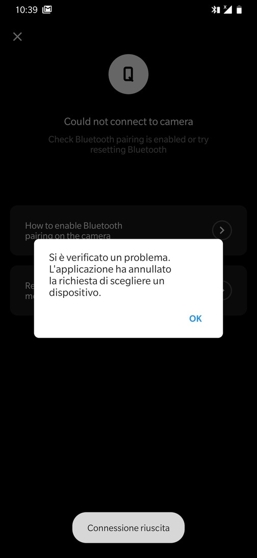

Mr.Lazza Posted July 21, 2020 Share #20 Posted July 21, 2020 Hi guys, regards from Vapolicella hills, Italy. Just trying to connect my new Q2 to Leica Fotos App. Camera Firmware 2.0 (the latest) Leica Fotos app version 2.1.1 (released July the 2nd) Smartphone OnePlus 6T, latest Oxygen OS version 10.3.4, latest Android 10 version I followed all suggestions, mobile data off included: simply no way to pair it! Just unbelievable... App detects the camera, aquire IP address and also confirms "successful connection", but final message says "App aborted the request to chose a device" There must be a conflict somewhere Welcome, dear visitor! As registered member you'd see an image here… Simply register for free here – We are always happy to welcome new members! Link to post Share on other sites Simply register for free here – We are always happy to welcome new members! ' data-webShareUrl='https://www.l-camera-forum.com/topic/380429-cant-connect-to-fotos-android/?do=findComment&comment=4012621'>More sharing options...
