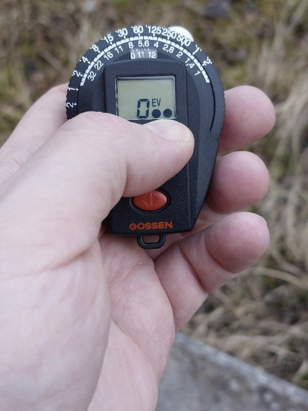

grahamc Posted January 18, 2023 Author Share #41  Posted January 18, 2023 Advertisement (gone after registration) 3 hours ago, Fotoklaus said: That´s why i prefer the Digisix "on the street": One Click and I got all the combinations of time/ aperture due to the EV range dial, without changing menues.  Welcome, dear visitor! As registered member you'd see an image here… Simply register for free here – We are always happy to welcome new members!  If you press and hold the "M"- Button and pan through your scene, you can read out the difference in lighting directly: I can do that all, including switching from direct to incident metering, with one hand within seconds. That´s the reason why my more "advanced" meters stay at home. That looks really useful.  At this point I’m choosing between Digisix and L-308 I think Link to post Share on other sites More sharing options...

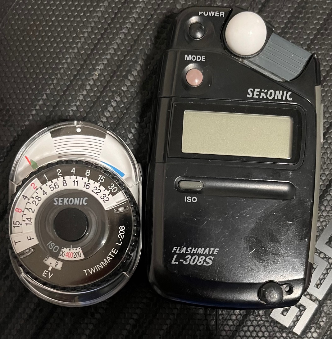

Jon Warwick Posted January 18, 2023 Share #42  Posted January 18, 2023 (edited) I like the 308 a lot, very compact, very simple, not clunky in use (better than the more flagship L858 spot meter I also owned IMHO in that regard).  I have the older 308 one which is shutter priority only (newer X one added aperture priority too). I use it only for incident readings, I find it pretty hard to tell what I was measuring in reflected mode. Edited January 18, 2023 by Jon Warwick 1 Link to post Share on other sites More sharing options...
grahamc Posted January 21, 2023 Author Share #43  Posted January 21, 2023 Update here : L-208 seems to have been edged out in favour of Digisix 2 or L-308 I’ve been leaning toward the Digisix, based on size - it does look super compact and handy. But the feedback on it eating batteries / not having an on/off switch is a worry.  How bad is this issue ... and are there workarounds? I presume the battery only drains if the meter is placed in conditions where buttons are being pressed ?! thanks. Link to post Share on other sites More sharing options...
madNbad Posted January 21, 2023 Share #44  Posted January 21, 2023 I tried using the Gossen case and it worked but kept catching on the short strap I was using. Some users have found little cases at thrift stores. The batteries are readily available and not very expensive, it’s just easier to carry a spare. If you do choose the Digisix, you won’t be disappointed. The battery life is variable between users but it will never last as long as the AA in the Sekonic and they don’t die as quickly as in the Reveni. The lack of a switch or auto off hasn’t presented any problems for me. The Digisix display is generally easy to read but some lighting can cause difficulty. The EV display is great and the dial give a wide range of exposure options. Changing ISO takes a few steps but working through the menu becomes instinctual quickly. The incident dome is a handy feature and slides into place with the flick of a finger. If you don’t need to read flash and just want something small, it’s a good choice. 1 Link to post Share on other sites More sharing options...

Fotoklaus Posted January 21, 2023 Share #51  Posted January 21, 2023 (edited) vor 3 Stunden schrieb grahamc: Also can I ask - do any of these shortlisted meters have an 'average' function for their reflective metering , that acts in a similar way to using a multi/average metering type function in-camera? On the Disgisix/ Digiflash you are able to pan through your scene holding the M-Button and read out the difference. The Sekonic is not able to do so, as far as I know. The Digisix has a measuring angle of about 25°, the 308 about 40° in direct metering mode. So you have to take care about that. Too much bright sky when holding the meter upwards, and so on. There might be some spotmeters which can calculate an average value out of several spot measurements but both the 308 and the Digisix don´t. Doesn´t make sense, by the way. But an incident measurement might be better than the best built in 3D-Matrix multi module of any camera.   Edited January 21, 2023 by Fotoklaus 2 Link to post Share on other sites More sharing options...

madNbad Posted January 21, 2023 Share #54  Posted January 21, 2023 (edited) The Digisix 2 is featured an excellent video from Silvergrain Classics that shows how to operate the meter, including using the averaging feature. It’s worth watching and may help answer a lot of your questions. As for learning to use the meter, that just takes practice. Both the Digisix and the Digiflash are the same size and close in price. https://www.youtube.com/watch?v=y1CDoH8ieaI Edited January 21, 2023 by madNbad 1 Link to post Share on other sites More sharing options...

lmans Posted January 22, 2023 Share #59  Posted January 22, 2023 I use the Twinmate L-208 when needed. I like it because this is pure analog again...no digits or lights or whatever. I usually need glasses to read and often do not have them on while photographing the streets. But this twin-mate has enough contrast between the "F" and 'shutter' that I can read it pretty easily without glasses, so that was a big one for me. Also, it is 'light'...plastic....small. I just keep it in my pocket instead of placing it around my neck with the strap. The only thing to watch out for is the ISO which might get accidentally moved. So just check it from time to time. Otherwise, nice product 5 Link to post Share on other sites More sharing options...
