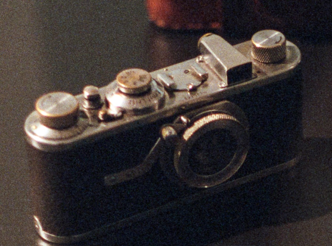

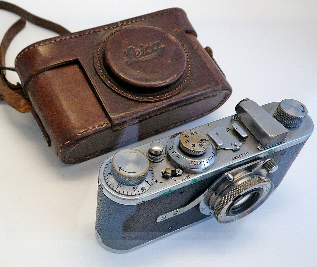

williamj Posted December 20, 2022 Author Share #18  Posted December 20, 2022 3 hours ago, Giuliobigazzi said: Does all his equipment actually still exsist as a collection? He donated cameras and lenses to many of his colleagues and they have been sold on. I know that his foundation in Paris has his first camera, there are photographs of it on the web. I have not been there so I can’t say what other equipment is on display, but I don’t think all of his cameras and lenses are in one place. Link to post Share on other sites More sharing options...
