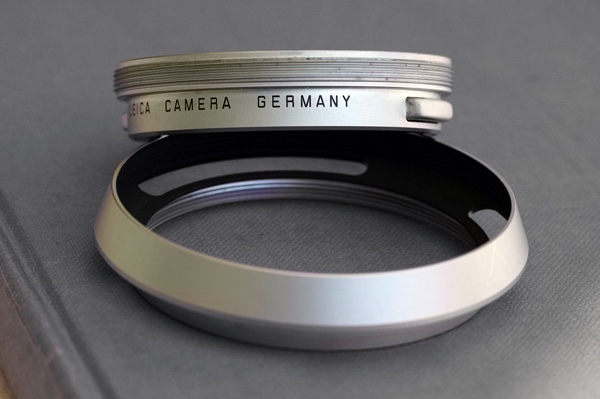

lct Posted December 10, 2022 Share #3 Posted December 10, 2022 (edited) 2 hours ago, grahamc said: Alternatively, is it possible that one of the Titans is just one piece like the silver chrome ? No idea but this silver one have two halves. Don't ask me more, it is not mine. To check yours, you may wish to put the hood upside down on a rubber surface (eg a rubber sole) and turn the hood anti clockwise while pressing it gently onto the rubber. May work perfectly... or not . Welcome, dear visitor! As registered member you'd see an image here… Simply register for free here – We are always happy to welcome new members! Edited December 10, 2022 by lct Link to post Share on other sites Simply register for free here – We are always happy to welcome new members! ' data-webShareUrl='https://www.l-camera-forum.com/topic/354598-12504-shape-hoods-2-piece-1-piece-variations-opening-tips/?do=findComment&comment=4595526'>More sharing options...

grahamc Posted December 11, 2022 Author Share #5 Posted December 11, 2022 58 minutes ago, lct said: No idea but this silver one have two halves. Don't ask me more, it is not mine. To check yours, you may wish to put the hood upside down on a rubber surface (eg a rubber sole) and turn the hood anti clockwise while pressing it gently onto the rubber. May work perfectly... or not . Welcome, dear visitor! As registered member you'd see an image here… Simply register for free here – We are always happy to welcome new members! Thanks LCT. I just read this after my previous reply just now. Ok I’ll keep going with the silver also just in case. Had read your rubber trick in other posts so have tried it, no luck so far but will keep going 👍 Link to post Share on other sites More sharing options...

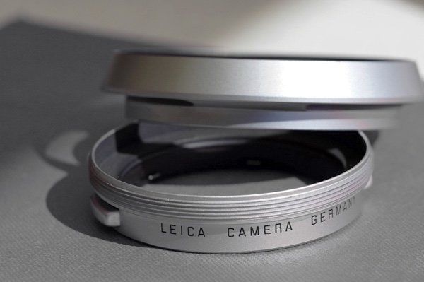

lifeandmylens Posted June 18, 2023 Share #18 Posted June 18, 2023 I'm here to piggyback on this thread. Anyone know what lens this hood might be for? It came with a 35 lux pre asph that I bought, and while it fits just fine, it is not the correct hood for that lens. It appears to be a newer 12504 type hood that doesnt separate to accommodate a filter. The writing however is in black (instead of white) that simply says Leica Camera Germany. All other similar hoods I've seen have white writing on them. Welcome, dear visitor! As registered member you'd see an image here… Simply register for free here – We are always happy to welcome new members! Link to post Share on other sites Simply register for free here – We are always happy to welcome new members! ' data-webShareUrl='https://www.l-camera-forum.com/topic/354598-12504-shape-hoods-2-piece-1-piece-variations-opening-tips/?do=findComment&comment=4796170'>More sharing options...
lct Posted June 18, 2023 Share #19 Posted June 18, 2023 (edited) Looks like a 12504 hood where a previous owner would erase the white paint the same way as i sometimes do. As for the stuck halves, you may wish to try the tip above just in case. Edited June 18, 2023 by lct 1 Link to post Share on other sites More sharing options...
