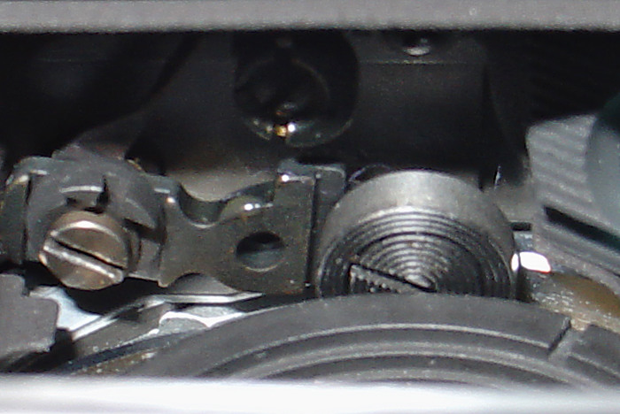

lct Posted August 30, 2022 Share #8 Posted August 30, 2022 Great lens on the M11. The lens does not touch anything into the body when retracting it but the tube is very close to the roller cam (on M6J below) so better keep the lens extended when mounting and removing it as usual. Welcome, dear visitor! As registered member you'd see an image here… Simply register for free here – We are always happy to welcome new members! 1 Link to post Share on other sites Simply register for free here – We are always happy to welcome new members! ' data-webShareUrl='https://www.l-camera-forum.com/topic/336119-m11-and-leica-elmar-m-5028-11823/?do=findComment&comment=4499746'>More sharing options...
Rva Posted August 30, 2022 Author Share #9 Posted August 30, 2022 1 hour ago, lct said: Great lens on the M11. The lens does not touch anything into the body when retracting it but the tube is very close to the roller cam (on M6J below) so better keep the lens extended when mounting and removing it as usual. Welcome, dear visitor! As registered member you'd see an image here… Simply register for free here – We are always happy to welcome new members! So once it is mounted I can collapse it without any worries. Right? Link to post Share on other sites More sharing options...
a.noctilux Posted August 30, 2022 Share #10 Posted August 30, 2022 14 minutes ago, Rva said: So once it is mounted I can collapse it without any worries. Right? YES. 2 Link to post Share on other sites More sharing options...
lct Posted August 30, 2022 Share #11 Posted August 30, 2022 57 minutes ago, a.noctilux said: YES. +1 1 Link to post Share on other sites More sharing options...
