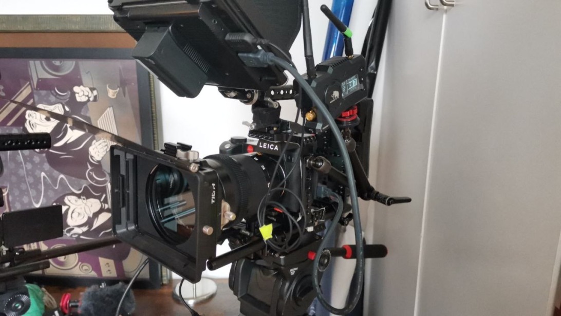

Slender Posted April 29, 2022 Share #29 Posted April 29, 2022 Welcome, dear visitor! As registered member you'd see an image here… Simply register for free here – We are always happy to welcome new members! Getting some Set flight hours today.... 4 Link to post Share on other sites Simply register for free here – We are always happy to welcome new members! Getting some Set flight hours today.... ' data-webShareUrl='https://www.l-camera-forum.com/topic/331608-new-video-opportunities-with-sl2s-and-ninja-v/?do=findComment&comment=4426693'>More sharing options...
hansvons Posted April 30, 2022 Share #30 Posted April 30, 2022 All the bells and whistles. Cool! 1 Link to post Share on other sites More sharing options...
Slender Posted April 30, 2022 Share #31 Posted April 30, 2022 Indeed that clearly is only ever needed for scripted fiction with a director monitor and crew...etc. Going "naked" with just a mic on top and using the EVF is also a very nice way to shoot for docu style.... Link to post Share on other sites More sharing options...

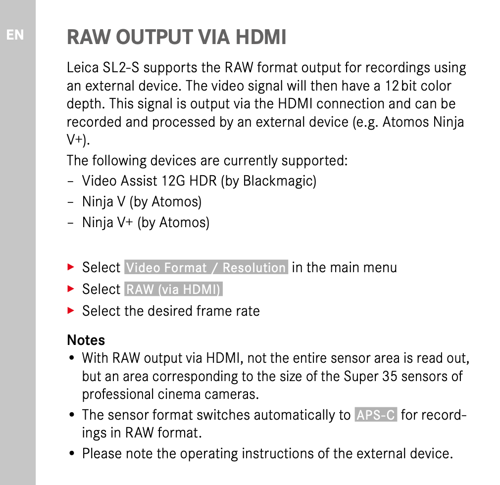

matted Posted May 5, 2022 Share #32 Posted May 5, 2022 (edited) It's official; download SL2-S firmware v3.0 here. Interesting that RAW is only supported in APS-C crop. I did not expect that, but I suppose it makes sense as the full sensor readout requires processing to down-res it. Welcome, dear visitor! As registered member you'd see an image here… Simply register for free here – We are always happy to welcome new members! Edited May 5, 2022 by matted 2 Link to post Share on other sites Simply register for free here – We are always happy to welcome new members! ' data-webShareUrl='https://www.l-camera-forum.com/topic/331608-new-video-opportunities-with-sl2s-and-ninja-v/?do=findComment&comment=4429642'>More sharing options...

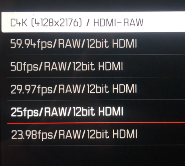

Aaron Daniel Posted May 5, 2022 Share #34 Posted May 5, 2022 Curious to see and hear everyones thoughts on this! Will be updating my camera and ninja tomorrow. For anyone who has done so already, what are the available frame rates while recording raw? Link to post Share on other sites More sharing options...
matted Posted May 5, 2022 Share #35 Posted May 5, 2022 11 minutes ago, Aaron Daniel said: Curious to see and hear everyones thoughts on this! Will be updating my camera and ninja tomorrow. For anyone who has done so already, what are the available frame rates while recording raw? Welcome, dear visitor! As registered member you'd see an image here… Simply register for free here – We are always happy to welcome new members! I do not have a Ninja, but these are the options once you have selected RAW. Curious that 24fps is not available… I would have thought that would be one of the premiere markets for this functionality. 1 Link to post Share on other sites Simply register for free here – We are always happy to welcome new members! I do not have a Ninja, but these are the options once you have selected RAW. Curious that 24fps is not available… I would have thought that would be one of the premiere markets for this functionality. ' data-webShareUrl='https://www.l-camera-forum.com/topic/331608-new-video-opportunities-with-sl2s-and-ninja-v/?do=findComment&comment=4429876'>More sharing options...
Jonathan Levin Posted May 5, 2022 Share #36 Posted May 5, 2022 Sort of confused. What is the frame rate of C4K? And 29.97 RAW, 1080?. Or is the white highlighted C4K the Name of that section and you chose FR i.e. 29.97. That must be it, no? Link to post Share on other sites More sharing options...
matted Posted May 5, 2022 Share #37 Posted May 5, 2022 (edited) 35 minutes ago, Jonathan Levin said: Sort of confused. What is the frame rate of C4K? And 29.97 RAW, 1080?. Or is the white highlighted C4K the Name of that section and you chose FR i.e. 29.97. That must be it, no? Yes, the white highlighted C4K is the “section” and the other lines are the available frame rates for C4K. Edited May 5, 2022 by matted Link to post Share on other sites More sharing options...
Shubee Posted May 8, 2022 Share #38 Posted May 8, 2022 (edited) 333 / 5 000 Hi, The manual states that "It is now possible to record a 12-bit RAW format with recorders such as the Atomos Ninja V, the Atomos Ninja V+ or a Blackmagic Video Assist 12G HDR". Is this an error with Blackmagic Video Assist? I don't think you can record in Blackmagic RAW from the SL2-S... Unfortunately. Edited May 8, 2022 by Shubee Link to post Share on other sites More sharing options...
