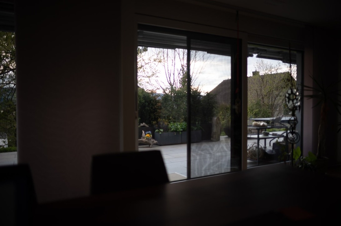

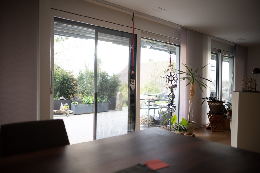

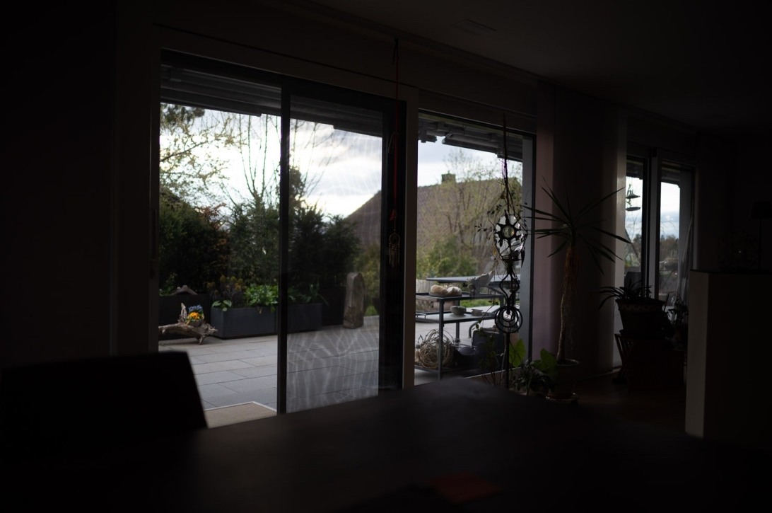

The new highlight weighted metering, to me, is counter intuitive in execution and I'm not sure it's working properly.
I've just returned from a walk in the dunes, and the highlight weighted metering completely overexposed some shots that had shadow detail in them. The image is so over exposed that I'm pretty sure the red channel must be clipped a bit but LR doesn't return any clipping warning... however pulling down the exposure doesn't result in the highlights retaining the same colour. First attached image (8237) is with highlight weighted metering. Second, (8237-2) is with -2.15 Exposure in LR. Third, (8238) is Multi segment metering with -1.7 stops dialled in on the camera.
The multi-segmented metering gets fooled extremely easily and I find the M10 had better (read more predictable) metering.
