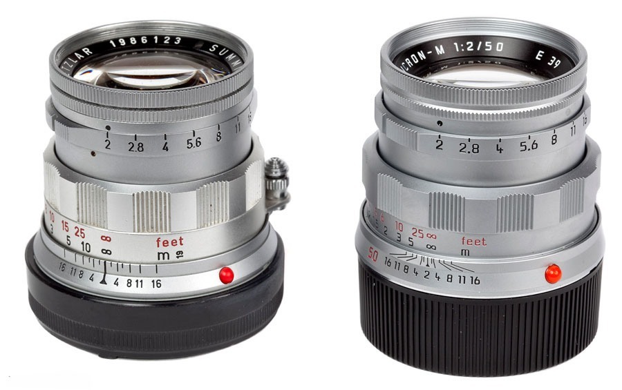

luigi bertolotti Posted February 20, 2022 Share #4 Posted February 20, 2022 (edited) As you say, is an interesting "transitional" Summicron, which can explain little oddities towards a "normal" rigid... the ring you evidence is indeed a bit thinner than usual... making the "spacing" to fit the dented hoods (ITDOO - IROOA) a bit wider... but not so much to have the hood "unstable", I think... As a side note... that thinner ring looks similar to the one made for the "50 years" edition 🙂 (see one hereunder, at right) Welcome, dear visitor! As registered member you'd see an image here… Simply register for free here – We are always happy to welcome new members! Edited February 20, 2022 by luigi bertolotti 1 Link to post Share on other sites Simply register for free here – We are always happy to welcome new members! ' data-webShareUrl='https://www.l-camera-forum.com/topic/329992-rigid-50mm-with-v3-batch-serial-number/?do=findComment&comment=4387649'>More sharing options...

luigi bertolotti Posted February 21, 2022 Share #6 Posted February 21, 2022 Well.. the "50 years" indeed is a different lens, though "disguised" as a rigid ☺️: it has the current lens' schema, has not the focusing knob, nor the unscrewable lenshead, 1 Link to post Share on other sites More sharing options...
