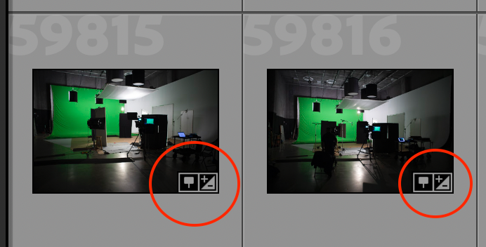

Tomek Posted January 29, 2022 Share #1 Posted January 29, 2022 Advertisement (gone after registration) I have had first day with the brand new M11. Small walking, few photos, and import to LRC via USB-C cable directly to MacOS (PTP protocol). Import from internal memory - no SD card installed Import dialog was not able to present pictures preview - just icons After import I see marks on each picture telling: +/- : editing done … but what editing? by what? The camera? for sure not LRC GPS location defined - fantastic: Gulf of Guinea. Of course total fake as pictures were taken in Cracow/Poland. This is obvious: there should be no GPS coordinates defined in the picture file. Any comments on the above? Link to post Share on other sites More sharing options...

digitalfx Posted January 30, 2022 Share #2 Posted January 30, 2022 USB-C import is not supported yet, it will happen with an update. Use your card to import and you will see previews like normal. GPS is also not enabled yet...need an update to fix the O data in coordinates. RE: The edit icon, ive noticed this too. I thought I did something, glad im not alone. BTW- you can report bugs in the FOTOS app...ill report these, id encourage you to do the same. 1 Link to post Share on other sites More sharing options...
Tomek Posted January 30, 2022 Author Share #3 Posted January 30, 2022 OK, but: why GPS coordinates are defined? They should be not instead showing fake location. Exactly like in M10 case also - why each file has "edited" mark when it was not touch by Development Module? Link to post Share on other sites More sharing options...
digitalfx Posted January 30, 2022 Share #4 Posted January 30, 2022 3 minutes ago, Tomek said: OK, but: why GPS coordinates are defined? They should be not instead showing fake location. Exactly like in M10 case also - why each file has "edited" mark when it was not touch by Development Module? The GPS data shows all zeros, so its not an actual location. Just ignore it...there is no GPS data currently. This will be fixed. same with edit icon...its clearly a bug. Link to post Share on other sites More sharing options...

elmars Posted January 30, 2022 Share #7 Posted January 30, 2022 Advertisement (gone after registration) vor 5 Stunden schrieb Tomek: +/- : editing done … but what editing? by what? The camera? for sure not LRC What profile is shown in LRC? If M11 profile and not Adobe color this may be the reason. Link to post Share on other sites More sharing options...
digitalfx Posted January 30, 2022 Share #8 Posted January 30, 2022 2 minutes ago, elmars said: What profile is shown in LRC? If M11 profile and not Adobe color this may be the reason. Yes they import with M11 Profile as default, and all images have the icon indicating they have been edited. Welcome, dear visitor! As registered member you'd see an image here… Simply register for free here – We are always happy to welcome new members! 2 Link to post Share on other sites Simply register for free here – We are always happy to welcome new members! ' data-webShareUrl='https://www.l-camera-forum.com/topic/329231-m11-what-i-see-after-import-to-lrc/?do=findComment&comment=4371815'>More sharing options...

Tomek Posted March 12, 2022 Author Share #19 Posted March 12, 2022 On 1/30/2022 at 6:06 AM, digitalfx said: Yes they import with M11 Profile as default, and all images have the icon indicating they have been edited. Welcome, dear visitor! As registered member you'd see an image here… Simply register for free here – We are always happy to welcome new members! Probably this is a little bit dummy question but I didn't find a way how to change the default profile for import. Any ideas? Link to post Share on other sites More sharing options...
Kwesi Posted March 12, 2022 Share #20 Posted March 12, 2022 https://helpx.adobe.com/lightroom-classic/help/photo-video-import-options.html Import using presets If you have certain configurations of import options that you reuse frequently, you can save them as presets to speed the import process. To create an import preset, specify import options and then chose Import Preset > Save Current Settings As New Preset at the bottom of the import window. To apply an import preset, select it from the Import Preset menu at the bottom of the import window, and click Import. To delete, update, or rename an import preset, select it in the Import Preset menu and then choose the appropriate command in the Import Preset menu. /content/dam/help/en/lightroom-classic/help/photo-video-import-options/jcr_content/main-pars/image_1572817033/import-preset.png.img.png Link to post Share on other sites More sharing options...
