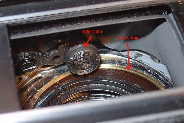

Of course an EVF-M would have auto image magnification for the simple reason that it would have an M mount hence the same roller cam (pic) as your and my M cameras have always had. As far as M lenses are concerned, it is a unique feature of M mount cameras and no mirrorless camera, be it Sony, Nikon, Canon or others, can compete with that.
The cam roller is part of the rangefinder mechanism, so it would not be there in its current form in an EVF-only M (no OVF -> no rangefinder -> no roller). But Leica could replace the roller with something else that senses cam movement for auto magnification purposes only.
However, this cam movement sensor could probably be as easily incorporated in a new version of the M to L adapter, which would then communicate the information to the body through the L mount electrical contacts. Remember that Leica is in full control of the L mount specification so they could add this "extension" as long as it does not affect other L manufacturers. So with this type of adapter and some software in the L mount body you would get the same auto magnification functionality as you get in the current M10 and M11.
Why could not the roller be kept separately? I don't understand this objection.
As already mentioned, in its current form it's an integral part of the rangefinder/OVF mechanism (see image above). But it could be replaced by something else sensing cam movement. And this should be doable in an adapter as well.
On M cameras, the roller cam is just fixed on an arm that moves around an axis near the camera mount. I don't see why these parts could not be kept in the EVF-M.
Why are you so fixed on keeping the existing roller cam? Any simple device or microswitch that detects movement of the focus cam of the lens is fine to trigger your beloved automatic focus magnification and will do the job.

Of course having EVF with a cam would be possible, but why? I assume a dedicated not hybrid machine. Then are looking at a screen - not through a stage binocular. So what would the position of the cam convey to that screen?
The same as it does currently with electronic Visoflexes.

A rollercam without the attached rangefinder mechanism doesn't exist either, so it will require additional R&D to mount it in the camera "solo". So wether you like it or not, the "winning team" will have to be changed.
And while we're at it, "changing a winning team" by removing the entire viewfinder/rangefinder and replacing it with an EVF seems to be fine by you, but heaven forbid to remove the  rollercam (which is an integral part of the removed viewfinder/rangefinder) because that part seems too sacred and good to consider another viable solution.
And btw, this whole discussion about an EVF M-mount camera is purely academic and theoretical and such a camera doesn't exist today and has never existed, so I don't see the difference why that's a fair topic for discussion but changing the rollercam to something different is suddenly too difficult to discuss.
The difference is your adapter does not exist and never existed whereas the roller cam does exist since the fifties and works fine since then so the question i'm interested in is could the roller cam be used for the EVF-M or not.
