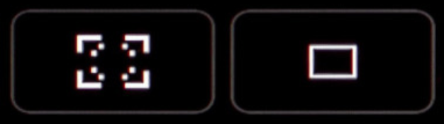

Ronaldraw Posted June 28, 2021 Share #1 Posted June 28, 2021 Advertisement (gone after registration) When I go to favorites in the menu than I do not see a difference between Exposure and Af icoon. Would be nice to see the name of the topic in the menu. But maybe I see it not correct. Welcome, dear visitor! As registered member you'd see an image here… Simply register for free here – We are always happy to welcome new members! Link to post Share on other sites Simply register for free here – We are always happy to welcome new members! ' data-webShareUrl='https://www.l-camera-forum.com/topic/322234-exposure-vs-af-in-menu/?do=findComment&comment=4227937'>More sharing options...

acg69 Posted June 28, 2021 Share #2 Posted June 28, 2021 I am not sure what you mean. Could you please explain? Link to post Share on other sites More sharing options...
Ronaldraw Posted June 28, 2021 Author Share #3 Posted June 28, 2021 1 minute ago, acg69 said: I am not sure what you mean. Could you please explain? When you look at the menu in this picture than I don't see what exposure or AF is Link to post Share on other sites More sharing options...
acg69 Posted June 28, 2021 Share #4 Posted June 28, 2021 AF is Single (AFS) with Face Recognition (icon to the right of AFS) and exposure is f/3.2 and 1/50 (aperture and shutter speed respectively). Link to post Share on other sites More sharing options...
djcphoto Posted June 28, 2021 Share #5 Posted June 28, 2021 (edited) I think the OP is referring to the fact the the icon for exposure pattern (spot, etc) and AF pattern (single point, etc.) are very similar. It also threw me for a minute until I got used to it. Edited June 28, 2021 by djcphoto Clarity, hopefully. Link to post Share on other sites More sharing options...
Ronaldraw Posted June 28, 2021 Author Share #6 Posted June 28, 2021 Just now, djcphoto said: I think the OP is referring to the fact the the icon for exposure mode (spot, etc) and AF mode (single point, etc.) are very similar. It also threw me for a minute until I got used to it. It's confusing For me as a new Leica owner Link to post Share on other sites More sharing options...
marchyman Posted June 28, 2021 Share #7 Posted June 28, 2021 Advertisement (gone after registration) These (which I assume is what your post was about) are different icons. Welcome, dear visitor! As registered member you'd see an image here… Simply register for free here – We are always happy to welcome new members! The one on the left is Auto focus mode, currently set to Multi-Field. The various icons that can be displayed there are on page 61 in your manual. The one of the right is, I believe Drive mode. The icon in the lower left corner of your screen shot is Exposure metering mode. But, yeah... I prefer words to icons, too. Link to post Share on other sites Simply register for free here – We are always happy to welcome new members! The one on the left is Auto focus mode, currently set to Multi-Field. The various icons that can be displayed there are on page 61 in your manual. The one of the right is, I believe Drive mode. The icon in the lower left corner of your screen shot is Exposure metering mode. But, yeah... I prefer words to icons, too. ' data-webShareUrl='https://www.l-camera-forum.com/topic/322234-exposure-vs-af-in-menu/?do=findComment&comment=4228004'>More sharing options...
Ronaldraw Posted June 28, 2021 Author Share #8 Posted June 28, 2021 2 minutes ago, marchyman said: These (which I assume is what your post was about) are different icons. Welcome, dear visitor! As registered member you'd see an image here… Simply register for free here – We are always happy to welcome new members! The one on the left is Auto focus mode, currently set to Multi-Field. The various icons that can be displayed there are on page 61 in your manual. The one of the right is, I believe Drive mode. The icon in the lower left corner of your screen shot is Exposure metering mode. But, yeah... I prefer words to icons, too. Thank you for the informations. Yes names would be easier Link to post Share on other sites More sharing options...
Ronaldraw Posted June 28, 2021 Author Share #9 Posted June 28, 2021 Af and exposure button Welcome, dear visitor! As registered member you'd see an image here… Simply register for free here – We are always happy to welcome new members! Link to post Share on other sites Simply register for free here – We are always happy to welcome new members! ' data-webShareUrl='https://www.l-camera-forum.com/topic/322234-exposure-vs-af-in-menu/?do=findComment&comment=4228031'>More sharing options...
Ronaldraw Posted July 1, 2021 Author Share #10 Posted July 1, 2021 When I chose for the exposure for Multi-Field, should I chose for AF also for Multi-Field? So AF should be the as Exposure? Link to post Share on other sites More sharing options...
marchyman Posted July 1, 2021 Share #11 Posted July 1, 2021 You seem to be conflating two different features into one. Focus: what part of the viewfinder is used to select the focus point Exposure: What part of the viewfinder is used to select exposure. I prefer the term "metering mode" to exposure. Exposure is ISO, Shutter speed, and Aperture. Anyway, focus mode and metering mode are different things. I may well use matrix metering mode and face detection focus mode when trying to capture grandkids running around the yard. I might choose spot metering where something is back lit and I don't care if the background is blown out. I tend to keep focus mode on center and metering mode on center weighted because that is closest to what I get when using my M. It makes switching between the two cameras easier. But I don't always use those modes. 1 Link to post Share on other sites More sharing options...
