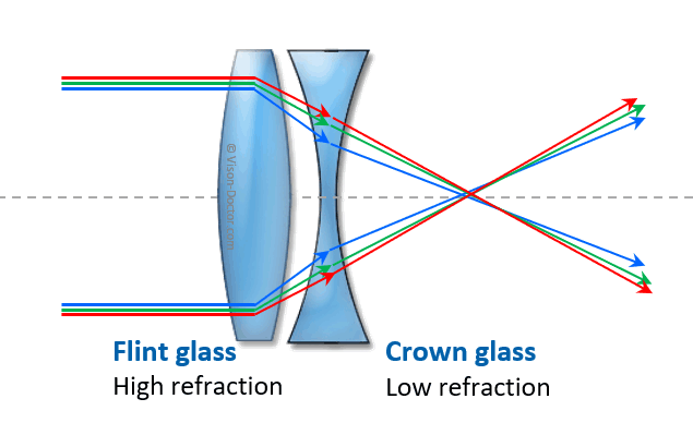

farnz Posted May 16, 2021 Share #10  Posted May 16, 2021 3 hours ago, LarsHP said: The LoCA is mosly seen in the plains, but also in the island in the background. There is just a touch in the branches, which is acceptably weak and easily fixed in editing, but the snow-earth transitions in the far background has loads of green and purple. I even used a Zeiss UV filter which cuts sharply at 410nm, so there's no UV light "pollution" causing purple fringing. Apochromatic lenses are designed to precisely overlay three wavelengths (usually in the red, green, and blue wavebands) in the plane of focus. But the plains and island that you mention are in out of focus areas where it's not reasonable to expect the three wavelengths to coincide perfectly owing to chromatic dispersion, ie the difference in the velocity of propagation of different wavelengths through glass. The three colours will travel through the lens differently so when the rays pass the plane of focus they will spread differently and not coincide precisely in the out of focus areas. Pete. 9 4 Link to post Share on other sites More sharing options...

LarsHP Posted May 16, 2021 Author Share #12  Posted May 16, 2021 7 hours ago, farnz said: Apochromatic lenses are designed to precisely overlay three wavelengths (usually in the red, green, and blue wavebands) in the plane of focus. But the plains and island that you mention are in out of focus areas where it's not reasonable to expect the three wavelengths to coincide perfectly owing to chromatic dispersion, ie the difference in the velocity of propagation of different wavelengths through glass. The three colours will travel through the lens differently so when the rays pass the plane of focus they will spread differently and not coincide precisely in the out of focus areas. Pete. You are of course totally right that the apo designation is about the point of focus. However, the apochromatic correction usually translate into out of focus areas that are free of color fringing (LoCA) or at least has greatly reduced it. To me, that's the sign of a proper apochromatic lens. My Voigtländer 180mm Apo-Lanthar SL and Coastal Optical UV-VIS-IR 60mm Apo Macro performs like that. They are both f/4 lenses though. Still, the Voigtländer 65mm f/2 Apo-Lanthar and Nikon AF-S Nikkor 200mm f/2 VR are just as fast as the 90mm Apo-Summicron-M and they don't have any color fringing in the out of focus areas = very well controlled LoCA. So, to me it was a considerable disappointment to see the amount of green and purple in the out of focus area in the image I just posted. I was aware that the 90mm Apo-Summicron-M wasn't perfect regarding LoCA, but this was just so much that I couldn't believe that Leica had the guts to call the lens apochromatic. If Leica just called it "aspherical", then I wouldn't be that disappointed. 1 1 Link to post Share on other sites More sharing options...

farnz Posted May 16, 2021 Share #18  Posted May 16, 2021 1 hour ago, LarsHP said: I was aware that the 90mm Apo-Summicron-M wasn't perfect regarding LoCA, but this was just so much that I couldn't believe that Leica had the guts to call the lens apochromatic. I've explained that apochromaticity only relates to the plane of focus, which you accepted, and you didn't complain about LoCA around the elements in your image that are in focus so I'm left to assume there was none. Therefore Leica is thoroughly entitled to describe it as an apochromatic lens firstly because it shows no LoCA in the plane of focus and secondly because the lens includes low-dispersion lens elements for the purpose of correcting for chromatic aberrations. LoCA in out of focus areas is explained in my previous post. The fact that your Voigtlander and Nikon lenses don't show colour fringing in out of focus areas is irrelevant because Voigtlander's and Nikon's design propositions, processes, and objectives are proprietary to them and inevitably different from Leica's so it makes little sense to compare them. Please note that the 90/2 APO-Summicron asph was first released in 1998 so its design will be 24 or 25 years old whereas (I assume) that the design of your Voigtlander and Nikon lenses are much later and therefore in a position to benefit from knowledge gained and modern material science that wasn't available when the Summicron was designed so it seems pointless to me to draw comparison. To illustrate why 'all bets are off' with respect to LoCA in out of focus areas please note the diagram below showing corrected LoCA (credit: vision-doctor.com) where the rays clearly diverge after the plane of focus so any 'coincidence errors' in wavelengths will be exaggerated the further the rays travel. Pete. Welcome, dear visitor! As registered member you'd see an image here… Simply register for free here – We are always happy to welcome new members! 2 2 Link to post Share on other sites Simply register for free here – We are always happy to welcome new members! ' data-webShareUrl='https://www.l-camera-forum.com/topic/320955-90mm-apo-summicron-m-not-apochromatic/?do=findComment&comment=4201807'>More sharing options...
