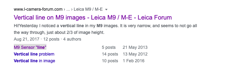

D A V I D Posted January 16, 2021 Author Share #2 Posted January 16, 2021 Oh, just found out I am not the only one.... case closed. Camera goes back. Welcome, dear visitor! As registered member you'd see an image here… Simply register for free here – We are always happy to welcome new members! 1 Link to post Share on other sites Simply register for free here – We are always happy to welcome new members! ' data-webShareUrl='https://www.l-camera-forum.com/topic/317048-vertical-lines/?do=findComment&comment=4119560'>More sharing options...
