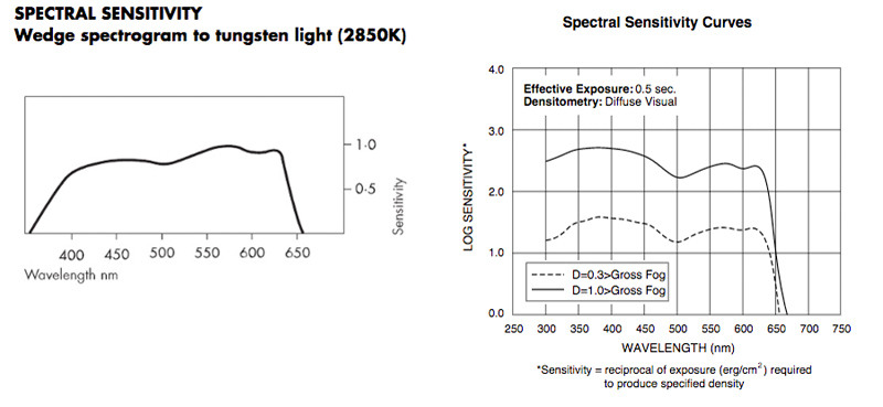

adan Posted October 20, 2020 Share #17 Posted October 20, 2020 It is the case that most human skin tones are some shade or tint of orange (broadly speaking, with diversions to the yellow or red either side, and a wide range of brightnesses, from very dark to very pale)). Samples taken from a crowd picture of mixed races: Welcome, dear visitor! As registered member you'd see an image here… Simply register for free here – We are always happy to welcome new members! It is also the case that many B&W films are often relatively sensitive to reds - so that they retain approximately the same "ISO" under the reddish-yellow light of classic tungsten light sources. But not all - the film chemists can adjust that any way they please, with color sensitization dyes (yes, even in B&W film). Here are a couple of spectral sensitivity curves for the old standbys HP5+ and Tri-X. The base orange skin hues will be a narrow band from about 580-630nm. Now for comparison, here is the spectral response of the M246 sensor, as calculated (not tested) by Leica. It has a steep drop in response in the range including 580-630 - those colors (including skin colors) will reproduce darker than with B&W film. Especially relative to the overall peak response at 530nm (greens) A high peak in green is a fair representation of the physical response of human vision. However, the psychological response is different - we tend to notice reds/oranges rather strongly, as an evolved response to danger (fires, flowing blood, etc.). This is why red and orange are used as warnings and alerts, from safety clothing to traffic signs ⛔ to cockpit warning lights. Or even lipstick (it gets your attention, doesn't it? ). And even fruit that needs to be eaten to have its seeds widely distributed in - well - poop. And thus evolves to attract primate eyes. Anyway - when color digital images are desaturated, there are more, or less, sophisticated algorithms for converting colors to grayscale brightnesses. Below shows a picture with skin-tone-like hues (pinks/oranges/yellows), as converted to monochrome by: Adobe Camera Raw defaults (left) and simple Desaturation in Photoshop (right). it not only demonstrates the variability of conversion algorithms, but also my previous point about how we perceive warm colors - they always tend to convert numerically somewhat darker than our brains tell us they should. Yellow and orange scream at us - an equally bright gray does not. So we have to take account of these factors in pursuing the skin tones we desire. With B&W films/cameras - check the specific spectral response in its data sheet. With color conversions, there are a variety of approaches in software. Among others, the image color brightnesses can be increased (or decreased) using the per-color HSL (hue/saturation/lightness) controls for reds, oranges and yellows. Available in LR and ACR,'s basic "developoing" controls, as well as in the basic Saturation/Hue dialogue box of Photoshop. 9 3 Link to post Share on other sites Simply register for free here – We are always happy to welcome new members! It is also the case that many B&W films are often relatively sensitive to reds - so that they retain approximately the same "ISO" under the reddish-yellow light of classic tungsten light sources. But not all - the film chemists can adjust that any way they please, with color sensitization dyes (yes, even in B&W film). Here are a couple of spectral sensitivity curves for the old standbys HP5+ and Tri-X. The base orange skin hues will be a narrow band from about 580-630nm. Now for comparison, here is the spectral response of the M246 sensor, as calculated (not tested) by Leica. It has a steep drop in response in the range including 580-630 - those colors (including skin colors) will reproduce darker than with B&W film. Especially relative to the overall peak response at 530nm (greens) A high peak in green is a fair representation of the physical response of human vision. However, the psychological response is different - we tend to notice reds/oranges rather strongly, as an evolved response to danger (fires, flowing blood, etc.). This is why red and orange are used as warnings and alerts, from safety clothing to traffic signs ⛔ to cockpit warning lights. Or even lipstick (it gets your attention, doesn't it? ). And even fruit that needs to be eaten to have its seeds widely distributed in - well - poop. And thus evolves to attract primate eyes. Anyway - when color digital images are desaturated, there are more, or less, sophisticated algorithms for converting colors to grayscale brightnesses. Below shows a picture with skin-tone-like hues (pinks/oranges/yellows), as converted to monochrome by: Adobe Camera Raw defaults (left) and simple Desaturation in Photoshop (right). it not only demonstrates the variability of conversion algorithms, but also my previous point about how we perceive warm colors - they always tend to convert numerically somewhat darker than our brains tell us they should. Yellow and orange scream at us - an equally bright gray does not. So we have to take account of these factors in pursuing the skin tones we desire. With B&W films/cameras - check the specific spectral response in its data sheet. With color conversions, there are a variety of approaches in software. Among others, the image color brightnesses can be increased (or decreased) using the per-color HSL (hue/saturation/lightness) controls for reds, oranges and yellows. Available in LR and ACR,'s basic "developoing" controls, as well as in the basic Saturation/Hue dialogue box of Photoshop. ' data-webShareUrl='https://www.l-camera-forum.com/topic/314272-how-to-get-skin-tone-like-classical-bw-film/?do=findComment&comment=4065909'>More sharing options...

Einst_Stein Posted October 21, 2020 Author Share #19 Posted October 21, 2020 3 hours ago, adan said: It is the case that most human skin tones are some shade or tint of orange (broadly speaking, with diversions to the yellow or red either side, and a wide range of brightnesses, from very dark to very pale)). Samples taken from a crowd picture of mixed races: Welcome, dear visitor! As registered member you'd see an image here… Simply register for free here – We are always happy to welcome new members! It is also the case that many B&W films are often relatively sensitive to reds - so that they retain approximately the same "ISO" under the reddish-yellow light of classic tungsten light sources. But not all - the film chemists can adjust that any way they please, with color sensitization dyes (yes, even in B&W film). Here are a couple of spectral sensitivity curves for the old standbys HP5+ and Tri-X. The base orange skin hues will be a narrow band from about 580-630nm. Now for comparison, here is the spectral response of the M246 sensor, as calculated (not tested) by Leica. It has a steep drop in response in the range including 580-630 - those colors (including skin colors) will reproduce darker than with B&W film. Especially relative to the overall peak response at 530nm (greens) A high peak in green is a fair representation of the physical response of human vision. However, the psychological response is different - we tend to notice reds/oranges rather strongly, as an evolved response to danger (fires, flowing blood, etc.). This is why red and orange are used as warnings and alerts, from safety clothing to traffic signs ⛔ to cockpit warning lights. Or even lipstick (it gets your attention, doesn't it? ). And even fruit that needs to be eaten to have its seeds widely distributed in - well - poop. And thus evolves to attract primate eyes. Anyway - when color digital images are desaturated, there are more, or less, sophisticated algorithms for converting colors to grayscale brightnesses. Below shows a picture with skin-tone-like hues (pinks/oranges/yellows), as converted to monochrome by: Adobe Camera Raw defaults (left) and simple Desaturation in Photoshop (right). it not only demonstrates the variability of conversion algorithms, but also my previous point about how we perceive warm colors - they always tend to convert numerically somewhat darker than our brains tell us they should. Yellow and orange scream at us - an equally bright gray does not. So we have to take account of these factors in pursuing the skin tones we desire. With B&W films/cameras - check the specific spectral response in its data sheet. With color conversions, there are a variety of approaches in software. Among others, the image color brightnesses can be increased (or decreased) using the per-color HSL (hue/saturation/lightness) controls for reds, oranges and yellows. Available in LR and ACR,'s basic "developoing" controls, as well as in the basic Saturation/Hue dialogue box of Photoshop. Thanks a lot. This is very rich informative. I am yet to fully digest it. I do find that shooting in color and converting to B&W with fine-tuning 6 color channels the most satisfactory (to me). But it only works on landscape. Doing the same thing on portraits makes them unpleasant. It is much intrusive than doing the same thing on landscape. But I am lost why Leica direct monochrome is more preferred by experts the color converted B&W. Yes, I know Leica direct monochrome has better sensitivity due to the removal of color filter. It also has much higher effective resolution. But what about the tonal rendering? Link to post Share on other sites More sharing options...
Einst_Stein Posted October 21, 2020 Author Share #20 Posted October 21, 2020 4 hours ago, adan said: It is the case that most human skin tones are some shade or tint of orange (broadly speaking, with diversions to the yellow or red either side, and a wide range of brightnesses, from very dark to very pale)). Samples taken from a crowd picture of mixed races: Welcome, dear visitor! As registered member you'd see an image here… Simply register for free here – We are always happy to welcome new members! It is also the case that many B&W films are often relatively sensitive to reds - so that they retain approximately the same "ISO" under the reddish-yellow light of classic tungsten light sources. But not all - the film chemists can adjust that any way they please, with color sensitization dyes (yes, even in B&W film). Here are a couple of spectral sensitivity curves for the old standbys HP5+ and Tri-X. The base orange skin hues will be a narrow band from about 580-630nm. Now for comparison, here is the spectral response of the M246 sensor, as calculated (not tested) by Leica. It has a steep drop in response in the range including 580-630 - those colors (including skin colors) will reproduce darker than with B&W film. Especially relative to the overall peak response at 530nm (greens) A high peak in green is a fair representation of the physical response of human vision. However, the psychological response is different - we tend to notice reds/oranges rather strongly, as an evolved response to danger (fires, flowing blood, etc.). This is why red and orange are used as warnings and alerts, from safety clothing to traffic signs ⛔ to cockpit warning lights. Or even lipstick (it gets your attention, doesn't it? ). And even fruit that needs to be eaten to have its seeds widely distributed in - well - poop. And thus evolves to attract primate eyes. Anyway - when color digital images are desaturated, there are more, or less, sophisticated algorithms for converting colors to grayscale brightnesses. Below shows a picture with skin-tone-like hues (pinks/oranges/yellows), as converted to monochrome by: Adobe Camera Raw defaults (left) and simple Desaturation in Photoshop (right). it not only demonstrates the variability of conversion algorithms, but also my previous point about how we perceive warm colors - they always tend to convert numerically somewhat darker than our brains tell us they should. Yellow and orange scream at us - an equally bright gray does not. So we have to take account of these factors in pursuing the skin tones we desire. With B&W films/cameras - check the specific spectral response in its data sheet. With color conversions, there are a variety of approaches in software. Among others, the image color brightnesses can be increased (or decreased) using the per-color HSL (hue/saturation/lightness) controls for reds, oranges and yellows. Available in LR and ACR,'s basic "developoing" controls, as well as in the basic Saturation/Hue dialogue box of Photoshop. A further comparison of spectral sensitivity between the film and the digital sensor suggests to simulate the film, the digital camera needs the color filter to enhance both the red end (300!~530) as well as the violet end (580~630), or equivalently, to push down the mid region (I450-600). But it is almost impossible to get the proper color filter with the equivalent spectral shape. So the only practical method is to match it meticulously through the 6-color channel equalizer (in LR), when desired and when it makes sense. Link to post Share on other sites More sharing options...
