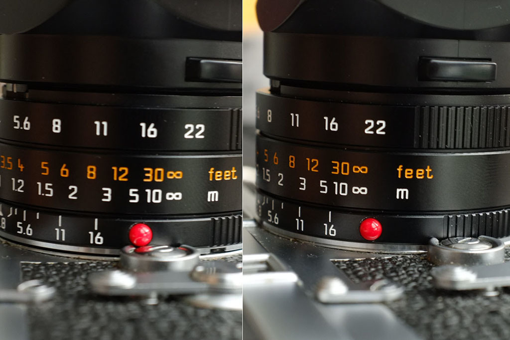

a.noctilux Posted September 21, 2020 Share #3 Posted September 21, 2020 (edited) Same problem, like here https://www.l-camera-forum.com/topic/127042-leica-28mm-f28-elmarit-m-asph-thoughts/?do=findComment&comment=2400581 When I want to mount the Elmarit-M 28 asph. on my M3, the red dot fell, touching the release button, so to use this lens on my M3, red dot must be deleted. Welcome, dear visitor! As registered member you'd see an image here… Simply register for free here – We are always happy to welcome new members! photos of Dikaiosune01 Some later M (comprise M3 ! ) have smaller/shorter release button part, so this can be shaved a bit if need be. I have not done the modification, just had the red dot deleted. Edited September 21, 2020 by a.noctilux 1 Link to post Share on other sites Simply register for free here – We are always happy to welcome new members! photos of Dikaiosune01 Some later M (comprise M3 ! ) have smaller/shorter release button part, so this can be shaved a bit if need be. I have not done the modification, just had the red dot deleted. ' data-webShareUrl='https://www.l-camera-forum.com/topic/313522-m3-and-modern-elmar-28mm/?do=findComment&comment=4049809'>More sharing options...

raizans Posted September 24, 2020 Share #17 Posted September 24, 2020 Some M3 have a lens release button and shroud with less clearance than others. https://rangefinderforum.com/forums/showpost.php?p=2965002&postcount=2102 from MaZo: Welcome, dear visitor! As registered member you'd see an image here… Simply register for free here – We are always happy to welcome new members! 1 Link to post Share on other sites Simply register for free here – We are always happy to welcome new members! ' data-webShareUrl='https://www.l-camera-forum.com/topic/313522-m3-and-modern-elmar-28mm/?do=findComment&comment=4051241'>More sharing options...
