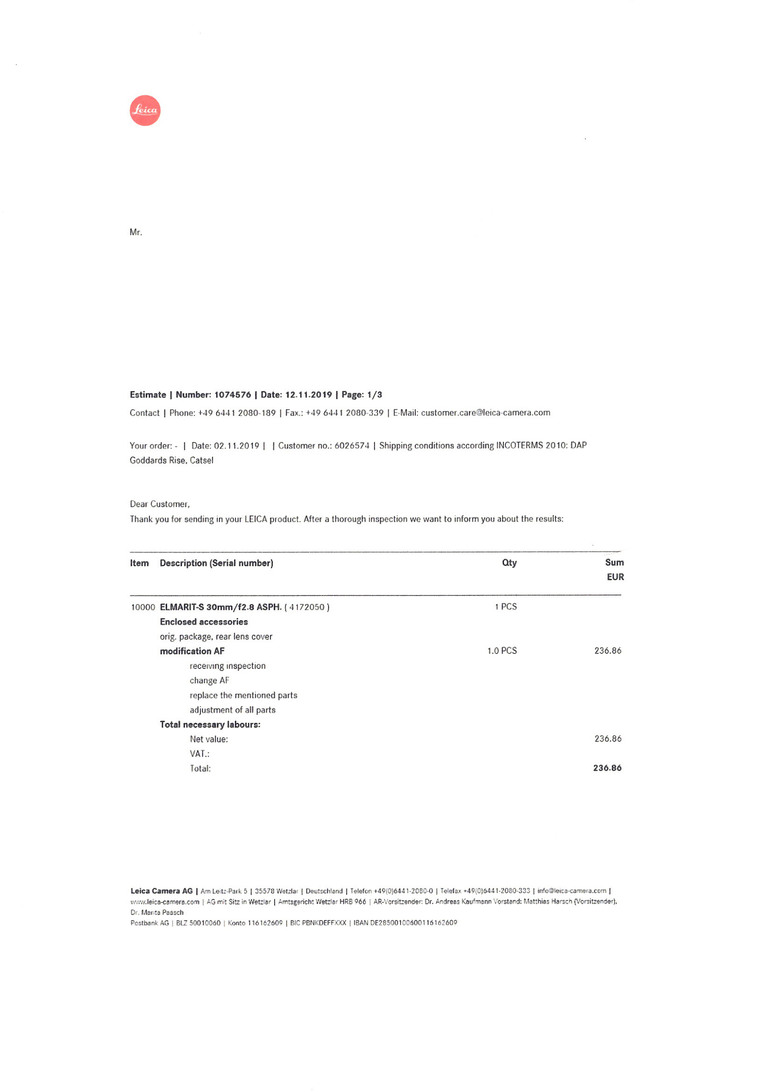

AHPZuazua Posted September 9, 2021 Share #31 Posted September 9, 2021 Hello. I have an S2 and no lens. Is the 70 without upgrade lens ok to buy. How much is the price for new AF in the 70? Link to post Share on other sites More sharing options...
helged Posted September 9, 2021 Share #32 Posted September 9, 2021 2 hours ago, AHPZuazua said: Hello. I have an S2 and no lens. Is the 70 without upgrade lens ok to buy. How much is the price for new AF in the 70? See post #3 above regarding price for new AF motor. The S70 is (relatively) small and light, it renders nicely without being optically perfect - and it is highly recommended. It would be wise to include the cost of eventual af repair when considering buying a used lens with old/original af motor. Link to post Share on other sites More sharing options...
AHPZuazua Posted September 9, 2021 Share #33 Posted September 9, 2021 56 minutes ago, helged said: See post #3 above regarding price for new AF motor. The S70 is (relatively) small and light, it renders nicely without being optically perfect - and it is highly recommended. It would be wise to include the cost of eventual af repair when considering buying a used lens with old/original af motor. Hello. Thank you for the reply. I did not see a price for a 70 repair. I saw one for S-30 a few years back from approx 230 non USD. I was asking for a 70. Are you saying the price is the same regardless of the lens. Link to post Share on other sites More sharing options...
ropo54 Posted September 9, 2021 Share #34 Posted September 9, 2021 My Leica prophylactic replacement of the lens motors for S 70, S100, S120, S180 each cost $285 USD, April 2021. My S24 was $325. (I do not know why there was a price difference for the S24). The lenses were working fine, but I figured it was a good time to send in several S lenses because of covid lockdowns. 1 Link to post Share on other sites More sharing options...
darylgo Posted September 9, 2021 Share #35 Posted September 9, 2021 1 hour ago, ropo54 said: My Leica prophylactic replacement of the lens motors for S 70, S100, S120, S180 each cost $285 USD, April 2021. My S24 was $325. (I do not know why there was a price difference for the S24). The lenses were working fine, but I figured it was a good time to send in several S lenses because of covid lockdowns. Who did you send them through? Iirc my lens was $400, so perhaps there’s shipping charges applied. 1 Link to post Share on other sites More sharing options...
AHPZuazua Posted September 9, 2021 Share #36 Posted September 9, 2021 19 minutes ago, darylgo said: Who did you send them through? Iirc my lens was $400, so perhaps there’s shipping charges applied. Thank you for this prices. Are these current. This year. Link to post Share on other sites More sharing options...
ropo54 Posted September 9, 2021 Share #37 Posted September 9, 2021 (edited) 1 hour ago, darylgo said: Who did you send them through? Iirc my lens was $400, so perhaps there’s shipping charges applied. DarylGo: The lenses were sent to Leica in February 2021 and returned in April and May 2021. At the outset, Leica NJ sent me shipping labels (FedEx), but I believe that I absorbed the shipping costs to NJ. Once in NJ and "looked at" , they were forwarded to Germany for the "repair". A repair estimate was provided before the work was done, and once completed, payment was made by credit card. Germany returned them to NJ, and they were returned to me in Florida. They came back piecemeal, as each lens was completed; it was not a bulk return. No charges were involved in the return to me. Rob Edited September 9, 2021 by ropo54 1 Link to post Share on other sites More sharing options...
mgrayson3 Posted September 9, 2021 Share #38 Posted September 9, 2021 I handed my lenses to Leica Store SoHo. They handled all shipping. I paid them about $285 per lens. It took about 6 weeks. I used Contax lenses with adapter in the interim. Matt 1 Link to post Share on other sites More sharing options...
