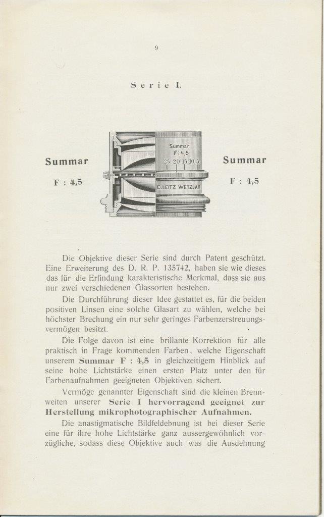

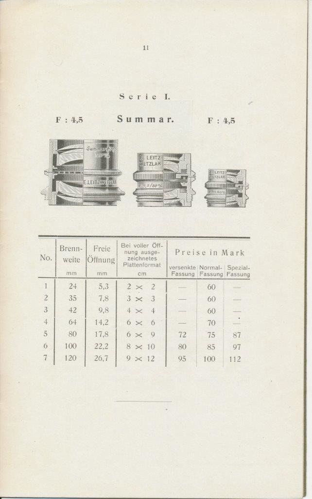

Michal Kosakowski Posted November 30, 2023 Share #32 Posted November 30, 2023 Am 24.4.2020 um 17:57 schrieb thomas_schertel: Mr. Claus Walter sent me some informations to the Summar and allowed me, to post them here: "Soeben ist mir im Leica-Forum aufgefallen, daß es ein Thema rund um ein Summar 120 gibt. Da kann ich etwas dazu beitragen. Es ist bis 9x12 verwendbar, nicht nur im Nahbereich. Anbei ein paar Seiten aus einem Katalog. Die Objektive gab es am Anfang nur im Messing, so ab 1920 nur noch in schwarz." My translation: I have seen in the forum, that there is a theme dealing with the Summar 120. I can contribute something. It is useable um to 9 x 12, not only for close focus. Attached are some pages of the catalogue. The frist lenses in the beginnig were in brass, since 1920 in black. Welcome, dear visitor! As registered member you'd see an image here… Simply register for free here – We are always happy to welcome new members! yours sincerely Thomas Hi Thomas, I know I am answering on an older post, but perhaps you have full scans of this brochure? Best Michal Link to post Share on other sites More sharing options...
