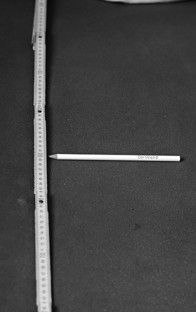

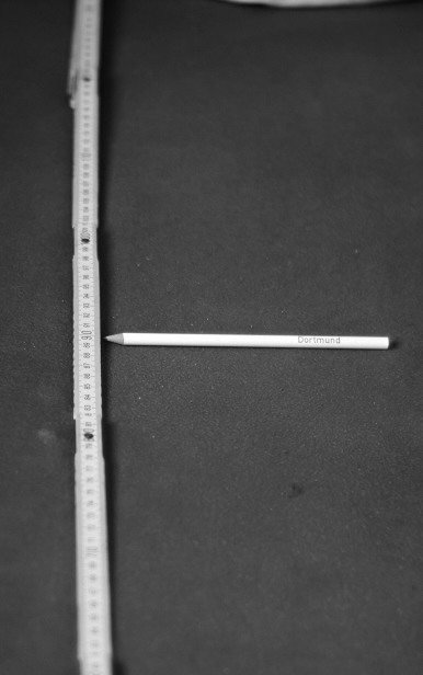

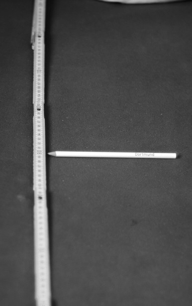

fabianoliver Posted April 4, 2020 Share #1 Posted April 4, 2020 (edited) Advertisement (gone after registration) Hello. This days i've bought a used, mint condition Nokton 40/1.4 MC. Nice lens for the price. The problem that i found is the focus shift. Here some examples with leica M8, focus at 0.9 mts. I've focused the 150 mark in the carpenter meter. At f1.4 and f2 is ok, at 2.8 it shift back Here some 100% crops. Later i'll made another test with far focus. Welcome, dear visitor! As registered member you'd see an image here… Simply register for free here – We are always happy to welcome new members! Edited April 4, 2020 by fabianoliver 1 Link to post Share on other sites Simply register for free here – We are always happy to welcome new members! ' data-webShareUrl='https://www.l-camera-forum.com/topic/308190-voigtlander-40-14-focus-shift/?do=findComment&comment=3946762'>More sharing options...

lct Posted April 4, 2020 Share #2 Posted April 4, 2020 Well-documented issue on rangefinders but not a problem on mirrorless of course. Link to post Share on other sites More sharing options...
fabianoliver Posted April 4, 2020 Author Share #3 Posted April 4, 2020 You are right ICT. This copy, or this lenses seem to be ok at 1.4 and 2, then...shift. On the 1.5 mt test, the focus shift back too, i'll take care on portraits, and not to focus the eye! Here 1.5 mt test Welcome, dear visitor! As registered member you'd see an image here… Simply register for free here – We are always happy to welcome new members! Link to post Share on other sites Simply register for free here – We are always happy to welcome new members! ' data-webShareUrl='https://www.l-camera-forum.com/topic/308190-voigtlander-40-14-focus-shift/?do=findComment&comment=3946802'>More sharing options...
BradS Posted April 5, 2020 Share #4 Posted April 5, 2020 This is horrible. Is it possible that this one needs to be calibrated or are the all like this? Link to post Share on other sites More sharing options...

mike3996 Posted April 6, 2020 Share #6 Posted April 6, 2020 (edited) On 4/5/2020 at 5:55 AM, BradS said: This is horrible. Is it possible that this one needs to be calibrated or are the all like this? All are like this. It is part of the optical design and the associated compromises. You don't want it, seek a model that doesn't exhibit the shift. Some people are persistent enough to learn to correct the focus error by hand but it's not everyone's idea of a good time. Edited April 6, 2020 by mike3996 2 Link to post Share on other sites More sharing options...

fotomas Posted April 7, 2020 Share #10 Posted April 7, 2020 Pretty much the same with mine. But it has on addition a back-focus with the OVF. The focus-distance is about 1,35 m. I just chose the 90 cm-mark because it was suitable and better to see. f 1,4 OVF Welcome, dear visitor! As registered member you'd see an image here… Simply register for free here – We are always happy to welcome new members! f 1,4 with EVF f 2,0 f 2,8 f 4,0 f 5,6 f 8,0 Wonder if the VC 1,2 / 40 mm might be better in this? 1 Link to post Share on other sites Simply register for free here – We are always happy to welcome new members! f 1,4 with EVF f 2,0 f 2,8 f 4,0 f 5,6 f 8,0 Wonder if the VC 1,2 / 40 mm might be better in this? ' data-webShareUrl='https://www.l-camera-forum.com/topic/308190-voigtlander-40-14-focus-shift/?do=findComment&comment=3949030'>More sharing options...
