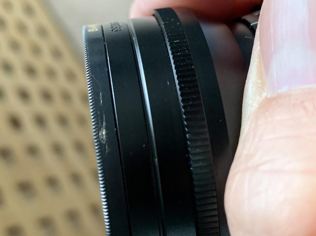

If the dilemma is in position like this you should bend the thread towards each other
Thanks guys. I already tried with pliers very lightly, so the filter is now slightly less bent. But it wasn’t that much out of shape before, that’s why I noticed only when trying to unscrew the filter!. In any case, I’m very careful with threading the filter in properly, if it doesn’t go in like butter I go back and restart, and never tighten it hard to avoid any binding!

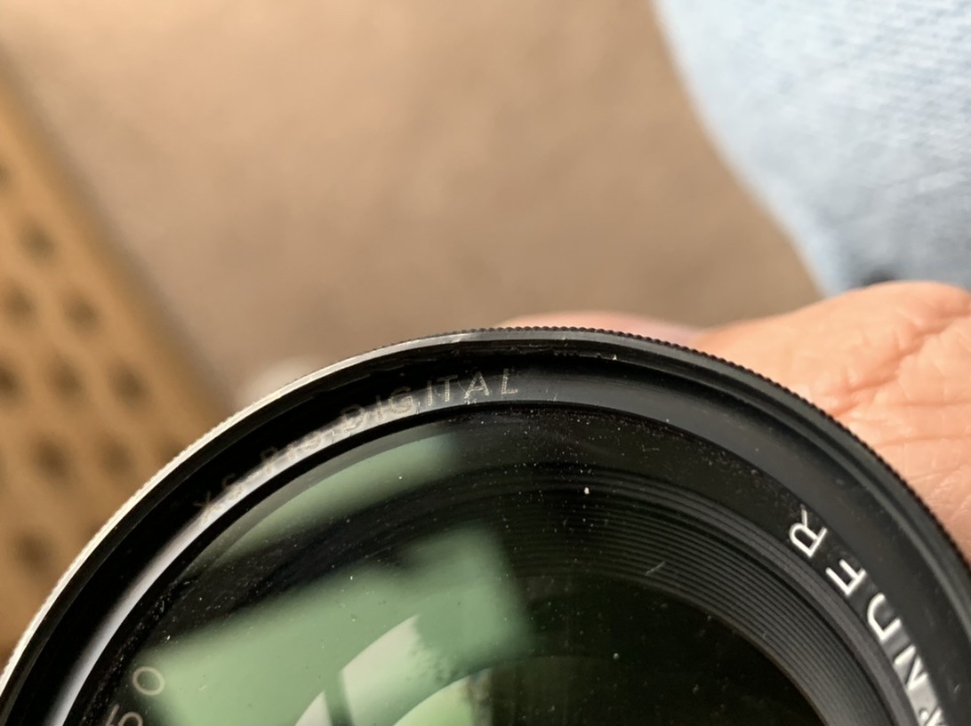

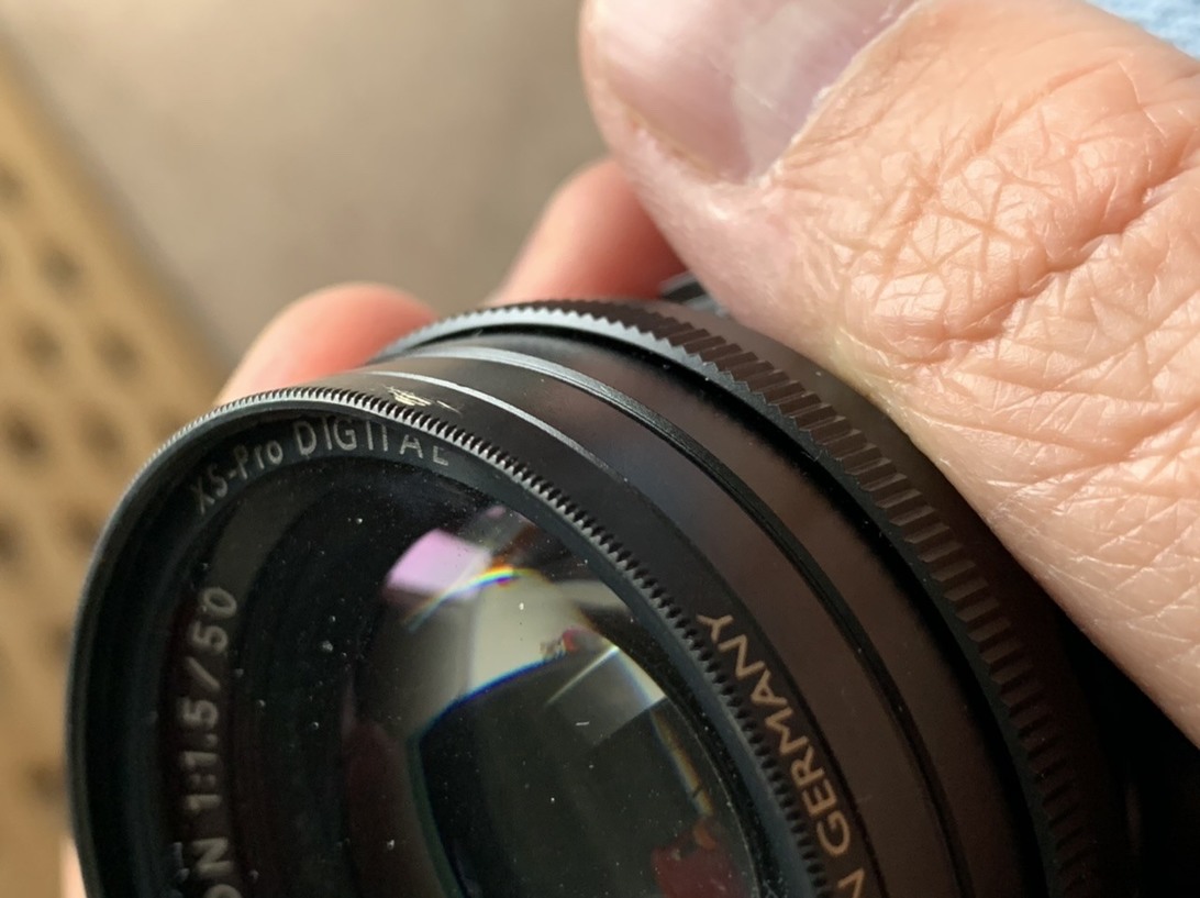

Here are a few pics attached.
Thanks for taking the time to draw that! But I do understand it well.
It's a minor ding. The tool I suggested at the beginning of the thread worked for me in a similar situation. And I was able to salvage the filter too.
I will definitely look into it then!
Success! I followed 250swb’s advice about not gripping too hard with the wrench, and used an elastic band around the lens front to stop it from sliding inside the other wrench - it moved with a bit of effort. It then unscrewed reasonably well, no damage at all to the lens thread. But I won’t be able to use the filter again I guess!
