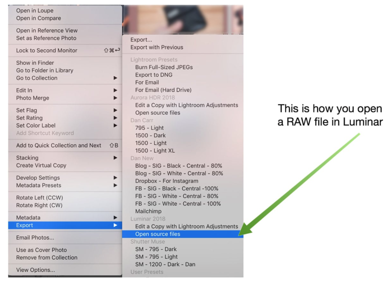

jaapv Posted December 3, 2019 Share #9 Posted December 3, 2019 I'm not a Luminar expert, nor do I have Q files to try it out, but try this: Welcome, dear visitor! As registered member you'd see an image here… Simply register for free here – We are always happy to welcome new members! 1 Link to post Share on other sites Simply register for free here – We are always happy to welcome new members! ' data-webShareUrl='https://www.l-camera-forum.com/topic/304079-help-my-dng-converted-jpeg-is-not-the-same-the-ooc-jpeg/?do=findComment&comment=3866464'>More sharing options...
LRookie Posted December 3, 2019 Author Share #10 Posted December 3, 2019 Just now, jaapv said: I'm not a Luminar expert, nor do I have Q files to try it out, but try this: Thanks you jaapv. Will try this and let you know how I go. Link to post Share on other sites More sharing options...
