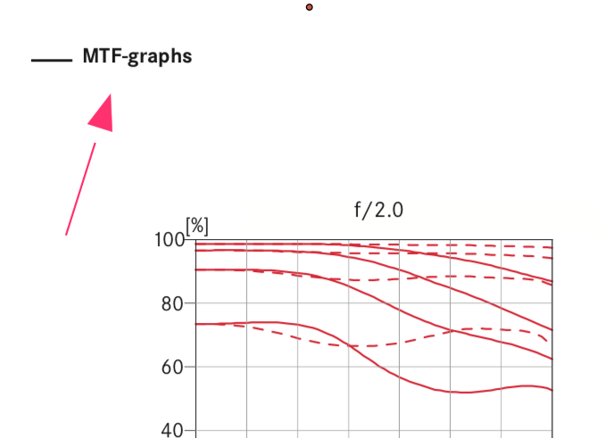

Leica doesn't even measure MTF curves, as they find that too imprecise.
Are you sure?
23 minutes ago, lct said:
Computed  MTF curves ...  simulation not measurement.
But do these calculations account for sensor cover glass and micro lenses ? for what camera ?
DXO's perceptual megapixels attempts to summarize a lens' merit with a single number that uses a lens-camera combination (which immediately defeats the purpose of talking about the lens as a thing unto itself) to measure sharpness (which is an image trait that is influenced by, but not determined by, the lens and camera system), weighted (in an unspecified manner) across the frame, weighted (in an unspecified manner) across apertures, and weighted (in an unspecified manner) across focal lengths. Measurements aren't meaningful to me unless they are reproducible, which these scores aren't based on published information. Measurements aren't meaningful to me unless they accurately represent some variable that I care about, and I cannot see a way of mapping a "perceptual megapixel" value to what I care about in how a lens-camera combination performs, even if I trusted the values in the first place. I can give DXO credit for trying to simplify a complex topic, but, in my mind, the complexity of the topic is where the meaningful information is. "Perceptual megapixels" is a lot like estimating how many calories were in someone's lunch without knowing anything about what they actually ate. It is merely a marketing tool -- pseudo information to make consumers feel like they are making an informed purchase without having to do the heavy lifting of informing themselves.
MTF graphs, whether measured or calculated, indicate the contrast level as a fraction of subject contrast of specific image frequencies in sagittal and tangential patterns drawn by the lens at specific distances from the image axis using a specific lens (ignoring the effect of the camera) at a specific focal length and aperture. This is in no way a score of merit. However, it suggests a lens' overall contrast, resolution, focus shift, focal plane curvature, and astigmatism at the nominal focal plane, all of which is useful information when applied against what I desire from a lens for a given purpose. Of course, MTF says nothing about what causes the reductions of contrast or what that looks like, and those matters are more important to final image quality than the MTF curves themselves. But I know what MTF curves tell me and so I can use that as meaningful information.
As far as I know, Leica used optical measurements of their lenses for MTF charts until their lenses were designed to have distortion correction applied in camera, at which point the optical corner resolution would be misleading, so they have since used calculated values for at least those lenses. But I don't have a cite for that.

Leica has been using computed MTF graphs for a long time. Puts mentions it in his Lens Compendium which predates digital photography. Another problem with MTF graphs is that they describe the plane of focus only, which means that they say absolutely nothing about the way a lens draws. A lens can have perfect MTF performance and absolutely horrible OOF rendering.
From Leica M-Lenses: Their soul and secrets, by Erwin Puts with technical support by Peter Karbe, dated September 2002 and published by Leica. Page 16:
Quote
How are MTF measurements actually obtained?
There are two methods: one method computes MTF data, the other method measures MTF values. Basically, there are no differences, and Leica uses either method, whichever is most appropriate: the optical design department computes the MTF values, and the manufacturing department uses an MTF-measuring instrument to obtain MTF data (see the diagrams).
I want to add that computed MTF data can indeed differ from measured MTF data if the computations do not take into account all aspects of optical transmission. I've seen MTF charts from other manufacturers that indicate a 100% contrast ratio, which is only sensible if they neglect a few of the more confounding aspects of optics -- which is fine for designers in their process of optimization, but which does not reflect the total, real-world performance of a lens as do Leica's graphs. I have seen nothing to make me doubt that Leica (or Zeiss) publish anything other than realistic MTF charts, even when the charts are computed rather than measured.
