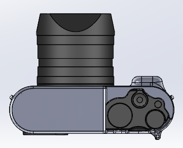

syam Posted August 6, 2019 Author Share #4 Posted August 6, 2019 (edited) Thanks for the tips! Current progress on revision 1 of the top and bottom shells. Welcome, dear visitor! As registered member you'd see an image here… Simply register for free here – We are always happy to welcome new members! A couple of features I've designed into the case so far: 1. Protection on all sides and corners 2. Battery Door Access 3. Peak Design Plate Mount 4. Front finger grip 5. Rear thumb grip 6. Diopter Adjuster Block-off 7. Power Switch Block to stop it at S (preventing switching into C since I never use continuous mode) The plan now is to 3D print the 2 part case and test the ergonomics and tolerances of the parts. Will also be lining the inside with a soft thin material to avoid scratching. Please keep the comments and feedback coming. Thanks. Edited August 6, 2019 by syam adding pictures and text 1 Link to post Share on other sites Simply register for free here – We are always happy to welcome new members! A couple of features I've designed into the case so far: 1. Protection on all sides and corners 2. Battery Door Access 3. Peak Design Plate Mount 4. Front finger grip 5. Rear thumb grip 6. Diopter Adjuster Block-off 7. Power Switch Block to stop it at S (preventing switching into C since I never use continuous mode) The plan now is to 3D print the 2 part case and test the ergonomics and tolerances of the parts. Will also be lining the inside with a soft thin material to avoid scratching. Please keep the comments and feedback coming. Thanks. ' data-webShareUrl='https://www.l-camera-forum.com/topic/299948-my-first-leica-q-designing-a-case/?do=findComment&comment=3792213'>More sharing options...

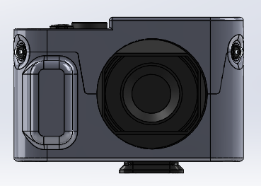

syam Posted August 6, 2019 Author Share #5 Posted August 6, 2019 Add 2 more 3D views. Enjoy! Welcome, dear visitor! As registered member you'd see an image here… Simply register for free here – We are always happy to welcome new members! 1 Link to post Share on other sites Simply register for free here – We are always happy to welcome new members! ' data-webShareUrl='https://www.l-camera-forum.com/topic/299948-my-first-leica-q-designing-a-case/?do=findComment&comment=3792219'>More sharing options...
LexS Posted August 6, 2019 Share #6 Posted August 6, 2019 - more space around the Thumbs button, impossible to use as designed now. - rear thumbs grip unnecessary: grip enhanced by the case already. - create a "stop" between the main switch single shot and continuous. Link to post Share on other sites More sharing options...
Matsaly Posted August 6, 2019 Share #7 Posted August 6, 2019 Advertisement (gone after registration) 10 hours ago, syam said: Thanks for the tips! Current progress on revision 1 of the top and bottom shells. Welcome, dear visitor! As registered member you'd see an image here… Simply register for free here – We are always happy to welcome new members! A couple of features I've designed into the case so far: 6. Diopter Adjuster Block-off 7. Power Switch Block to stop it at S (preventing switching into C since I never use continuous mode) Interesting design concept. Can you elaborate on what you mean on "6. Diopter Adjuster Block-off." Re 7. Power switch block. Not sure users want to have C mode blocked off. While I rarely use C mode, I still want occasional access to it. On my Q-P I managed to wedge a small diameter "O ring" underneath the shutter release which provides enough resistance to avoid inadvertently selecting C mode but still allows one to choose C mode if desired. Would silicone or a "grippy" rubbery material be an option for your design? Just an idea. Link to post Share on other sites More sharing options...
syam Posted August 8, 2019 Author Share #8 Posted August 8, 2019 On 8/6/2019 at 3:55 AM, LexS said: - more space around the Thumbs button, impossible to use as designed now. - rear thumbs grip unnecessary: grip enhanced by the case already. - create a "stop" between the main switch single shot and continuous. - After 3D printing the case yesterday, I found that the buttons need more space to comfortably press, so I"ll be changing the geometry around the buttons to have a more flush cutout. - I'm really liking the rear thumb grip addition on the case. The combo with the front grip really makes the thing solid to hold, but this can easily be removed too. - I designed in a stop to block off the continuous mode completely since I never use it and it works ok. Could be better for the next version On 8/6/2019 at 12:32 PM, Matsaly said: Interesting design concept. Can you elaborate on what you mean on "6. Diopter Adjuster Block-off." Re 7. Power switch block. Not sure users want to have C mode blocked off. While I rarely use C mode, I still want occasional access to it. On my Q-P I managed to wedge a small diameter "O ring" underneath the shutter release which provides enough resistance to avoid inadvertently selecting C mode but still allows one to choose C mode if desired. Would silicone or a "grippy" rubbery material be an option for your design? Just an idea. - For the diopter, I just simply put some case material around the diopter so nothing can bump into the dial and change the focus - I've been trying to rethink blocking off continuous shooting mode. Not sure if i'll keep the block off or not, but I really haven't had a problem with turning it to continuous by accident. I usually just leave it in single shot mode and wake the camera with a shutter press given the new aggressive power saving mode has been pretty frugal. - The exterior surface could have a soft-touch type paint, or specific sections with molded in rubber grips. That is an option but a more complex one of course. Some shots of the 3D prints for now until I get some time to redesign the problem areas: Welcome, dear visitor! As registered member you'd see an image here… Simply register for free here – We are always happy to welcome new members! Link to post Share on other sites Simply register for free here – We are always happy to welcome new members! ' data-webShareUrl='https://www.l-camera-forum.com/topic/299948-my-first-leica-q-designing-a-case/?do=findComment&comment=3793414'>More sharing options...

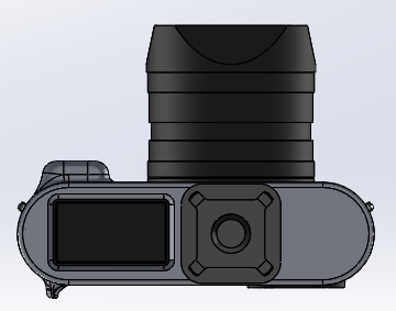

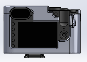

syam Posted August 8, 2019 Author Share #9 Posted August 8, 2019 Welcome, dear visitor! As registered member you'd see an image here… Simply register for free here – We are always happy to welcome new members! Top control area detail shows the continuous mode block off feature. Bottom picture shows battery door access and peak design mounting plate cutout. Any other input would be appreciated! Link to post Share on other sites Simply register for free here – We are always happy to welcome new members! Top control area detail shows the continuous mode block off feature. Bottom picture shows battery door access and peak design mounting plate cutout. Any other input would be appreciated! ' data-webShareUrl='https://www.l-camera-forum.com/topic/299948-my-first-leica-q-designing-a-case/?do=findComment&comment=3793416'>More sharing options...
syam Posted August 8, 2019 Author Share #10 Posted August 8, 2019 Welcome, dear visitor! As registered member you'd see an image here… Simply register for free here – We are always happy to welcome new members! - Added recessed cutouts around all the buttons and d-pad - Increased the size of the rear thumb grip and moved it closer to the thumb cutout - Simplified the top control cutout area - Added cutouts for magnetic mating between the top and bottom halves Going to try using the previously printed case for a few days and see where the design can improve, then print out another shell to further refine. Cheers! Link to post Share on other sites Simply register for free here – We are always happy to welcome new members! - Added recessed cutouts around all the buttons and d-pad - Increased the size of the rear thumb grip and moved it closer to the thumb cutout - Simplified the top control cutout area - Added cutouts for magnetic mating between the top and bottom halves Going to try using the previously printed case for a few days and see where the design can improve, then print out another shell to further refine. Cheers! ' data-webShareUrl='https://www.l-camera-forum.com/topic/299948-my-first-leica-q-designing-a-case/?do=findComment&comment=3793451'>More sharing options...
