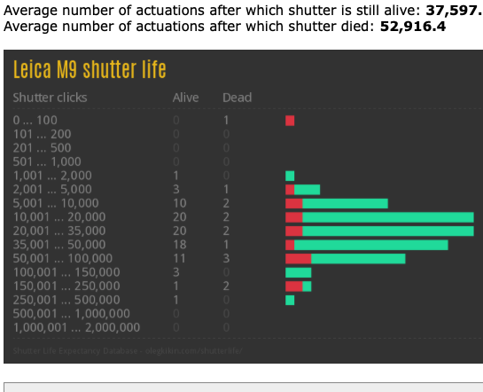

FredGP Posted October 17, 2023 Share #42 Â Posted October 17, 2023 Just in case someone (like me) should land here and wonder:Â https://www.olegkikin.com/shutterlife/leica_m9.htm Link to post Share on other sites More sharing options...
jaapv Posted October 17, 2023 Share #43  Posted October 17, 2023 After four years ... 🙄 Unfortunately a biased survey. More owners with a failed shutter will respond than those with non-problematic shutters. Link to post Share on other sites More sharing options...
wattsy Posted October 17, 2023 Share #44  Posted October 17, 2023 (edited) 16 minutes ago, jaapv said: Unfortunately a biased survey. More owners with a failed shutter will respond than those with non-problematic shutters. You might like to think that but that's not what the graph shows. The vast majority of the results report the shutter still working. In any case, even if the survey was limited to only those who experienced a failed shutter, the survey would still tell you something about the number of clicks at which failed shutters might likely suffer a failure.  Welcome, dear visitor! As registered member you'd see an image here… Simply register for free here – We are always happy to welcome new members! Edited October 17, 2023 by wattsy Link to post Share on other sites Simply register for free here – We are always happy to welcome new members! ' data-webShareUrl='https://www.l-camera-forum.com/topic/299868-m9-shutter-life-expectancy/?do=findComment&comment=4876722'>More sharing options...
jaapv Posted October 17, 2023 Share #45  Posted October 17, 2023 14 minutes ago, wattsy said: You might like to think that but that's not what the graph shows. The vast majority of the results report the shutter still working. In any case, even if the survey was limited to only those who experienced a failed shutter, the survey would still tell you something about the number of clicks at which failed shutters might likely suffer a failure.  Welcome, dear visitor! As registered member you'd see an image here… Simply register for free here – We are always happy to welcome new members! That only suggests that the number of working shutters is far higher. But an uncontrolled poll based on user reports instead of a survey of a representative owner group is sure to have a bias towards the failed shutters. 1 Link to post Share on other sites More sharing options...
wattsy Posted October 17, 2023 Share #46 Â Posted October 17, 2023 9 minutes ago, jaapv said: That only suggests that the number of working shutters is far higher. But an uncontrolled poll based on user reports instead of a survey of a representative owner group is sure to have a bias towards the failed shutters. Whatever. 1 Link to post Share on other sites More sharing options...
jaapv Posted October 17, 2023 Share #47  Posted October 17, 2023 Advertisement (gone after registration) The other problem is that the failure cause is not reported. How many shutters failed through outside mechanical failure, like a grain of sand or touching it during cleaning, etc., for instance? I am not aware of any report of a shutter failing through wear. At any rate the shutters are made by either Copal or Seiko, like most if not all other camera brands. I think Leica uses Copal but am not sure. So there will be little variation in shutter reliability between cameras. If any should emerge it will only show that the shutter makers apply different levels of tolerance in their production process. Link to post Share on other sites More sharing options...
ianman Posted October 17, 2023 Share #48  Posted October 17, 2023 How did they arrive at a .4? 🤔 ... in any case that survey is hardly representative one way or another as only about 100 people responded and probably many years ago. Link to post Share on other sites More sharing options...

Anbaric Posted June 4, 2024 Share #56 Â Posted June 4, 2024 On 10/17/2023 at 10:05 AM, jaapv said: That only suggests that the number of working shutters is far higher. But an uncontrolled poll based on user reports instead of a survey of a representative owner group is sure to have a bias towards the failed shutters. Yes, it seems pretty pointless to gather data in this way, and silly to do survival analysis on a data set with such an obvious potential source of bias. I mean, we just have to think about how the users found out about the shutterlife site in the first place. It's not hard to imagine that people with shutter problems are much more likely to do a search that will lead them there, so faulty cameras will tend to be overrepresented in the data (we have no idea by how much). Link to post Share on other sites More sharing options...
