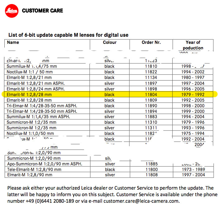

ramarren Posted July 11, 2019 Share #4  Posted July 11, 2019 Hmm. I sent my Summilux 35 v2 to DAG and asked him to code it. He machined the lens mount flange and painted in the code. I guess Leica just doesn't do that sort of thing. 1 Link to post Share on other sites More sharing options...
adan Posted July 11, 2019 Share #5  Posted July 11, 2019 Lest there be confusion, the 28mm v.3 (11804) has normally been supported by Leica for 6-bit coding. (Unlike the 35 lux non-ASPH, which never had the modern thin flange required) Doesn't require special machining - simply swapping in a current mount/flange and painting the B/W pits as needed. Welcome, dear visitor! As registered member you'd see an image here… Simply register for free here – We are always happy to welcome new members! But..... - the generous interpretation - Leica can't repair the separated element, and doesn't want to even touch the lens with a screw-driver lest they be held reponsible. - the less generous version - Leica regrets that commitment they made back in 2006, and is looking for any excuse to drive older-lens users to buy new APO/ASPH goodies, and cut back on the service/support they need to maintain for 40-year-old lenses (or even newer R lenses, to jaap's point). I can test that theory - I have an uncoded 75 Summilux (also listed as supported) that, while working fine, would benefit from a CLA as well (focus ring is just microscopically wiggly). I'll send that in, and if I get the "sorry, no parts" excuse on that also, I'll know what they're really up to. But thanks for the DAG tip. Will use if needed in either case. Link to post Share on other sites Simply register for free here – We are always happy to welcome new members! But..... - the generous interpretation - Leica can't repair the separated element, and doesn't want to even touch the lens with a screw-driver lest they be held reponsible. - the less generous version - Leica regrets that commitment they made back in 2006, and is looking for any excuse to drive older-lens users to buy new APO/ASPH goodies, and cut back on the service/support they need to maintain for 40-year-old lenses (or even newer R lenses, to jaap's point). I can test that theory - I have an uncoded 75 Summilux (also listed as supported) that, while working fine, would benefit from a CLA as well (focus ring is just microscopically wiggly). I'll send that in, and if I get the "sorry, no parts" excuse on that also, I'll know what they're really up to. But thanks for the DAG tip. Will use if needed in either case. ' data-webShareUrl='https://www.l-camera-forum.com/topic/298942-here-we-go-again/?do=findComment&comment=3776432'>More sharing options...
